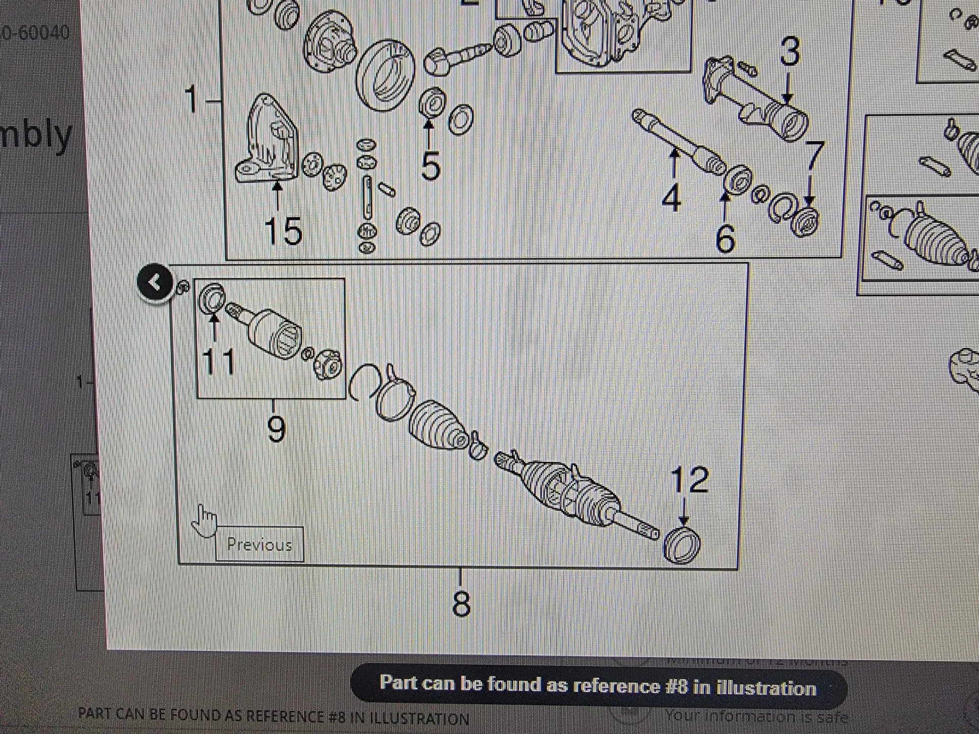

I had the dealer on the phone and they can't find a part number for this seal that is part of the CV shaft assembly.
You can see it pictured in the diagram on the dealer website, but they don't have a listing of other part numbers corresponding to the numbered items in the diagram.
The diagram is from the axle shaft itself: 43430-60040
I need the part number for item number 12. It seems to commonly be included on CV axle replacement assemblies. Previous owner included a spare CV axle, boots were leaking on the passenger side, so I thought I would swap the spare cv axle. Now I see that I am missing this seal on the replacement CV axle the previous owner left with me.

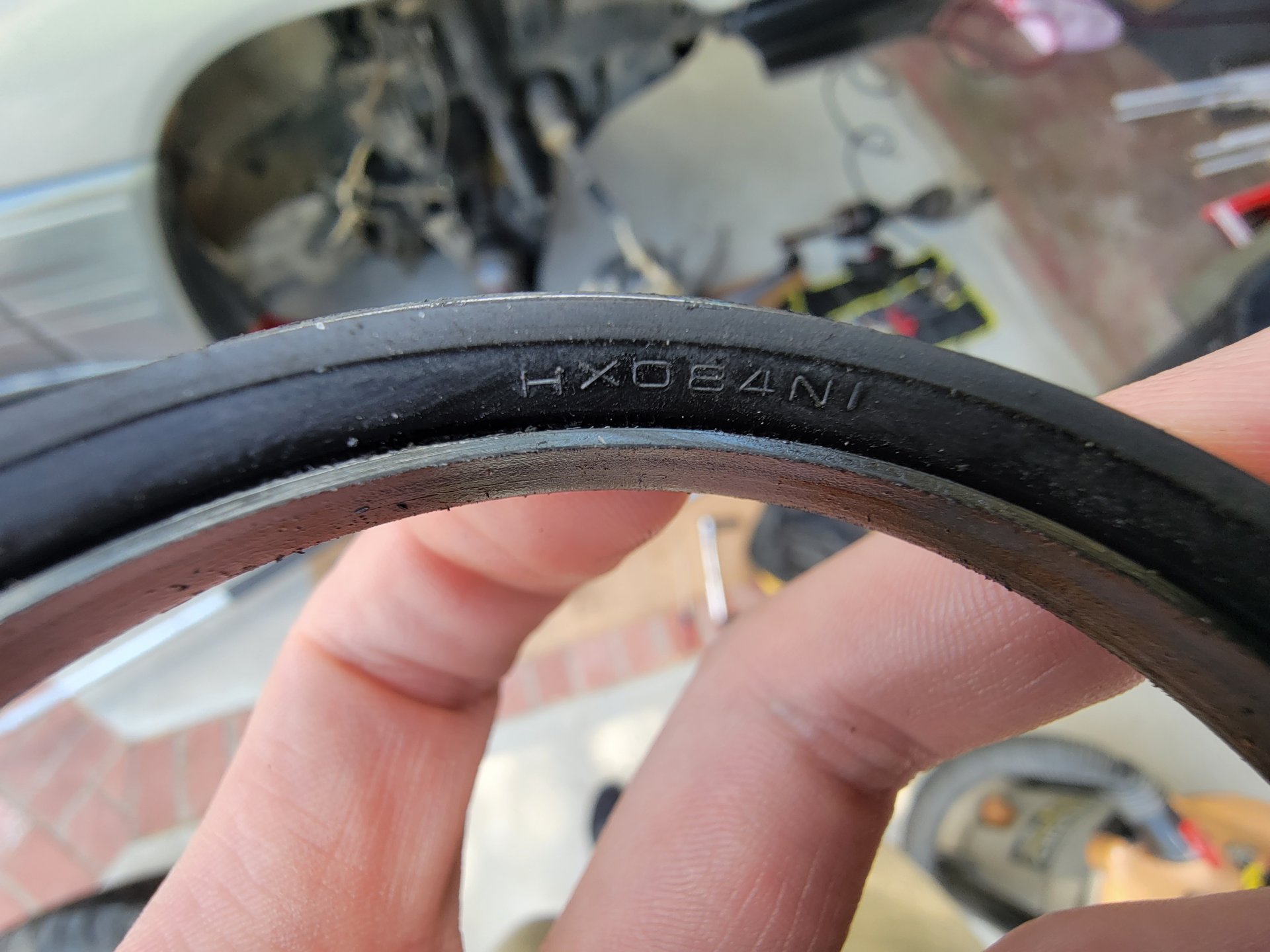

I did find these markings on the shield
It's Koyo brand. With HXO84NI or HX084NI

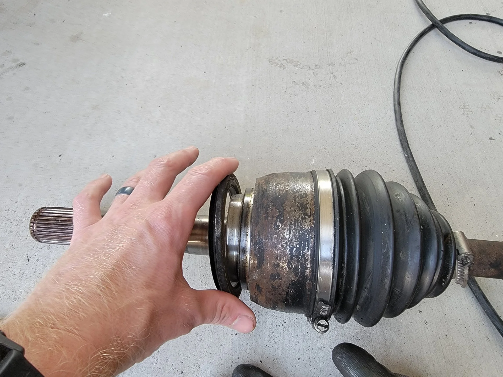

I don't NEED the new shield, I was able to tap it onto my spare axle, but it would be nice to have a complete spare for swapping out without having to transfer over this shield (that at some point could become damaged. (I did tap it onto the spare, and all seems well)

I can confirm that PN: 90304-83002 is the correct part to replace dust shield! I plugged in the PN into my local toyota dealer's website. They emailed asking for a VIN, I told them I have an LX and the VIN won't work. Even if I did give them the VIN, I think their system would have said the part won't work, because the online system was telling me the part wasn't compatible with an 03 LC.
I told them to just order the part. They did, it took about a week. I picked up the part today in-person. I should have ordered a boot kit while I was at it, but at least I have the dust shield when it comes time to re-boot.
PN: 90304-83002
The part number noted earlier is the correct part number for the dust seal (90304-83002)

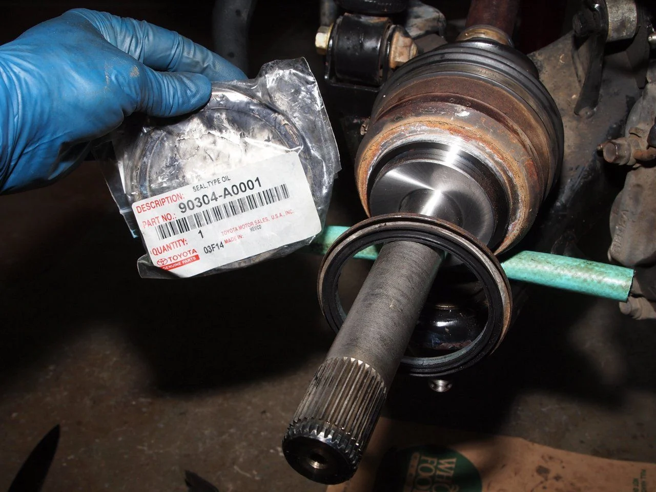

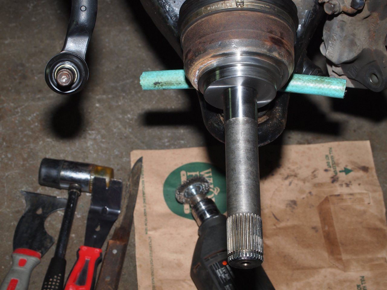

Outer lip of my front drive shaft (CV) outboard dust seal was damaged, so I replaced it. My Toyota Dealer's no longer had a part number for outboard joint shaft (tulip) or dust seal. I used a dust seal # 90304-A0001.
I applied marine grease after cleaning-up where seal buts to shaft.
