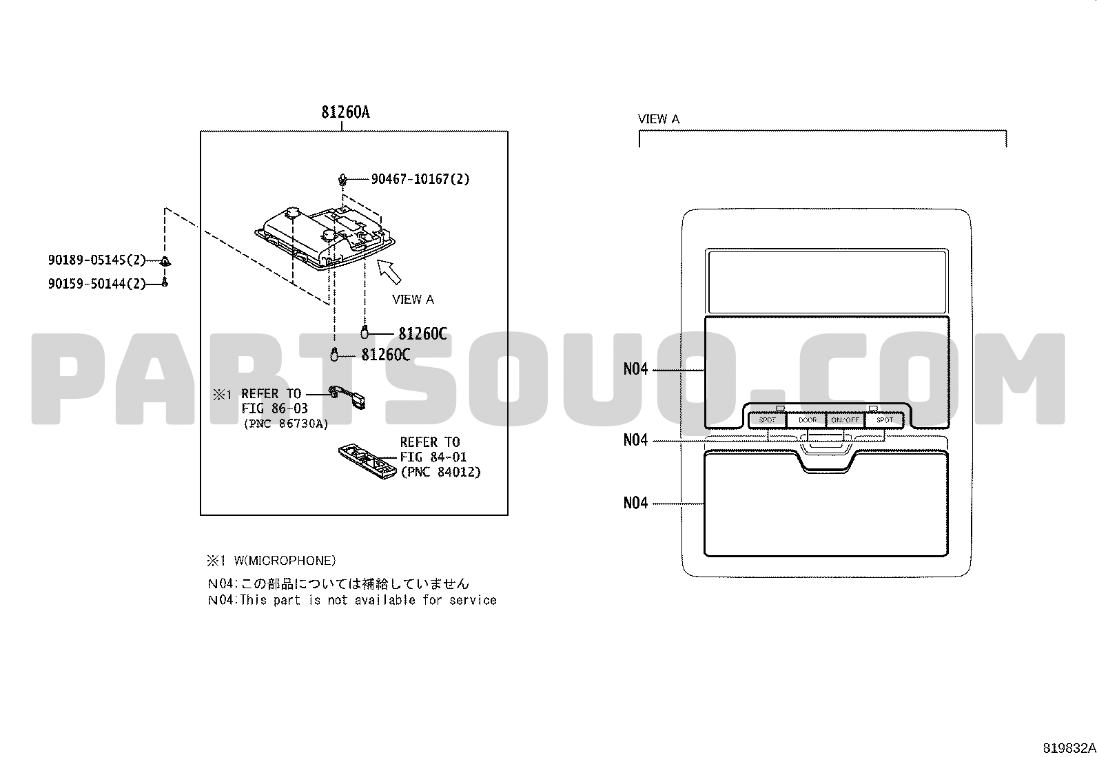

All - looking for the Toyota part number of the clear one piece plastic cover / lens that covers the front map light in my 2015 200. Broke mine yesterday and, after an hour looking , no luck on finding the part number for specific part.

Doesn't look good, the part you are looking for is labeled NO4 and the note says "This part is not available for service".
Here's the link to the PartsOuq page.

Nice - so i can get a random replacement washer number but no for the plastic lens? Bummer..
Yikes. I only see the whole assembly available.. for $600+
Sounds like the fix is a small piece of clear packing tape. Bummer. The little clips on the lens are so brittle they break when simply removing to change a bulb. Can’t believe there isn’t a replacement when there is for every other interior light.
