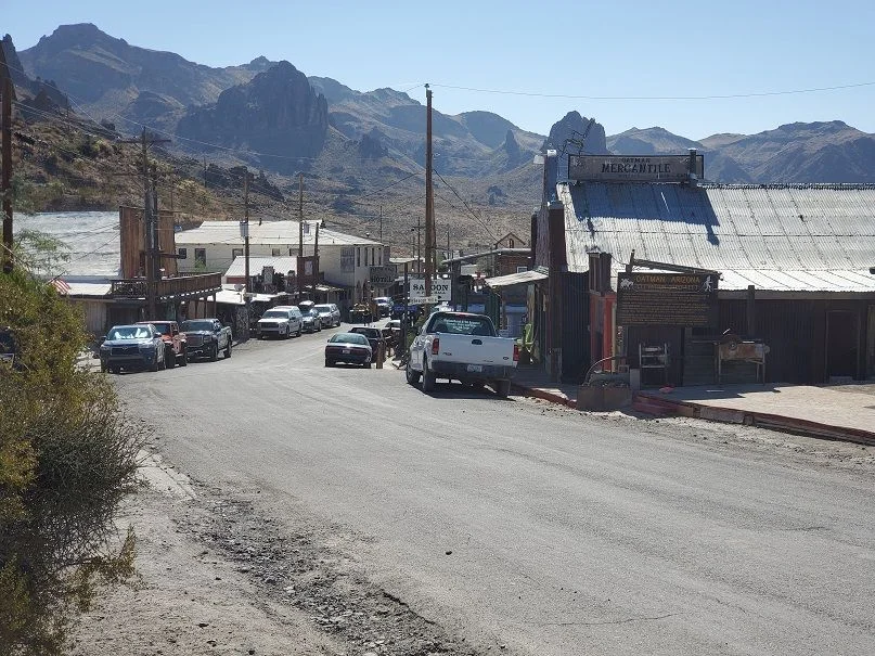

Oatman. I came. I saw. I photographed. I got the hell out of town pointed for home.
