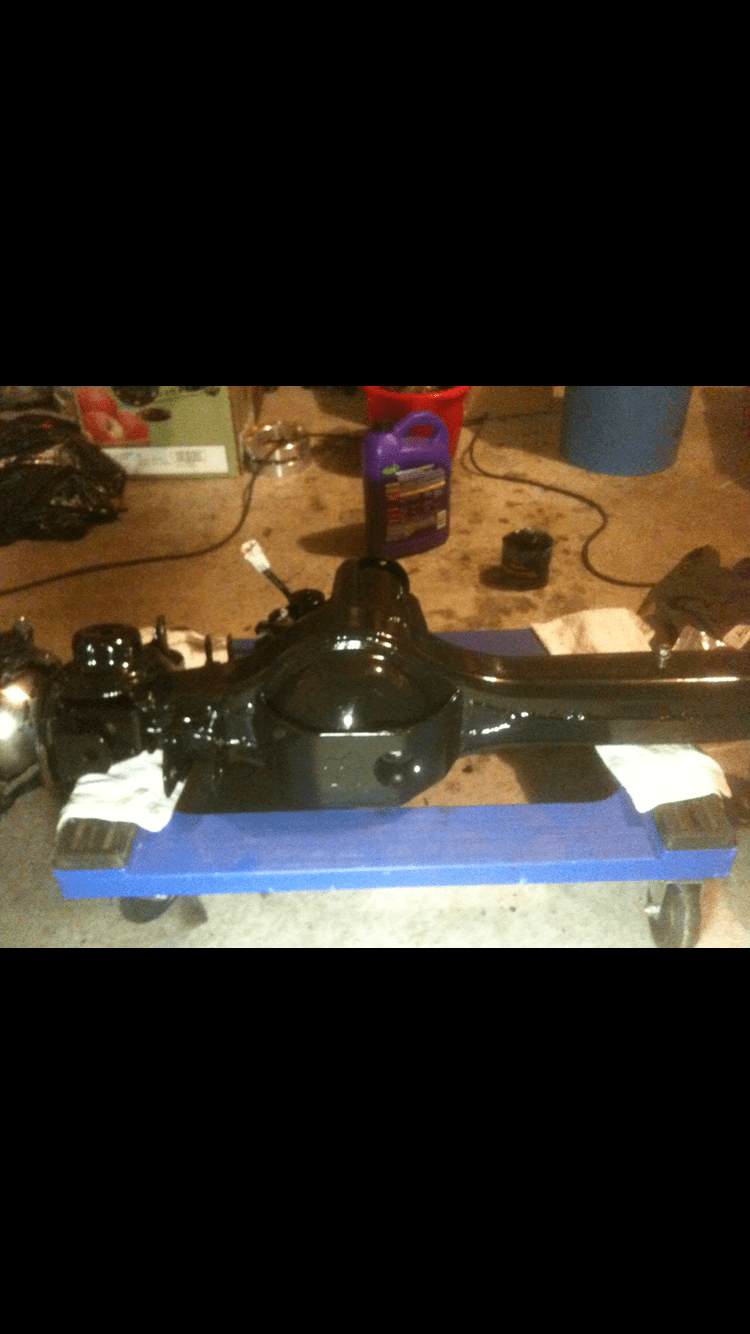

I used Rust-Oleum gloss black and a Harbor Freight air sprayer for my undercarriage refresh. As with any paint project, surface prep is critical. Mine is a no-rust Arizona rig, so that was a huge advantage. I spent quality time with a pressure washer (careful around electrical connectors) and then took it to a detailer with a steam cleaner and a lift rack. It has held up very well and I can touch up with a rattle can.
