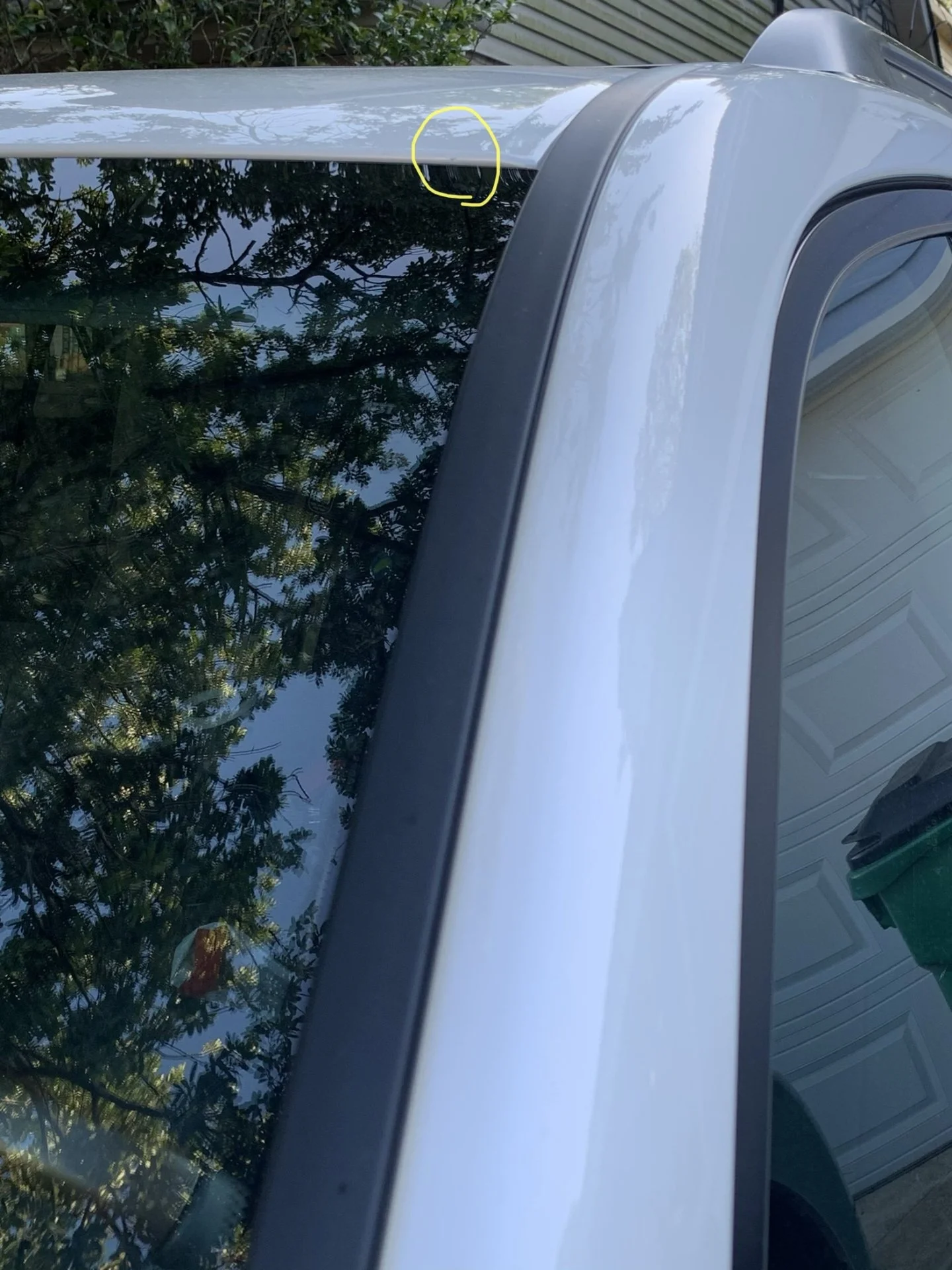

I noticed this paint crack within the first 2-3 weeks of picking up my ‘21 LC. Maybe an 1/8” long, through the paint, and possible surface rust in the crack. Being that it’s so small and thin, it’s hard to examine. I can’t imagine that I picked it up in the first couple hundred miles. I’ve never had bare metal exposed on a car, much less, a brand new LC.

The problem I’ve seen is that if you don’t get to clean metal, painting just delays the inevitable. It doesn’t stop rusting just because it gets painted over.
Where is that picture taken? Is that the rear window? That’s the only place I see glass edge on my 2015. Is the pic upside down? What is the texture black line?
If that is the top of the windshield you could very well just be unlucky. Any forward facing painted edge can have this happen.
I'd go get the correct toyota touch up paint then bring that to a good auto body shop. They may need to open it up a bit to get to the rust at the root but if they know what they are doing you won't be able to tell when they are done.
Where on the vehicle is this?
#3. Dremel it out, clean and prep the area, then cover with touch up paint. Half :banana: job.

It is just above the windshield. I’ve circled here:
It is really small. But plan to keep my LC until my wife makes me sell it, so don’t want any rust.

Some high end detail shops are wizards with touch ups too.. might be worth asking them, and especially, seeing if they have pictures of their work.
^^^ True they use artists type sprayers for small areas. Paint that new should be an easy match.
Not terribly expensive and a much better job than DIY.
Looks like some goo?? Try some goo b gone. I'd order a Dr.color chip small kit. You will need for future chips as Toyota paint systems are very prone to road chips. The kits are very simple to use.

Is the paint cracking or is it a scratch or chip? The better touch-up pens include paint, clear coat, and have an abrasive tip on one end that is used like a pencil eraser to smooth out the defect and remove any oxidation. If it's a scratch or chip that's the route I would go.
