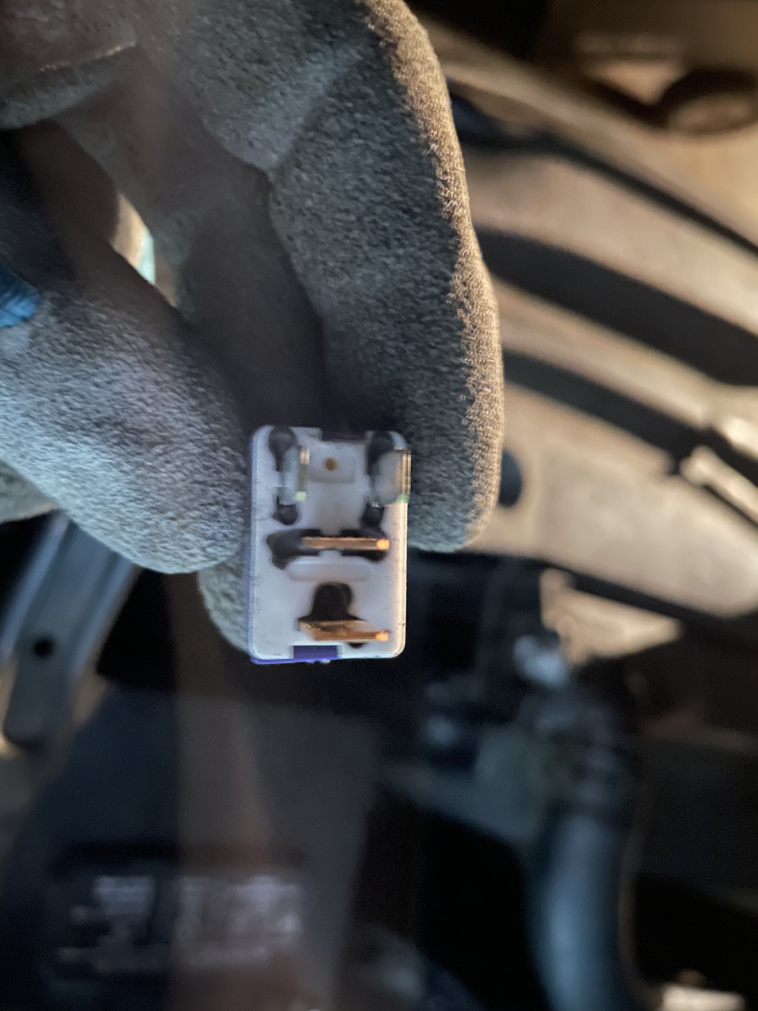

Some points for awareness, I replaced the starter solenoid in this timeframe and I previously installed the Hewitt SAIS bypass.
Did I hose my starter relay when I installed the bypass?
Edit: I found several images of the starter relay with the same colors/patterns. It did not look natural to me and more like I burned it up.
Christmas tree this morning, multiple misfires and 1 though 8 codes set.

Sorry I missed all these posts. Do other relays in the same box have similar carbon patterns? Almost looks as though something in the bottom half of the box got smoked and that’s just where the relay was uncovered to leave deposits.
