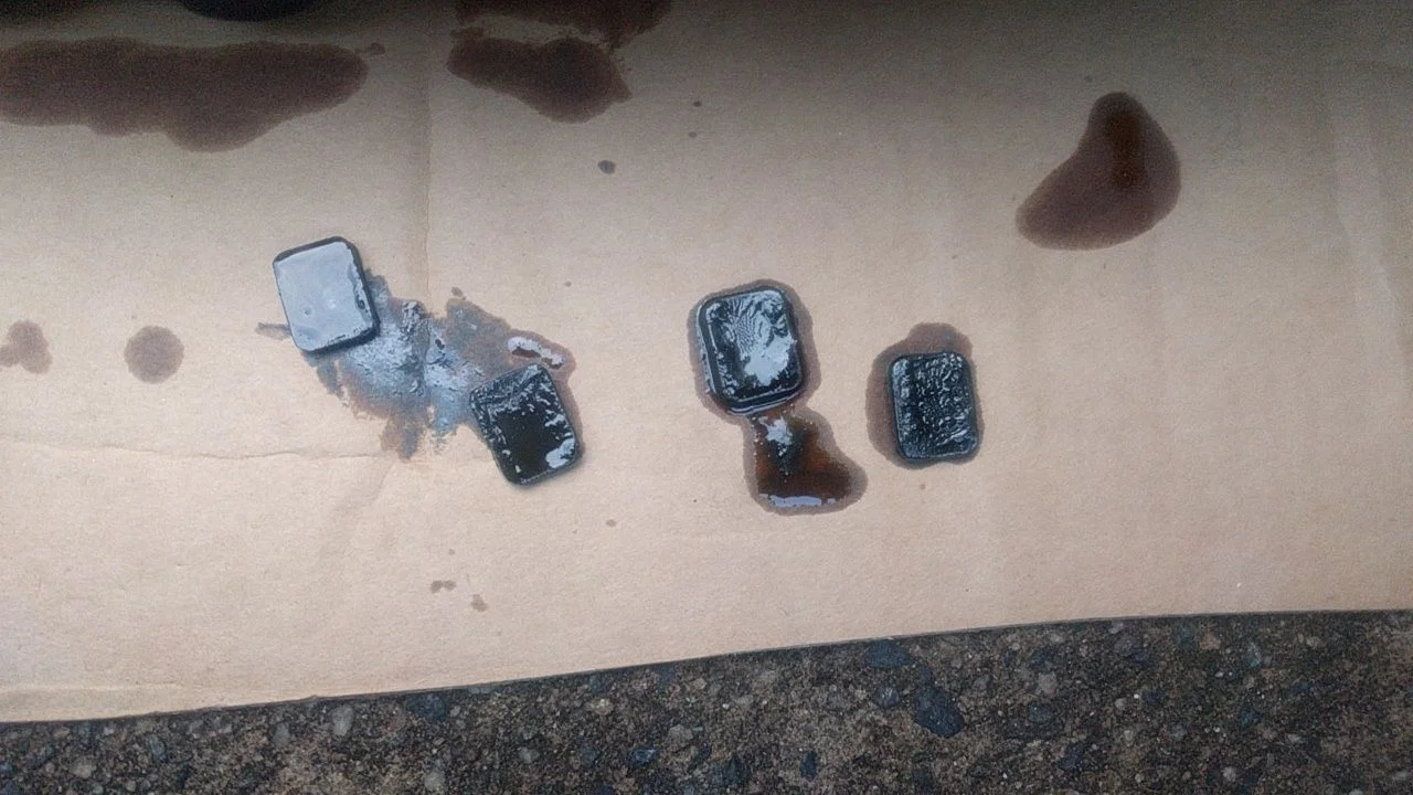

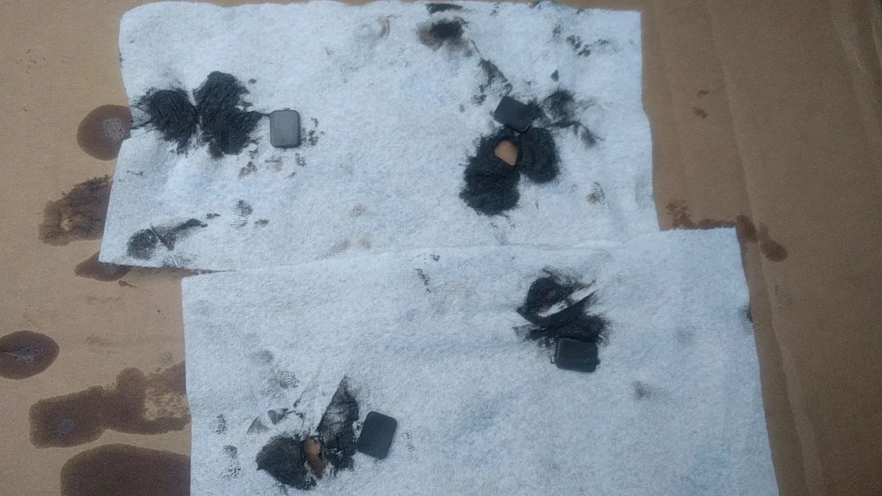

Level was good, but I did a quick drain and refill. We have not been driving much, CEL popped up again this morning.

Charging the battery was wishful thinking. The error came back up. I took it to a recommended transmission shop. He stated he pulled additional codes indicating at least two solenoid failures. This leads him to believe there may be contamination from the torque converter failing.
