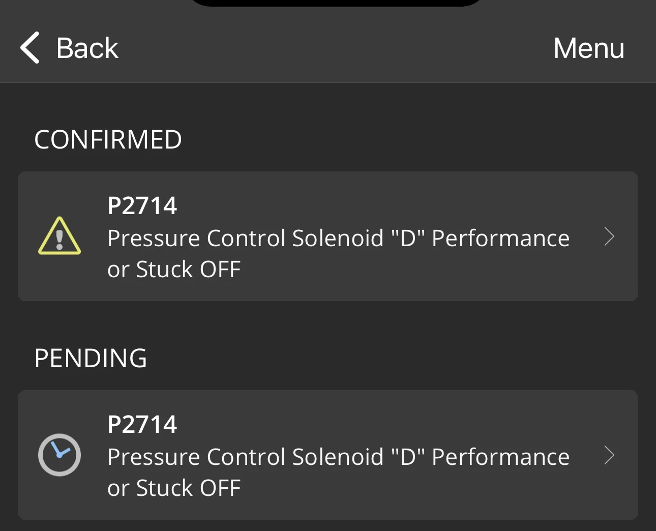

I just experienced this morning, 2006 LX, last fluid service was 30k miles 6 years ago full fluid exchange and new transmission pan gasket, AT trans pan temp was 119°F, torque converter temp was 125°F, it just limped, no CEL. I braked hard on a stoplight and when it was time for me to go it wouldn’t accelerate as it normally does. Pulled over and ran my diagnostics using my OBD Fusion WiFi app;
Turned off the engine completely, ignition on (engine off) and cleared the errors, turned it off completely again key out, then and fired up the engine and limp mode as well the the error was gone. Interesting to experience this as I am scheduled to do a full fluid exchange again in 1-2 weeks.

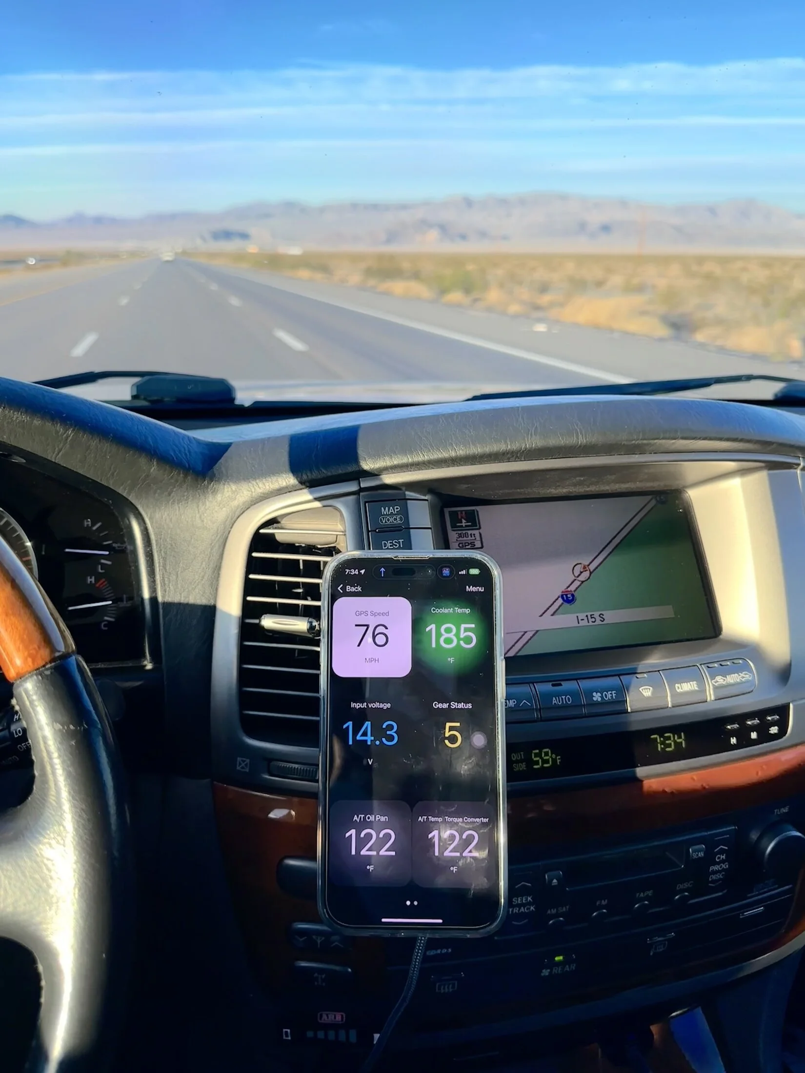

I use a realtime monitoring system / diag tool on my phone called OBD Fusion that is connected thru WiFi to an OBD dongle plugged in, here is the interface.
My bad, I actually cleared that P2714 error code that came up and that fixed the limp mode.

I'm just curious about the torque converter temperature; I wasn't aware the A750F had a sensor there.
Yup 12 quarts of ATF WS but used more than that when I did a fluid exchange, around 16 qts if I remember it right. And yes OBD Fusion app read 119°F at the pan and 125°F at the torque converter. I will get a better measurement of the fluid when I drain the pan AT soon.
Look for A/T #1 and A/T #2 on your app. See if they read the same as your "pan" & "TC".

They don’t read the same, the AT#2 sensor (which I renamed to Torque Converter) always read higher temps. Yeah will definitely measure up the AT fluid when I drain it.
Yeah, A/T #1 reads lower than #2. A/T #2 also, raises faster when loading A/T (in D, 4, 3, 2, 1. brake held, raise RPM) and shifting through (~5> seconds in each) all gears.
