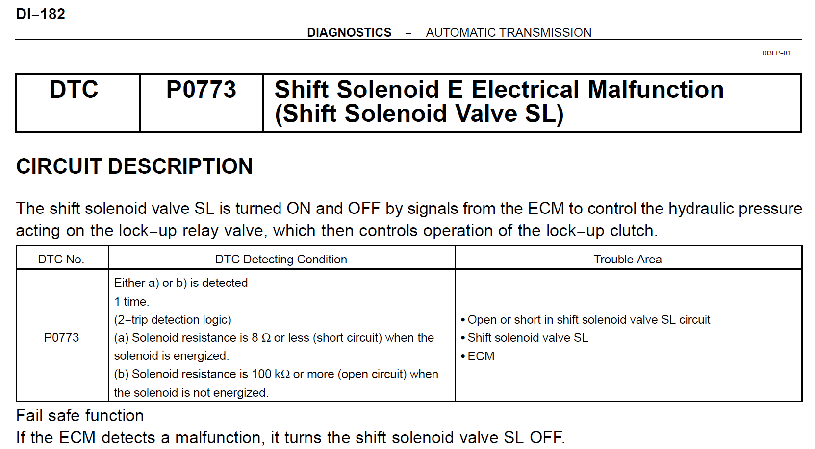

The diagnostic and repair procedures are in the FSM. The attachment is from the 2000 LX470 manual, but would apply to all 1998-2002 models.
The first step is to verify the ECM is good. If that checks out, the next step is to drop the oil pan and check both the solenoid valve (Solenoid E is the lock up solenoid) and the pigtail. There is no need to drop the entire transmission, just the pan. The procedure for this is also in the FSM. There are copies for both the Land Cruiser and LX470 in the Resources section.
