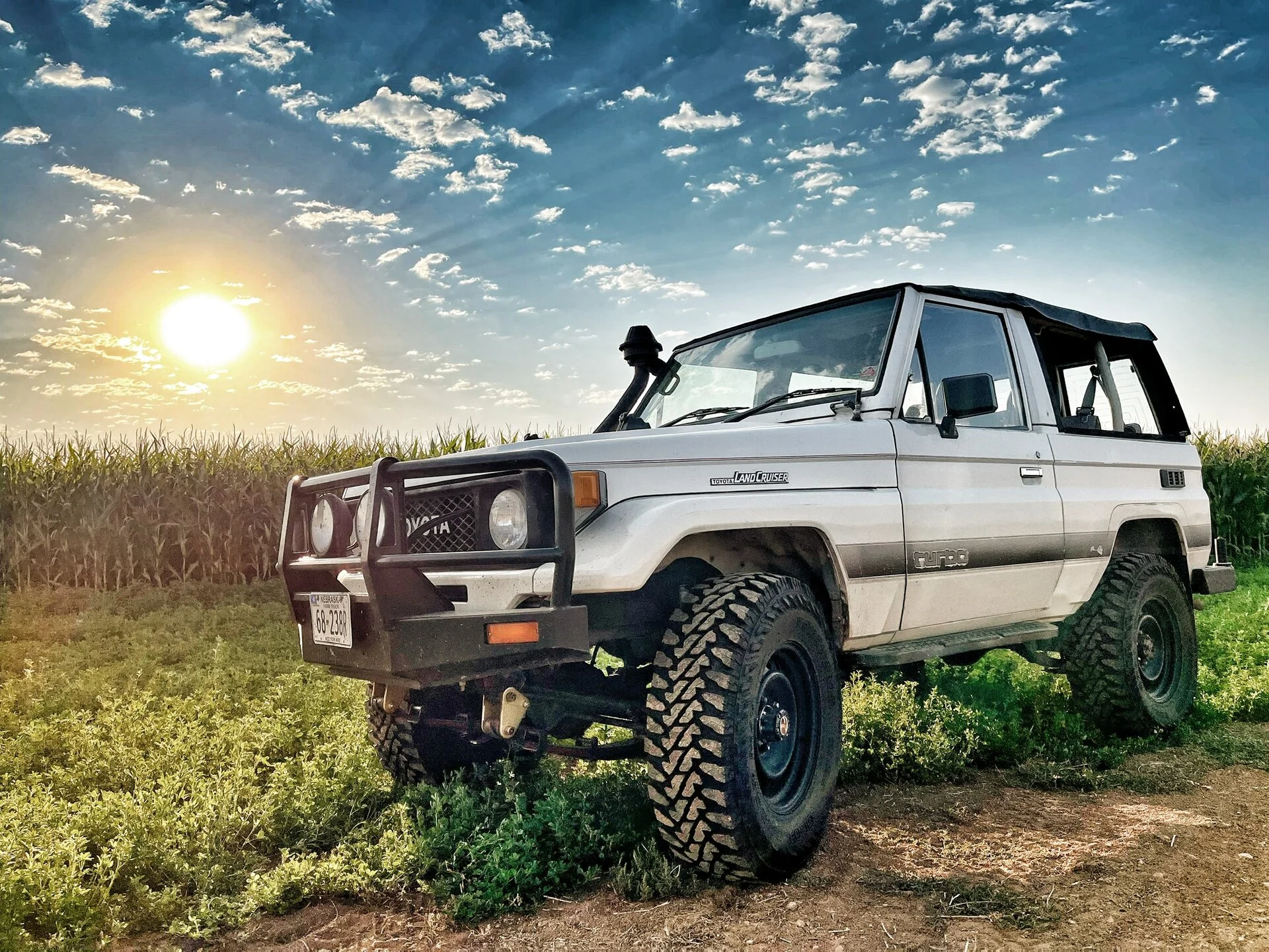

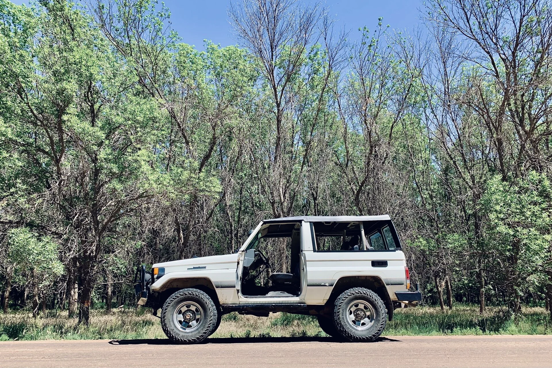

HZJ73 all the way!
Can that KZJ78 do this??
Besides the above obvious of top off summer driving awesomeness of the 73/74 series, the Mid wheelbase are just fantastic. Not too short to ride bad, doesn’t feel like driving a bus troopy or 4 door.
The 1HZ is a better motor. Turbo definitely makes it feel better and more modern, but you have to do it right to avoid head issues (intercooler etc)
