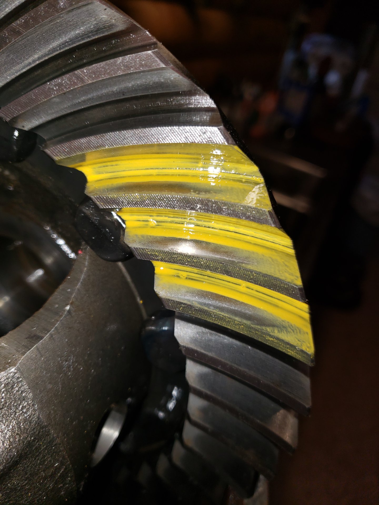

- Paint pattern looked even but shallow. Given that the pattern didn't look all that bad to me, I'm thinking I should be able to get a good pattern with the right BL.

- Gears looked to be in good shape with no chips or discoloration on ring or pinion.

Here are some pics (gear paint was a bit runny... fyi).

I'd probably run what you have if your not going to a different gear ratios. The gears appear to be in good shape. 1st I'd install the pinion at the same depth as the factory did. Set up the diff and see what you have. Most likely you should be good. Bearing dimensions are pretty consistent from one another. Pinion depth adjustments are required for the variations of the machining of the 3rd member case . Your 1980 pinion is fine spline, so it's strength should be good. Pre load is used to determine if the bearings and races are seated properly. Over time it dissipates as the bearings and races seat /wear in to each other. I would try to get the same ring & pinion pattern as they were originally setup. When you change the b/l it might change it slightly. These gears have been running together for 50k on that setup. Changing from the original pattern could cause whining or howling. Your clunk could be from the spiders. When load is applied to pinion the spiders slide outward on the center shaft and hit the diff case, that's why there are thrust washers. If your going to an ARB that might eliminate that.
