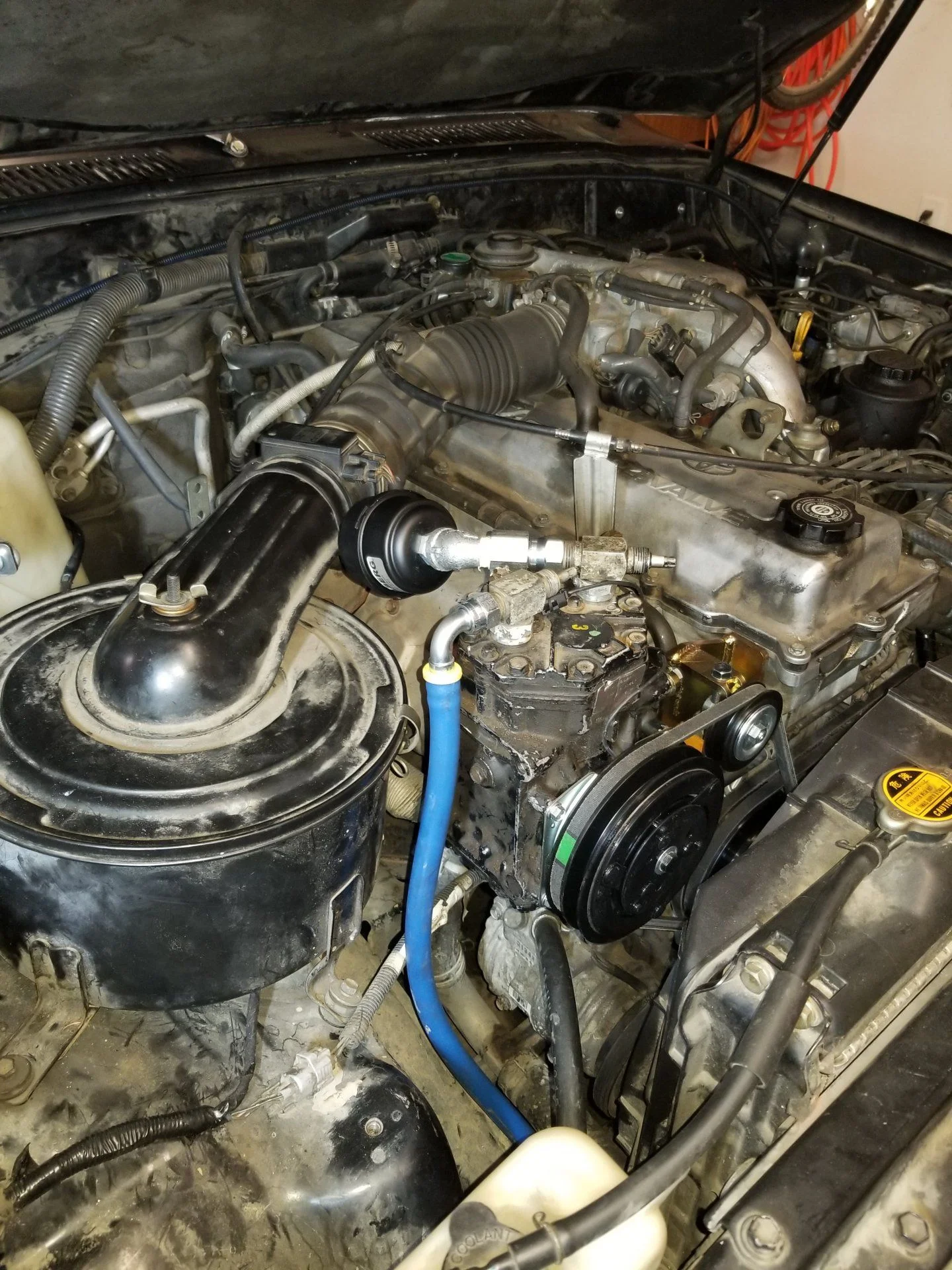

I've been running the York 210 with most of Joey's Wits' End OBA kit for the last 2 1/2 years. This setup gets a lot of use...I'm always done airing-up before my buddies are, and will end up helping others air-up to get the show back on the road quicker. Absolutely no regrets...it's a serious system that just kicks arse.

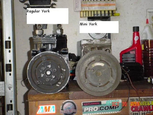

Im toying with the idea of installing OBA into an 80 with 1HD. This is much more problematic than FZJ80, because the alternator, the A/C compressor and the second battery box are located on the passenger side of the engine and there is a lot less room there as a result.
After doing some research, i discovered that there was a slightly more compact York 209, and even smaller - York 206.
Im thinking of going with 206 if it makes fitting it easier. I dont mind the lower output of 206 compared to 209/210. I would be buying the compressor new, so i dont care about the fact that 206 is far less common on scrap yards..
Does anyone know how much smaller the 206 actually is, compared to the 209? Bellow is a pic of 210 VS 209 "mini", but i could not find any external dimensions of a 206.
Also, are there any other, smaller air compressors that are internally oiled and can be belt driven? Perhaps a unit from a small shop air compressor or a small truck air brake compressor? I would love to use a compressor off a Hino truck, if possible, to keep everything Toyota..

Im toying with the idea of installing OBA into an 80 with 1HD. This is much more problematic than FZJ80, because both the alternator, the A/C compressor and the second battery box are located on the passenger side of the engine and there is a lot less room there as a result.
Also, are there any other, smaller air compressors that are internally oiled and can be belt driven? Perhaps a unit from a small shop air compressor or a small truck air brake compressor? I would love to use a compressor off a Hino truck, is possible, to keep everything Toyota..

Went with the kit from Wits End for the York oba and couldn't be happier. Like Joey says, he did all the hard work, all you have to do is bolt it on. Got to use it on my first trail run last weekend and am really happy I went this route. Will be going to the air box for the suction air once the parts get shipped out from Wits End.

@TurboDennis it looks like (may be optical illusion) that your mini York in the photo has the larger diameter clutch. If you end up using the kit from @NLXTACY , you my have to source a slightly longer belt. As others have said, you can mount the York in a few orientations. I recall seeing a capacity chart regarding cfm for the 2-3 most common York sizes, but I couldn't find it this morning. I think the take away was that air tools might not run optimally off of the smaller Yorks? I got my compressor used from a mud member in good shape, but it does have the larger clutch. Clutch prices seem to be $100 or more alone.
