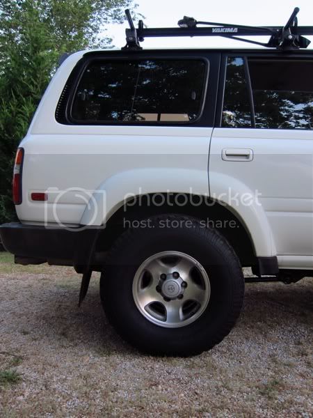

265/75 Grabbers. OME Stock Height with fresh OEM shocks from CruiserDan. Sits plenty level for me. The "Stock Height" springs have a heavier rate and are great for people like me who load heavily when traveling. They are firm. I like the lift and tire combo. The Grabbers have served me well, no punctures on a number of Baja runs, but I'm not wedded to them. I'd like to try the Cooper ATs in the future. On my "new" 1993 rig (two now and always looking) I'm going to go with the 2.5" OME mediums and the same size tire. Then I'll have a real good opinion huh?
Back to the tire/lift combo: I don't regularly run around with the cargo box, and I have a strong engine and an intelligent foot. I just filled up today and calculated my mileage as usual. 15.6mpg. I read where the tires are like 2% larger that stock which means I'm traveling slightly further than my odometer reads so that's a solid figure. So I'm going to have to do some much more serious wheeling than I actually do to justify much larger tires.
