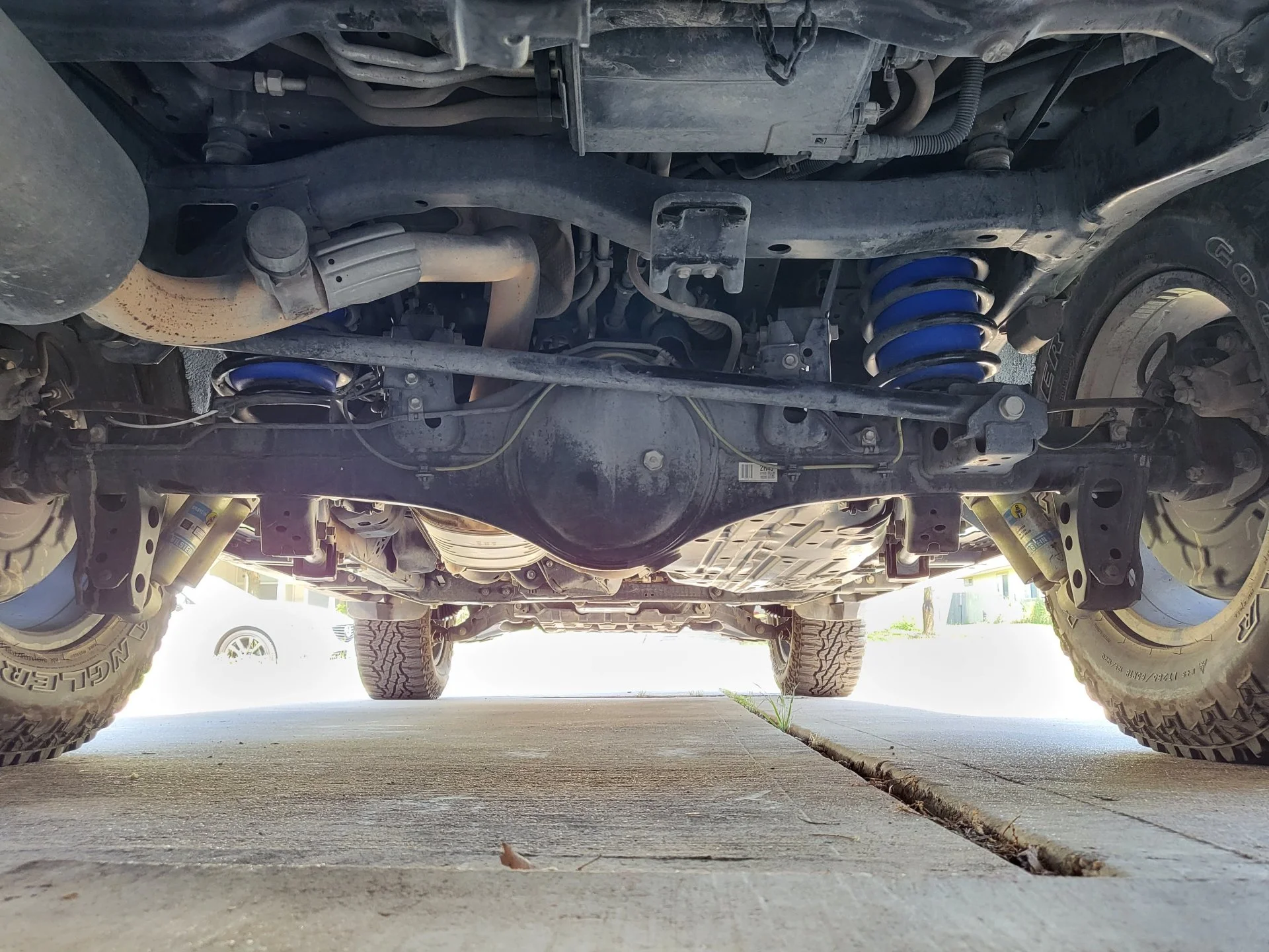

Airbag work (just following the included instructions):
  1. Take the pyramid-looking bump stops out of the springs and cut off the lower 4 sections.
  2. Put the airbags in the springs (hole toward the top).
  3. Cut the provided tube in half, and add the wire loom now if you have some.
    • NOTE: leave at least 1" bare without loom on one side for the next step.
  4. Push to securely connect each section of tube to the easy-connect fittings on the airbags.
  5. Thread the tube through the hole in the shortened bump stops, placing the bump stops where they belong on the springs.
  6. Stand the spring/airbag/tube combination on the ground near where they belong on the axle.
  7. Thread the tube through the top frame hole where the springs will rest, and temporarily bring them out through the gap in above the frame into the wheel well. This will make routing a lot easier.
  8. Install the spring/airbag/tube combinations back onto the axle. Do passenger first, then driver. Same procedure as when you removed them - push on hub with knee and insert springs (make sure to align correctly).
  9. Route and zip-tie along the top or outside edges of the frame (there are lots of other tubes and cables in there that you can bundle them with), until you reach your target where you'd like to install your air valves. You'll have a ton of extra tubing, just leave the extra for now.

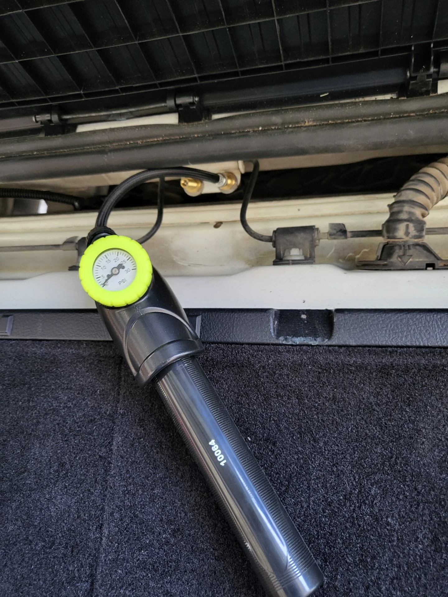

  10. Inflate airbags to 5psi (minimum when not using them.
    • NOTE: I added a hand pump to my gear that goes up to 30psi, since the airbags max out at 35psi. The hand pump works pretty good, and I will use it only when I need to make small increments (15 pumps for 5psi) or don't want to get out my bigger compressor.
