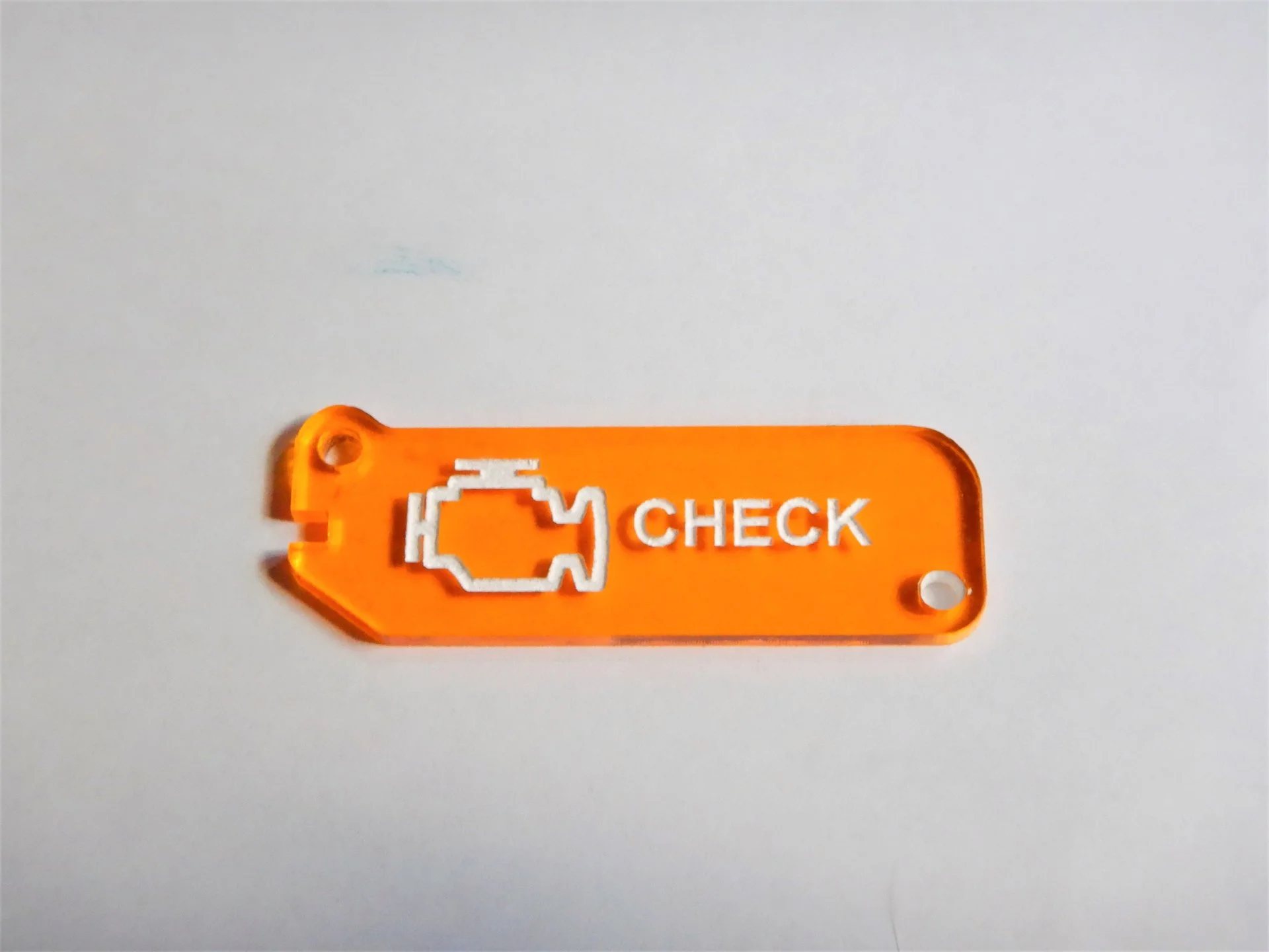

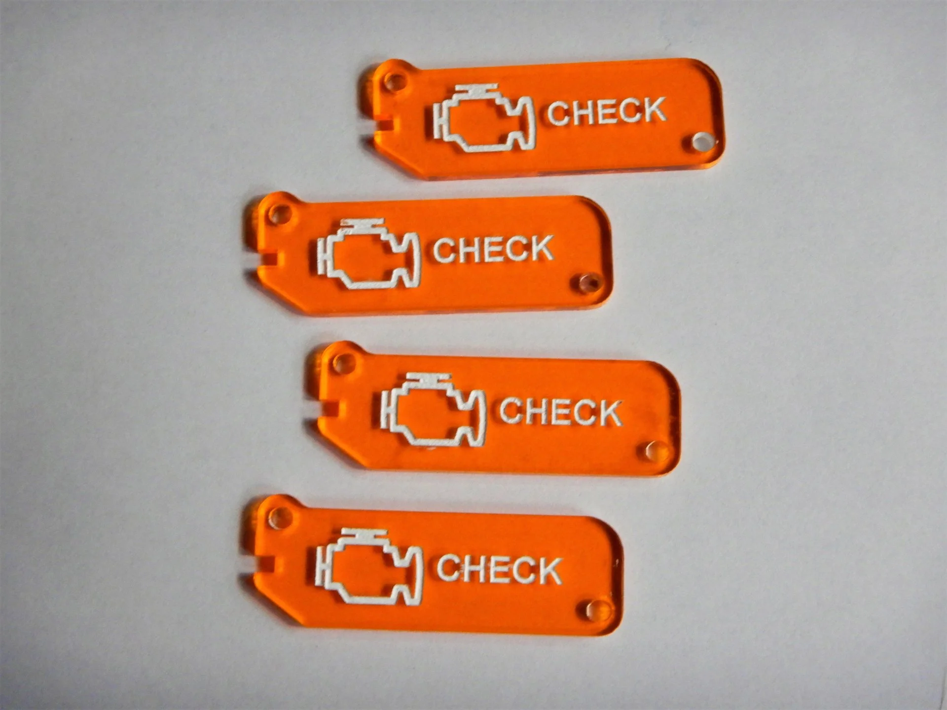

FJ60 HOLLEY SNIPER CHOKE INDICATOR LAMP LIGHT
CHECK ENGINE Update CNC Engraved Poly Carbonate
Upgrade / UPDATE
SKUNK-WORKS Quality GRADE
Lens Lense

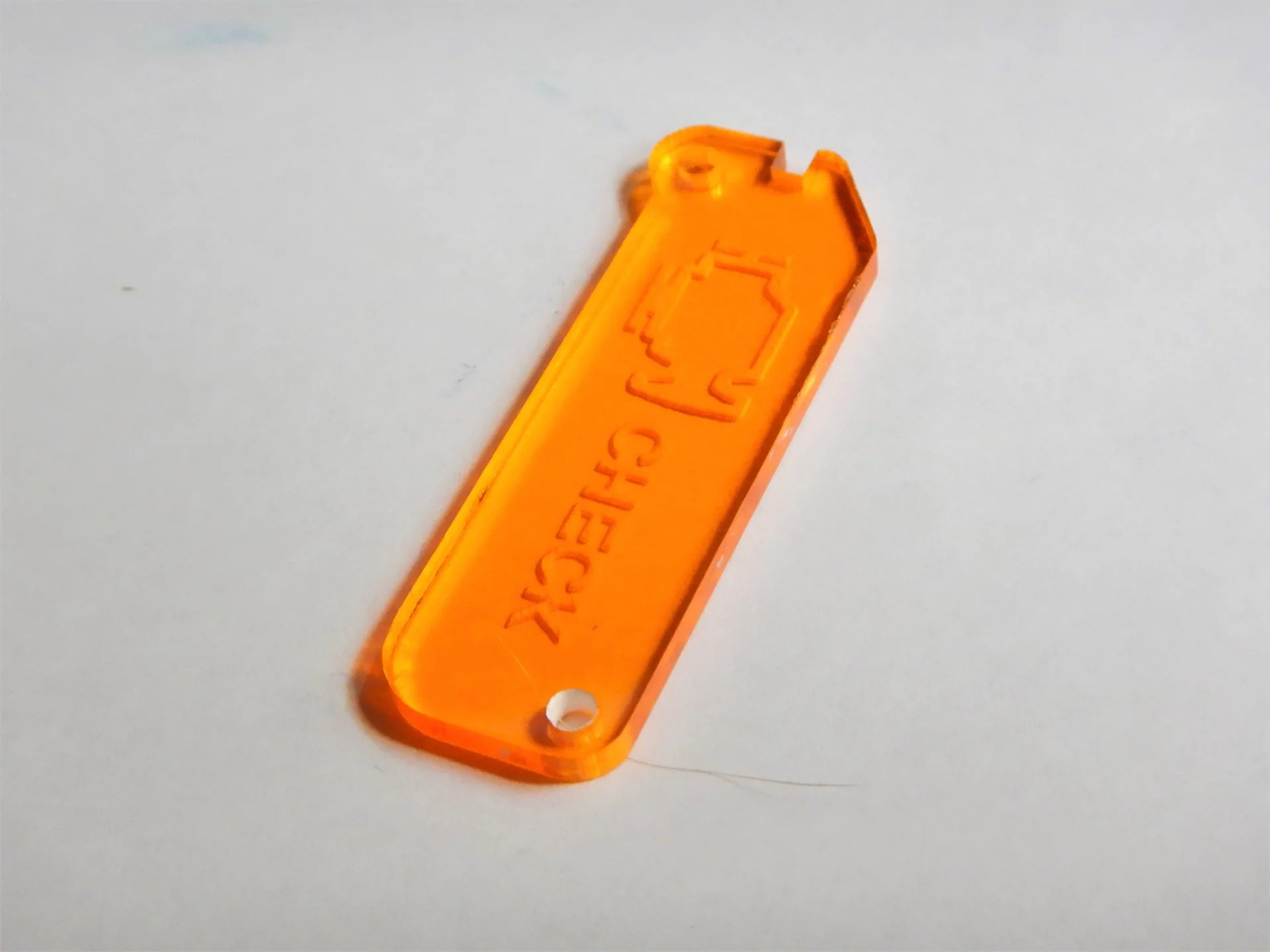

So what on a Sniper would trigger a Check Engine light?
hi nolen
thanks for the question

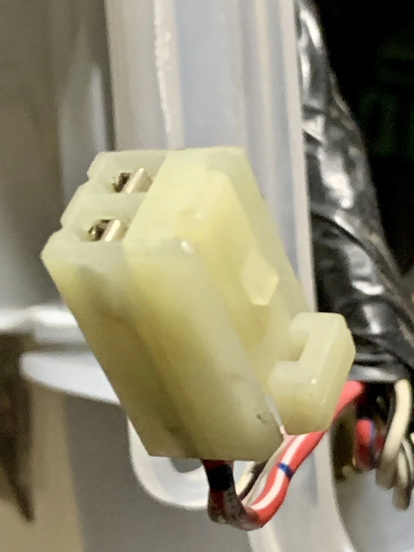

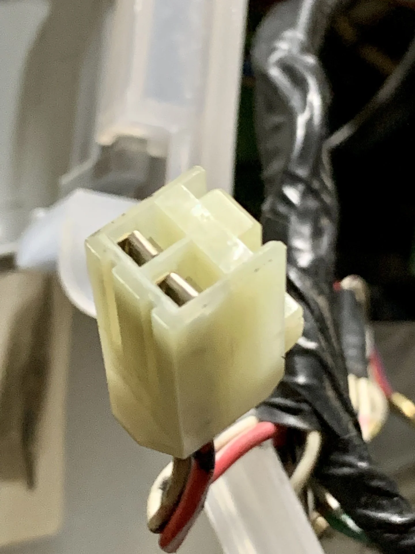

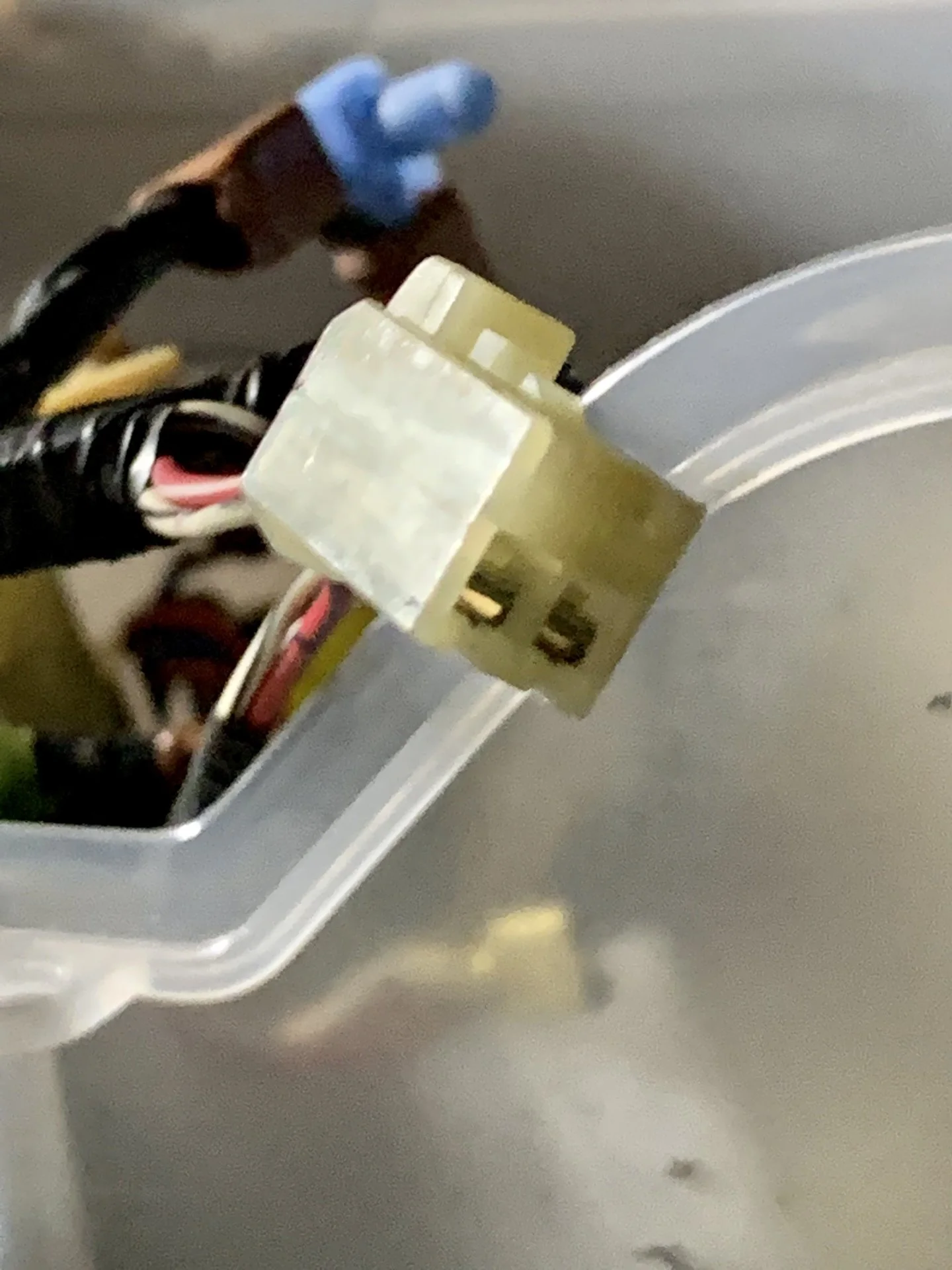

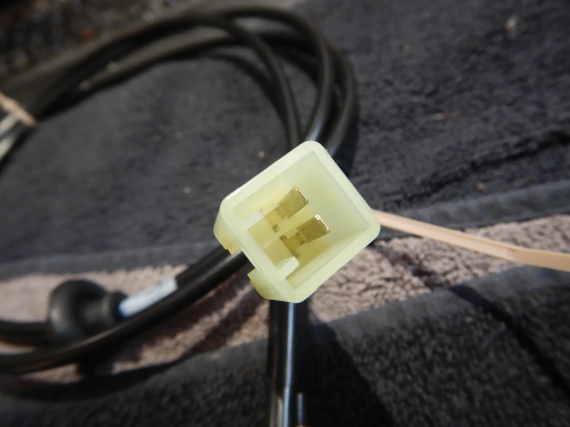

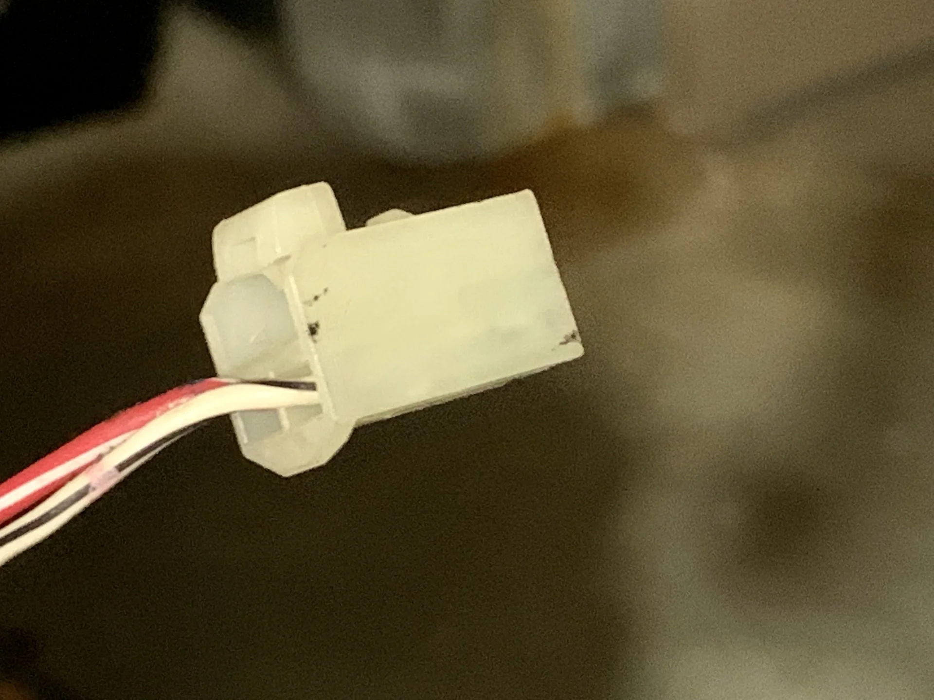

- since the stock oem choke cable 78410-90a04 on a FJ60 has a electrical connection feature on it to illuminate the red CHOKE lens in the dash as is when the choke is pulled out 1 or more rachet detent steps .............
- u will unplug the FEMALE harness side of the factory choke cable , then connect the SNIPER to IT , hence you will illuminate the OLD choke warning light circuit NOW occupied with the CEL amber lens above
- it's a re-purpose of the OEM dedicated old now abandoned choke red lense lamp circuit , now fed by SNIPER ECM ,
- does this help clarify your question ?
- i will add more TECH above , also i have a old FJ60 cluster with lense installed , will tech step by step install of the LENSE too
- my above KIT will Come with a New LED BULB for the old choke lamp red lenses socket .

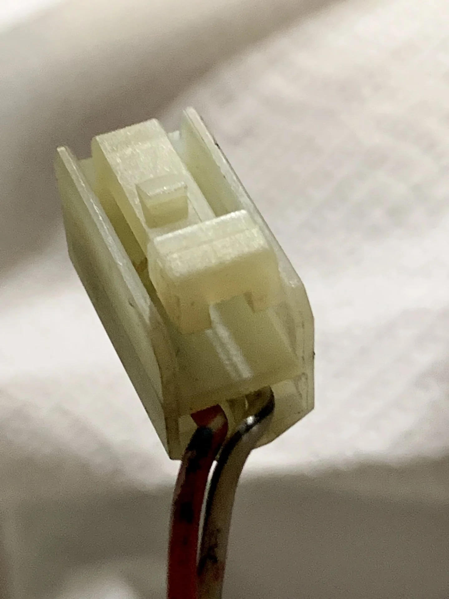

- U WILL need to CUT OFF the Old choke cable factory connector for and re-install it on the sniper wiring harness to feed it for FSM CLEAN install , it gets repurposed if u will
- most stock fj60 choke cables are trashed anyway , so this is good use of existing DEMO parts
- eventualkly i hope to source the device side oem connector maybe but have struck out this far ?
- finally : You WILL need to set up the SNIPER system “ Warning Output “. Feature or optionn

old devise side choke cable connector u need to re-pu
Here is the fj60 harness side connector for the old choke red lense feature now repurposed to feed the new Amber CEL check engine LED indicator light lamp lens
