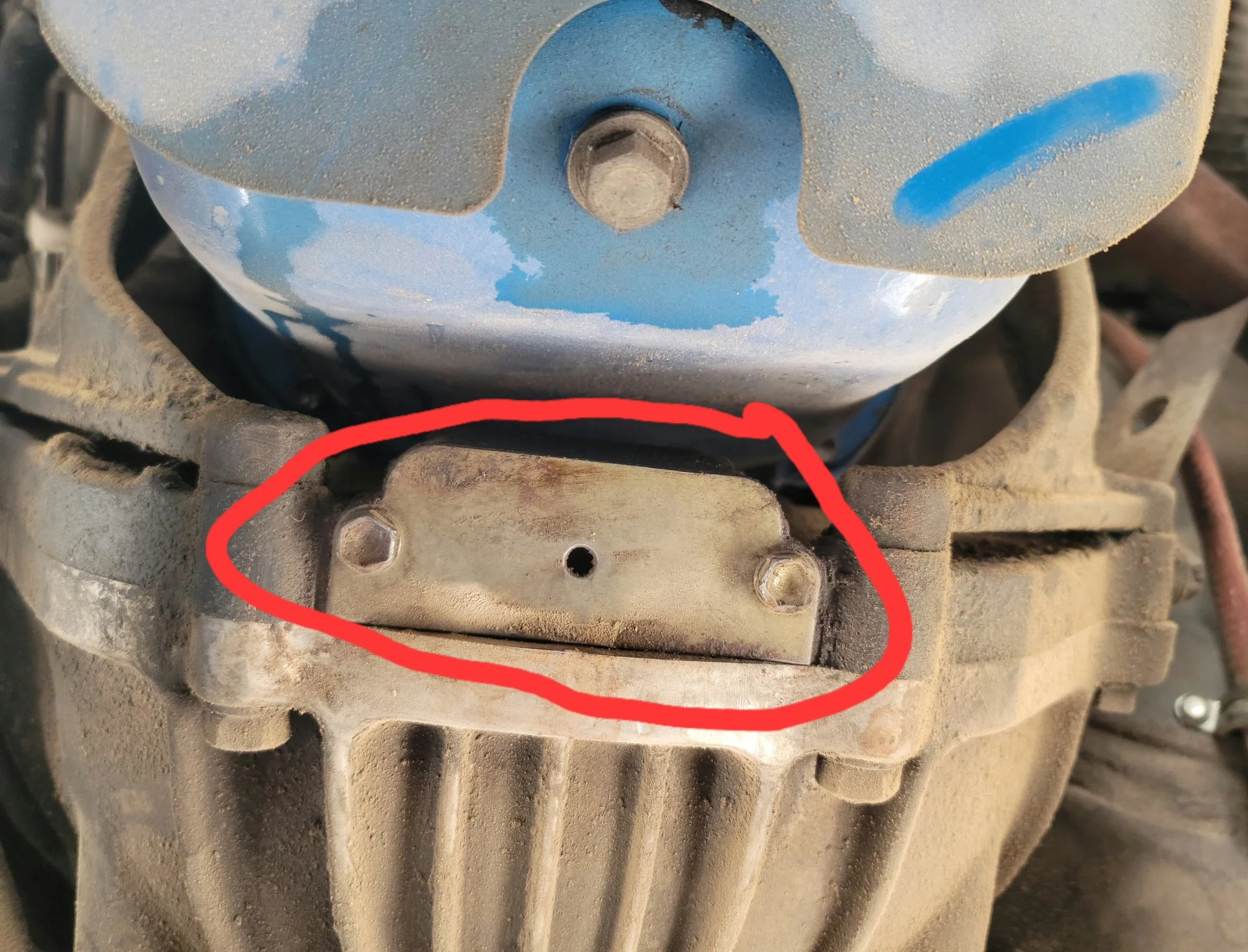

For the transmission inspection plate, I think they're talking about the black plastic cover on the back side of the bell housing.

this cover is easily removed, use a flashlight and inspection mirror, or get fancy and use a bore scope, check for oil residue on the flex plate.
Oil often pools on those bolts, being the lowest connected part to the oil pan, so people misdiagnose as a bad rear main seal.
IME, 3fe rear main seals are not a common or routine failure.

Had to go out and climb under my rig to take a picture, View attachment 3066204this cover is easily removed, use a flashlight and inspection mirror, or get fancy and use a bore scope, check for oil residue on the flex plate.
Yup, that's exactly where mine is leaking and before I had tightened the oil pan there was oil all over those two bolts. I'll try to take it off this weekend and have a look.

Good to know that this wouldn't mimic a rear main leak. It's probably just my oil pan gasket then.
