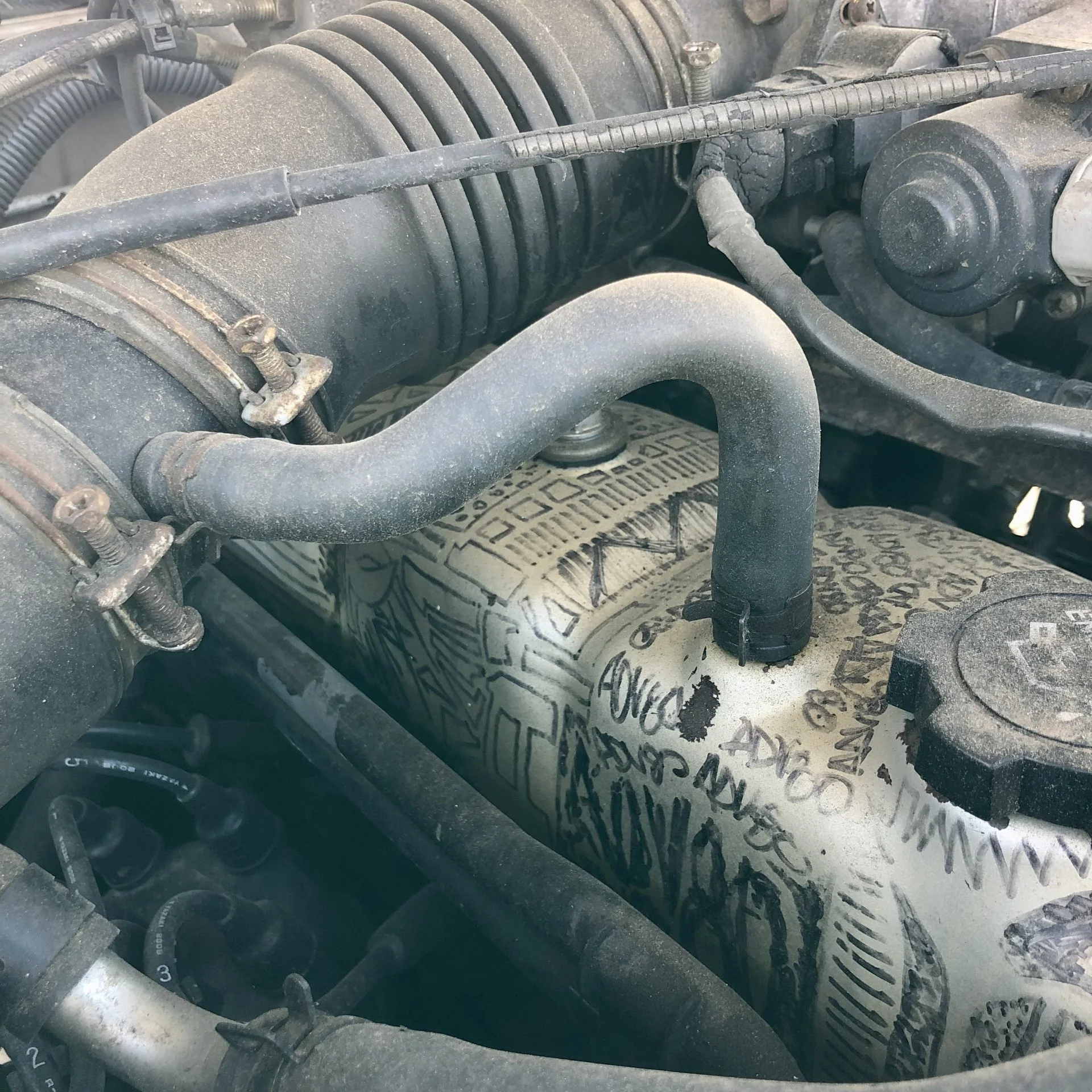

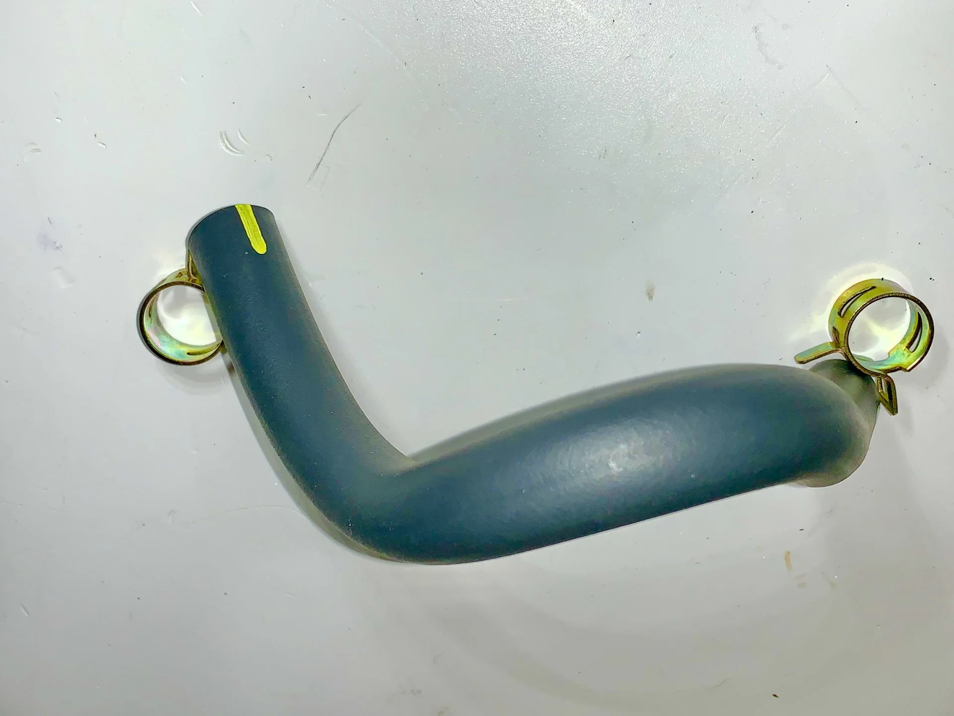

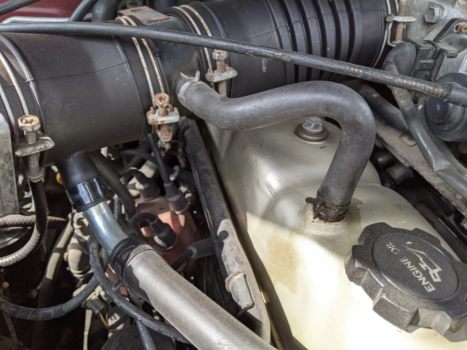

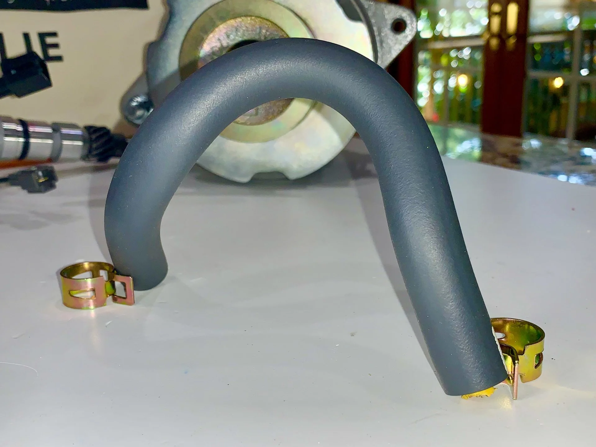

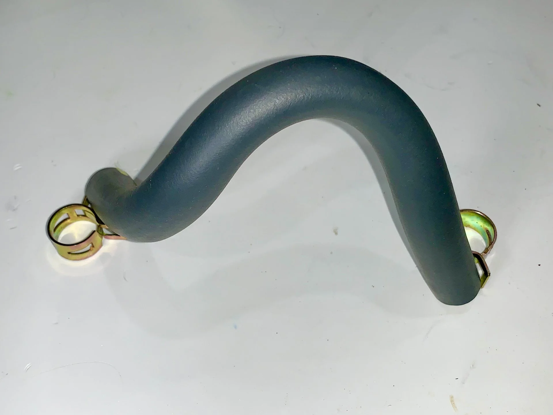

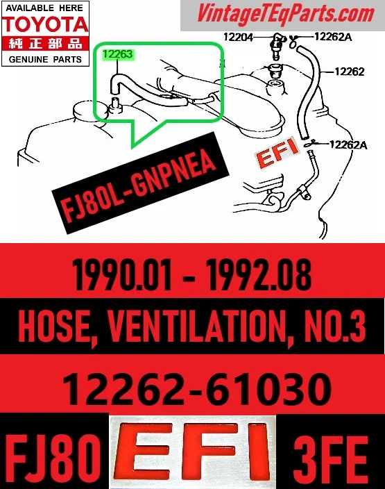

i have reproduced the 3FE 80 Series main Valve Cover to Air intake metal tube spout fitting using 100% TOYOTA OEM Genuine Parts part # 12262-61030
both 3FE FJ62 and FJ80 3FE use different breather hoses and different PCV valve vent hoses too
the 80 Series and 62 PCV hoses are currently under development using once again 100% TOYOTA Genuine Parts JAPAN FIT Form and Function
NO MORE Pesky OIL Leaks here ! :cool::beer:
NO more using coolant hoses either ........ :rolleyes:

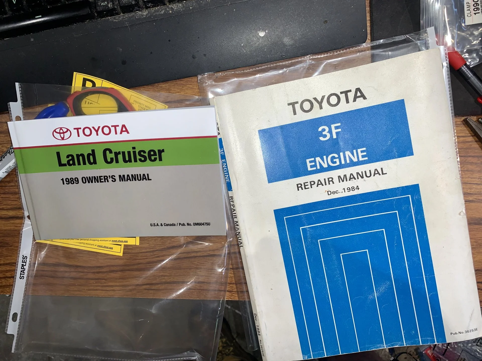

Here are 2 separate but equal 3F / 3FE. Oil viscosity charts
It clearly states not to go thinner then 10w40 unless the ambient temperature is constantly below freezing 🥶
5w-30 in ANY F series engine , minus the 1FZ-FE
Is simply somebody choosing extremely poorly ..

Those books were printed 30ish years ago. Modern synthetic oils have come along way. I know people run that Rotella 5w-30 in all kinds of vehicles that don't call for a 5w-30.
I'm not saying it's right or wrong. Just saying that the modern synthetic oils are pretty amazing and they certainly didn't exist when the 3f and 3fe were designed.
On my old 91 I only used the cheapest non synthetic 10w-40 I could find.
