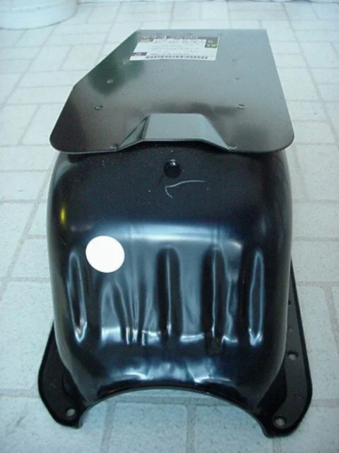

I was able to braze mine, then sealed it like Pablo suggested.
Ed
Wow! That's quite a difference in the look of the pan. More lip overhang, so to speak. Any thoughts on the different style (at least from FJ40 2Fs I've seen) of the replacement pan? Does it offer more protection? Is the skidplate thicker?
Protection from what?
The plate thickness is not the same as earlier pans...
If you set the truck on a rock or log, and it finds it's way to the pan, it will not make any difference...the pan is still going to lose... ;)

You might check my write up in tech on oil pan installs with snap-ups. Makes the install much easier.
Big branches popped up by a tire could hit the oilpan skid plate without necessarily stressing the main body of the pan, so how thick and how much coverage is in the skid itself can make a difference. The weight bearing capabilty of the pan never entered my mind since, as you say Poser, it's over by then.
