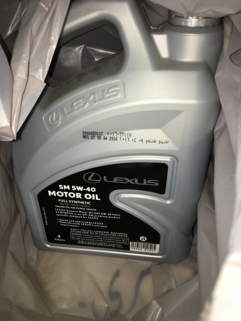

I think its 5w 40 if I'm correct. 5w 30 not easy to find.
