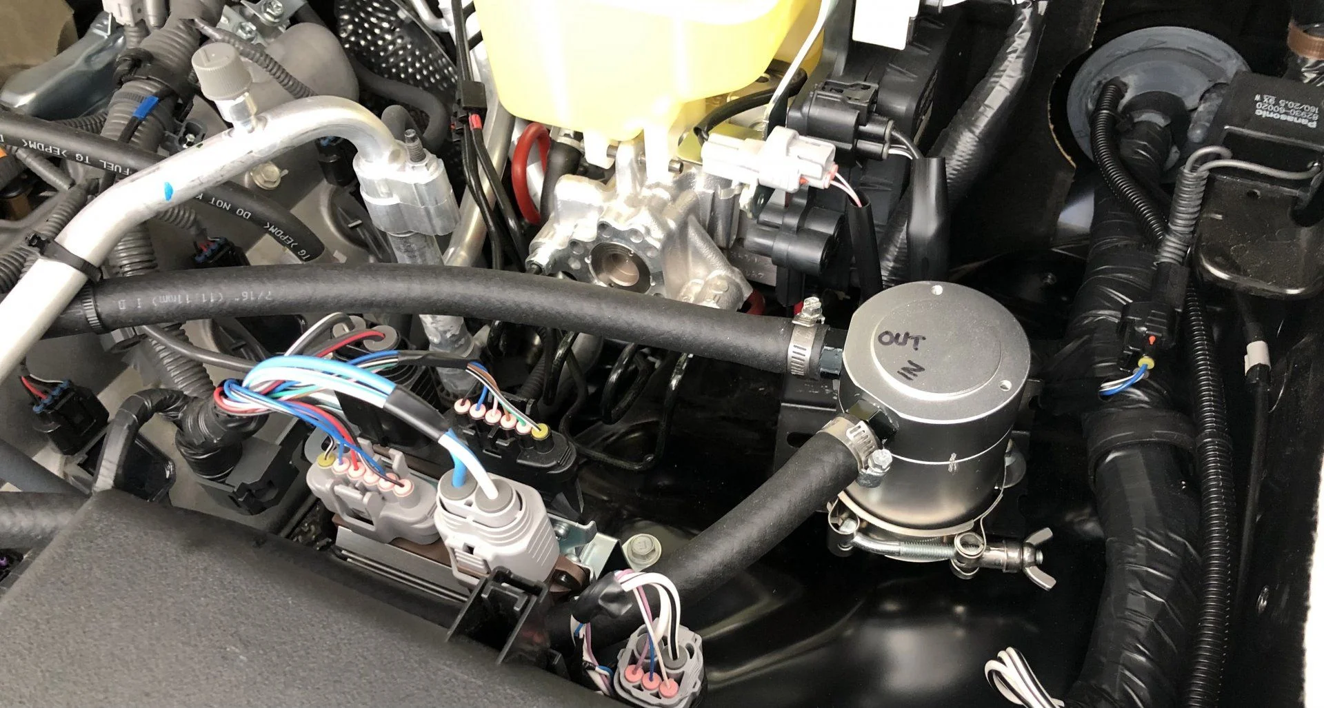

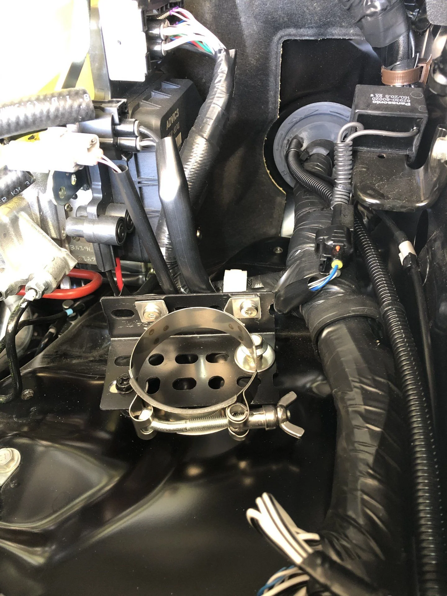

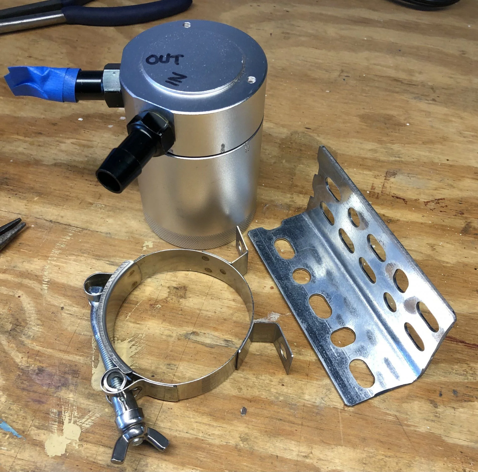

I’m using my 'old 4Runner oil catch can'(baffled) that I find very effective and separating air in oil. Made the brackets for the 2020 LC-HE.
i’m using the circular clamp with a wing nut for quick release the can because I find it easier to just lift the can and unscrew the bottom when emptying it. That is instead of using the cans original top clamp where there’s not much space unscrewing the bottom of the can while its top is clamped onto the firewall.

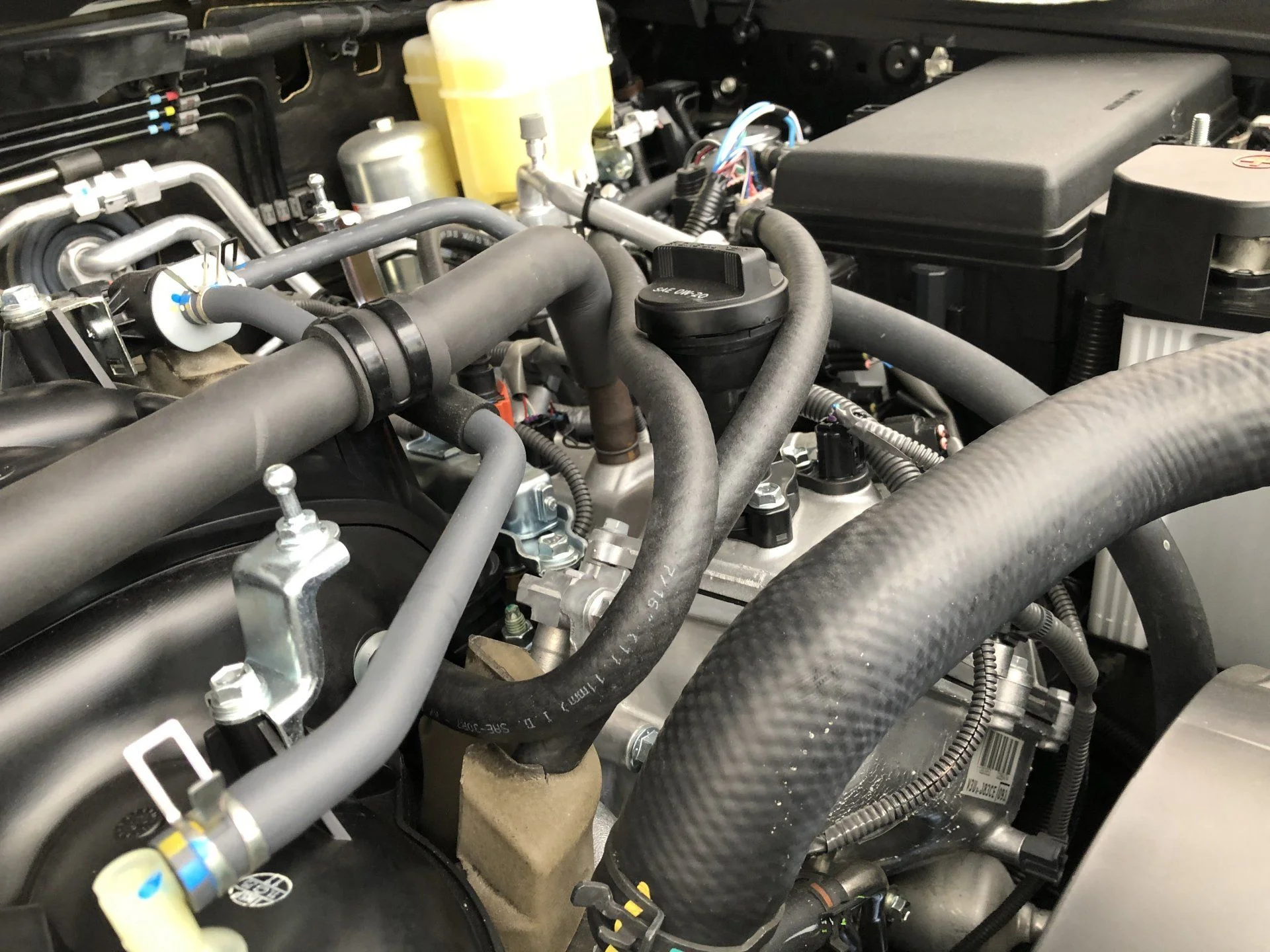

Few more pix. Retained the foam around the PCV as it serves as a heat shield. It is very hot in that crevice.

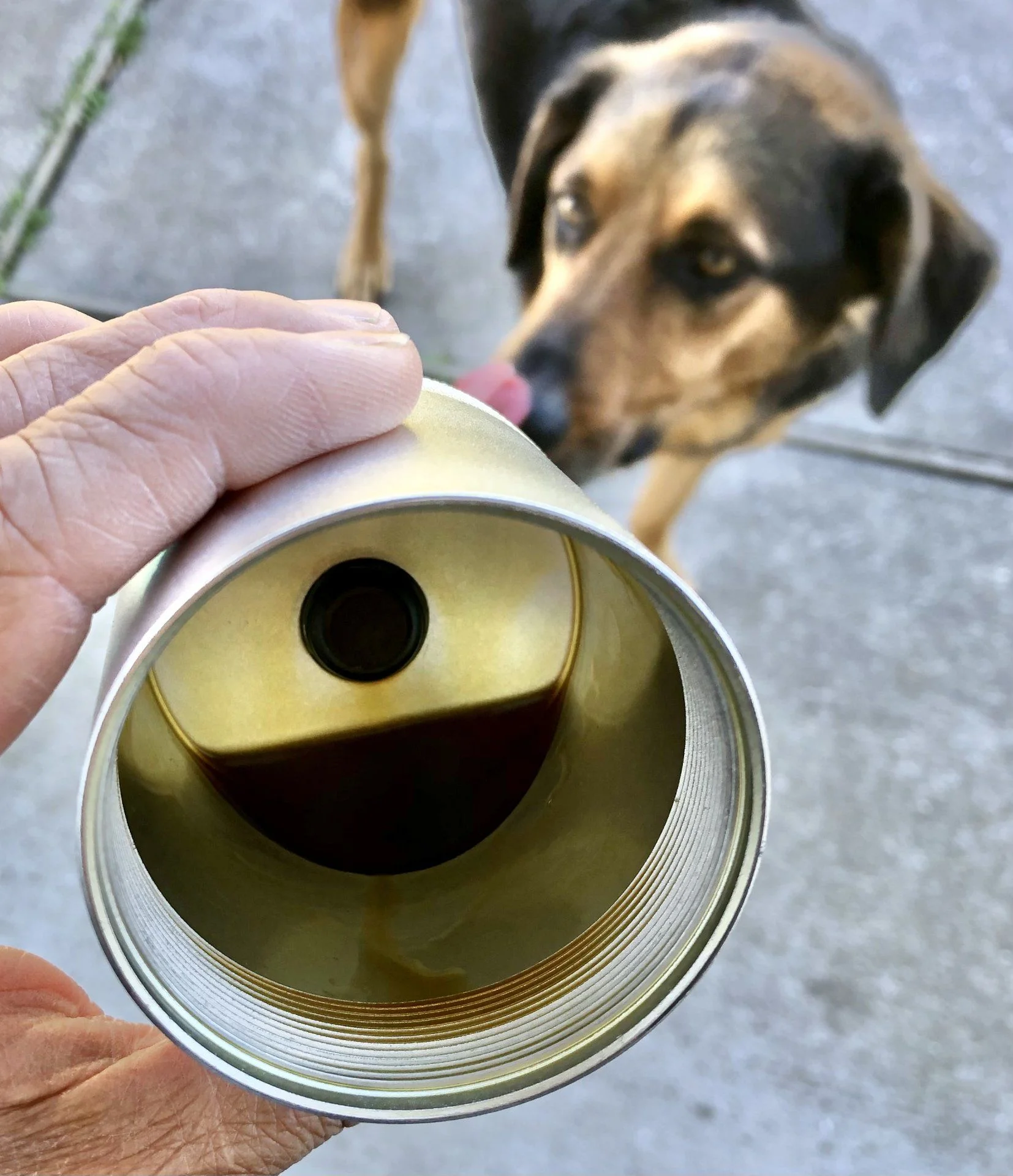

There sure is !!! It catches about 1.5ml of oil from the PCV every 200 miles that would have otherwise been accumulating and saturating the intake manifold, coating the valves and piston heads in the long run. This is my keeper retirement vehicle and I’m definitely be taking care of it.

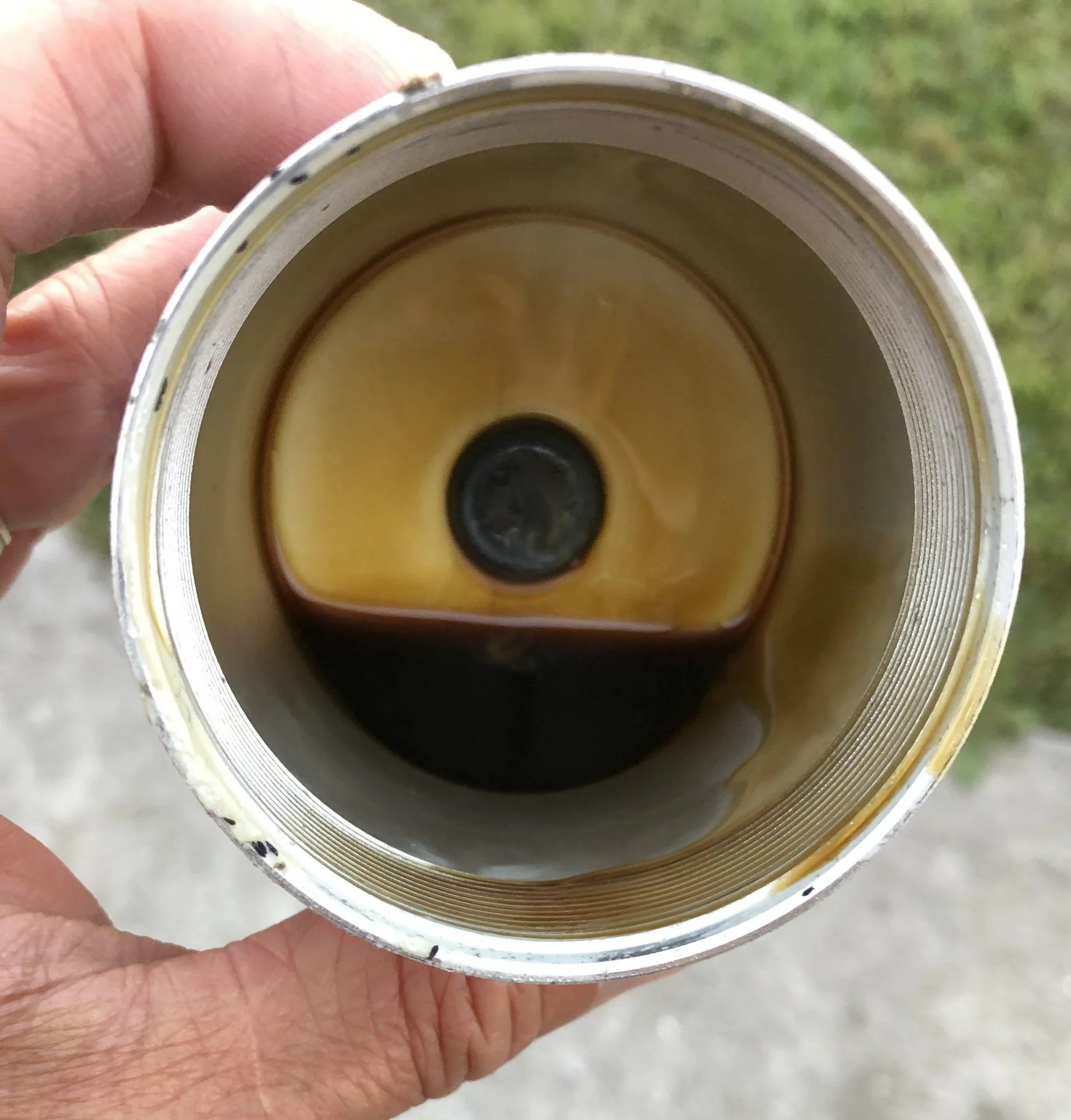

after 380 miles. This would have been coating the intake manifold, valves & piston heads.
This is what I got after 380 miles. This would have been coating the intake manifold.

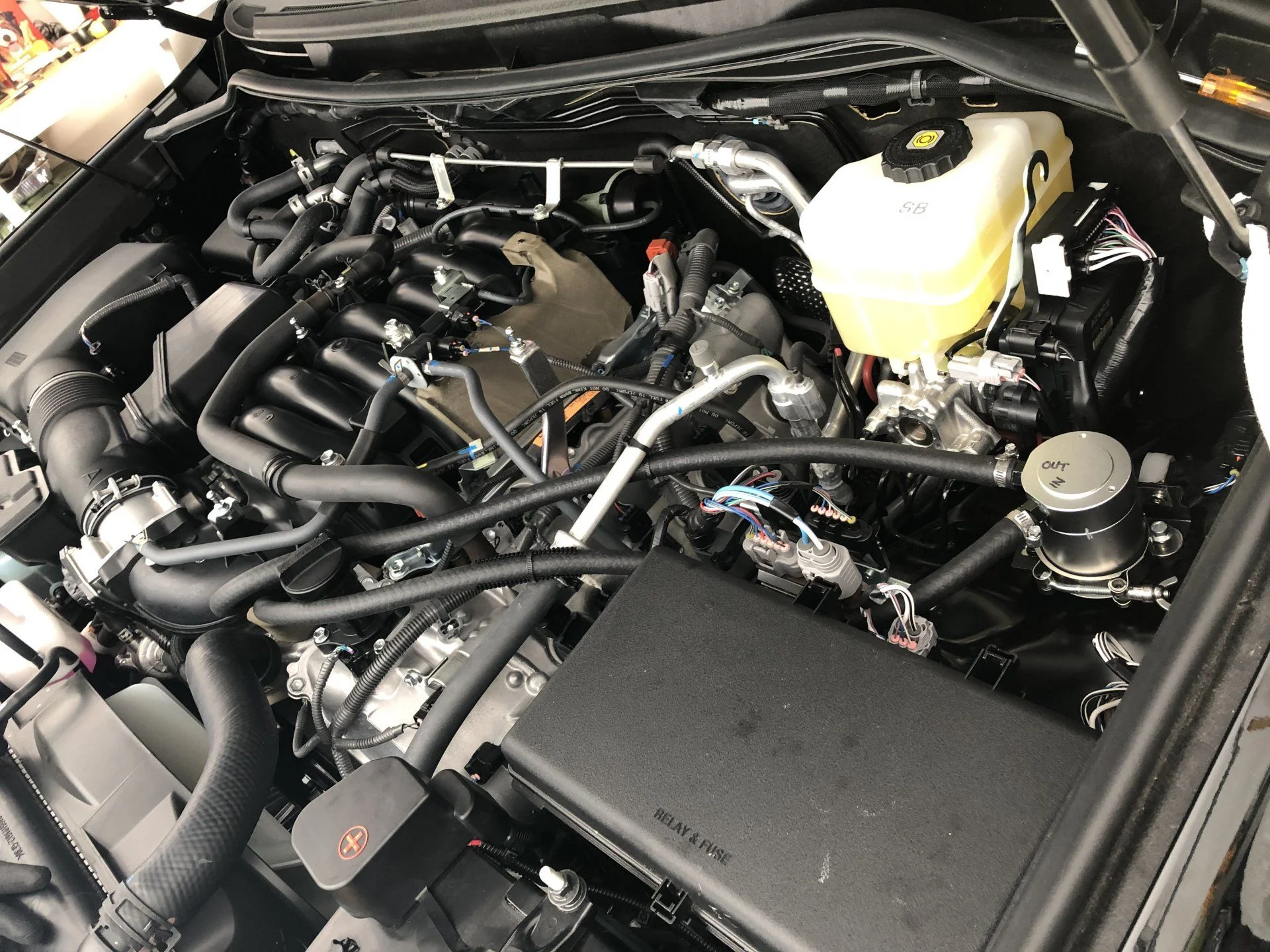

Clean install
