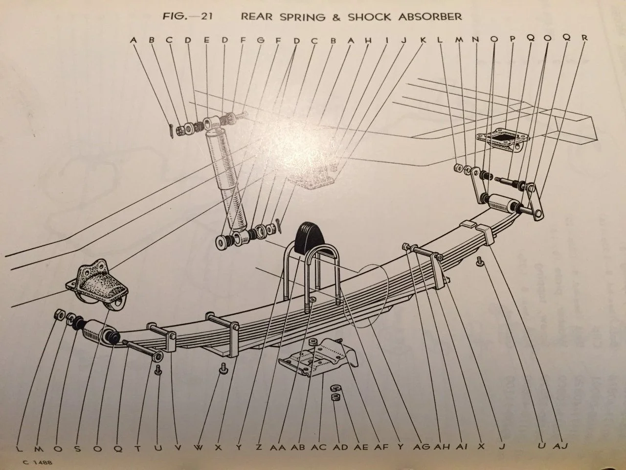

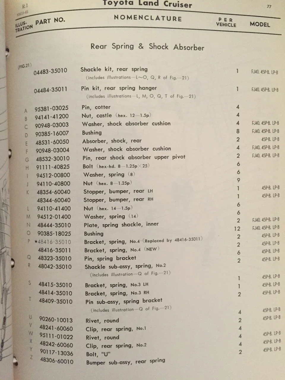

The rear shock part number in November 1964 was 48531-60050 via the 93628-64 Parts Catalog. This was also used for USA destined trucks as of October 1968 Parts Catalog 93666-68, so for 1966 that should still be correct. The 48531-69059 is the ISO version.
Hello Kurt, I don't have the '66 or '67 LPB parts books in the collection but the part number from my '65 is the same as the one Bear offered.
Thanks Bear!
View attachment 1100220 View attachment 1100221 However, the '71-04 part number is 48531-69055 which would have preceded your superceded 48531-69059
