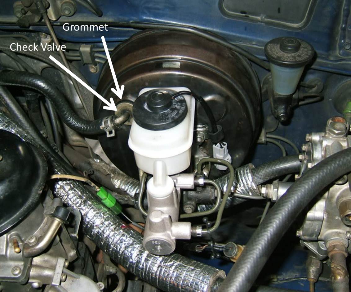

The check valve is the metal thing in this picture that connects to the vacuum hose. The grommet is the rubber part that seals the valve to the booster.
I'd order one from Toyota. Use CDan or Beno or one of the many toyota parts websites. I usually use toyotapartszone.com. Replacement is simple. I think there's a metal tab to secure it that requires removal of one master cylinder nut, or you can just bend it up. Pull the valve out, pull the grommet out, then push the new ones into place. Requires a decent amount of wiggling and force, but it's not too bad.
What happens is the check valve gets stuck closed sometimes when it gets really cold and old and sits. That keeps the booster from developing vacuum which gives you a hard pedal. Eventually, it warms up or gets jarred loose and everything functions fine.

Thank you very much for the info and the photo!!!
Looks like this is the location of the valve on my '94 and the nut holding the metal piece in front of the valve/grommet needs removal to take the old one out?
Yes:
