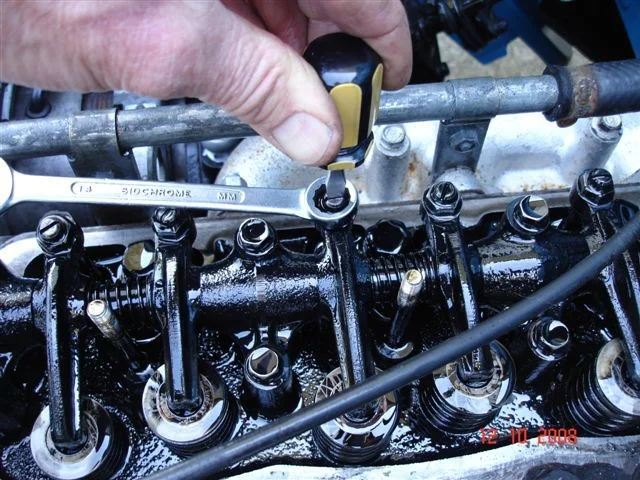

Hey guys I'm headed to Napa in a few minutes and wanted to know the nut size for the adjusters found on my rocker assembly. I want to buy that nifty little valve adjustment tool.
Is it a 17mm??? 1978 2F engine.
ADDED LATER: who sells these wrenches with the crewdriver thingy on them, Napa no longer sells them in my location. any advice on a decent vendor? I don't need super snapon quality and price as I do one of these a year at max.

Mine is 17 mm. Heck, even if it isn't, you should have a 17 mm wrench for your rig anyways.
:cheers:
edit: I just read the Birfield link. Did the adjuster nut change size at some point? I'm pretty sure mine are 17 mm on my 71. I have a special box end wrench just for that purpose. Anybody know?

Looks like I'm right on the borderline. My engine is a 79', and the rocker shaft is off of????.... Looks like I'll need to look further into this one.
I was at Napa today and they didn't have the wrench I wanted. You know the one with the screwdriver built in?? Anyone have a good source for these?
