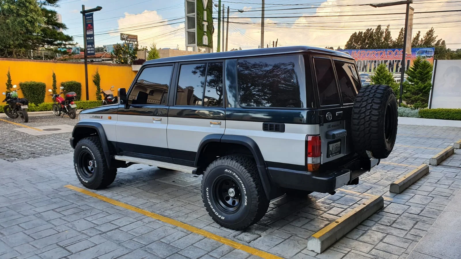

I'm trying to bring it back to its glory, since it was neglected and used for farm work during many years; I repainted it, redid the interior, replaced the head gasket, new brakes, 33's BFG KO's, everything I've been able to find new has been replaced and other things have been restored. It still has a long way to go for what I want it to be which is as close to a complete restoration some day. (it is lifted with spacers as we speak, it drives really stiff)

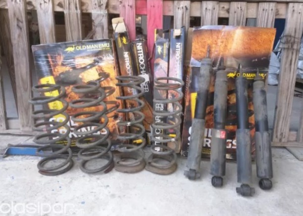

I have come to the moment to replace the suspension; I know everybody goes either for OME or Dobinsons, which in my opinion are both the very best for offroading and heavy loads, I´ve tried dobinsons in a Y61 and it is just great for that load. However the truck will not be used for heavy offroading or loading, other than touring and ocasional gravel roads it won't be seeing many extreme roads anymore. this as you know came with Coilspring suspension all around (Specifically same as the one in the picture)

SO, the big question is: what settup can I run to get a comfortable ride and a decent 1-2" lift?
I personally like the ride on Bilsteins 5100 but haven't found some for this car (Would the gen 3 4runner or LC80, PRADO 90 fit?) has anyone fitted this or some similar settup? I think the would fit and but installing them upside down would definitively affect the performance of the shocks. If possible I would be running these, with some springs, and the bushing kit from Dobinsons.
what do you guys think? I will very much appreciate your knowledge and experience!

Generally speaking, heavier springs are better for heavy loads, but will lead to a stiff feeling suspension if not loaded enough. I found my old OME suspension to be on the stiffer side.
Softer springs are better for lighter loads, and also allow better articulation/flexibility when offroad. Personally, I found the Dobinson suspension to be softer and a gentle ride.
In any case, both of those manufacturers offer a range of spring options for the light duty 70 series. Just look for the springs that don't account for extra load capacity, and those will be most comfortable. I found taller springs to be more comfortable also.
