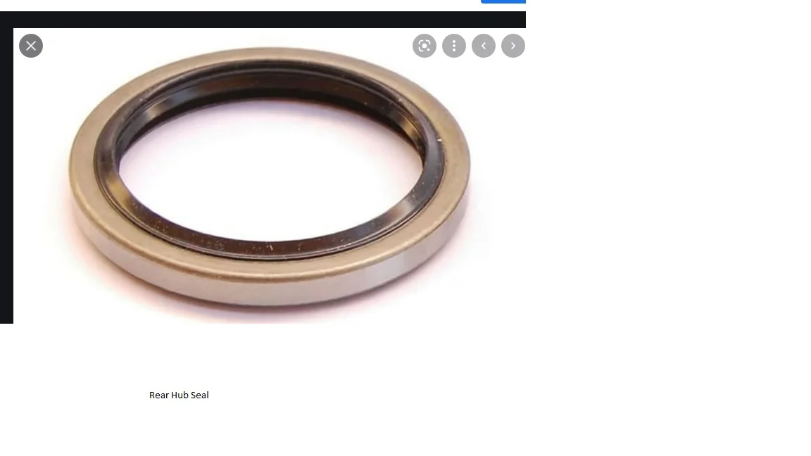

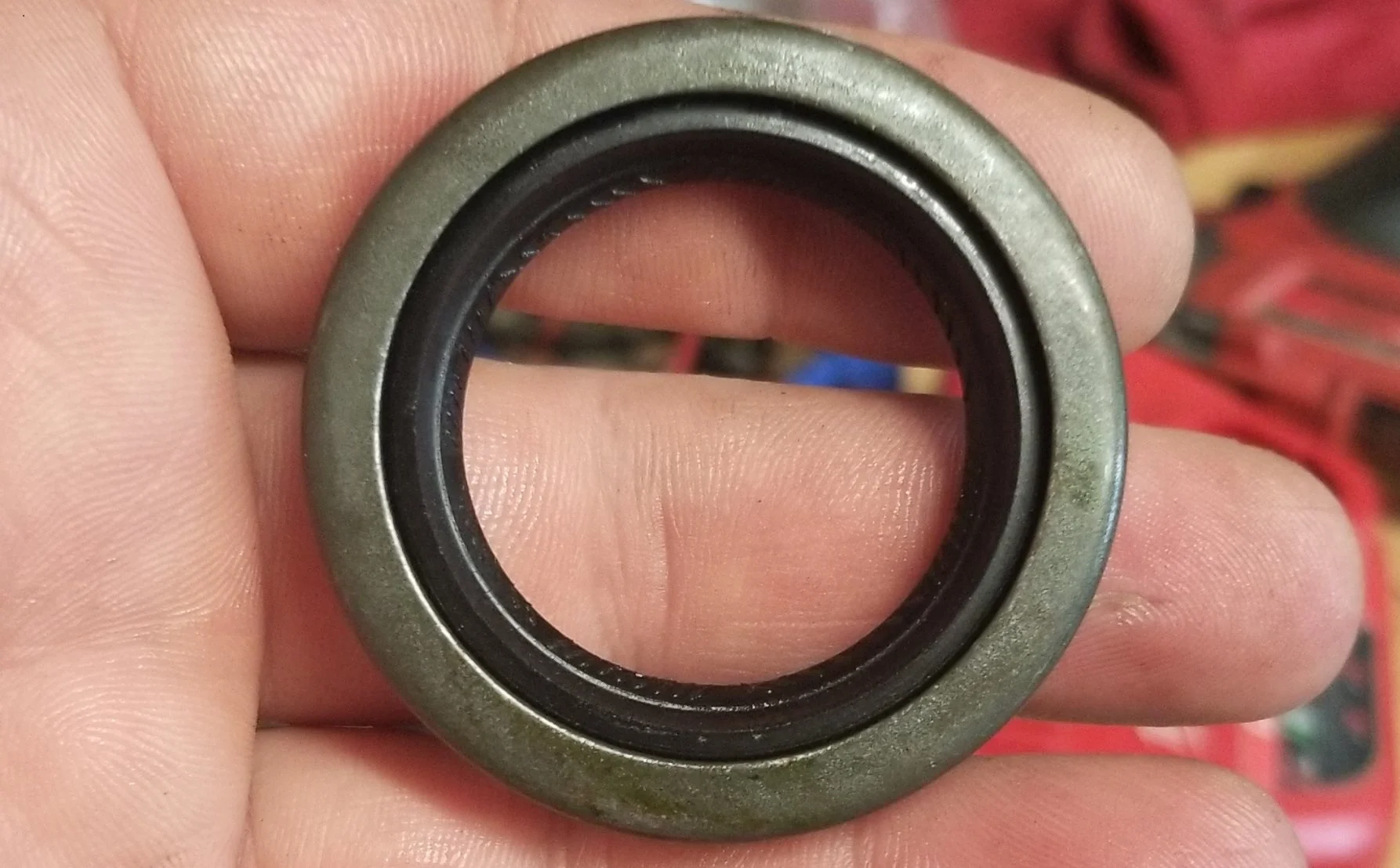

I finally found pictures that I think represent my confusion around the hub seals. As a background, I ordered a front axle rebuild kit and rear axle rebuild kit from Cruiser Outfitters that were shipped together. I don't think the parts were labeled when I received them, and now I have mixed up the hub seals. I received two of the seals that are pictured in the first picture (the picture with the hand holding the seal) and two of the seals in the second picture. The only difference I can see is the little rubber lip that extends above the metal find in the second picture. The ring in the first picture does not have this. FYI, I have inspected both sides of the rings that I have, and I am positive only two of the four rings have this extra rubber lip. I still have no idea why they are different, and what the two with the rubber lip are for unless they are for the rear hub and are interchangeable, but the part's diagram has different part numbers for the front hub seals and the rear hub seals.

Cruiser outfitters has been great so far, but my bank account is also very low. Do the seals with the rubber lip go on the front hubs, or does it matter if they go on the front vs the rear?

This a pic of the 3x's expensive correct rear hub seal. It has the obvious raised lip. The front is the one you have a picture above labled "rear hub seal". The front seal will work fine on the rear. As suggested above, O'Reilys sells the front cheap and is good at all 4 corners. I have used the Autozone ones too. Back when I wheeled hard most of the time, I refreshed the grease in the rears more often and replaced the rear hub seal with the front style seal from whoever I could source it from. When cash is an issue, like now (Thanks Brandon), this substitution is workable.
