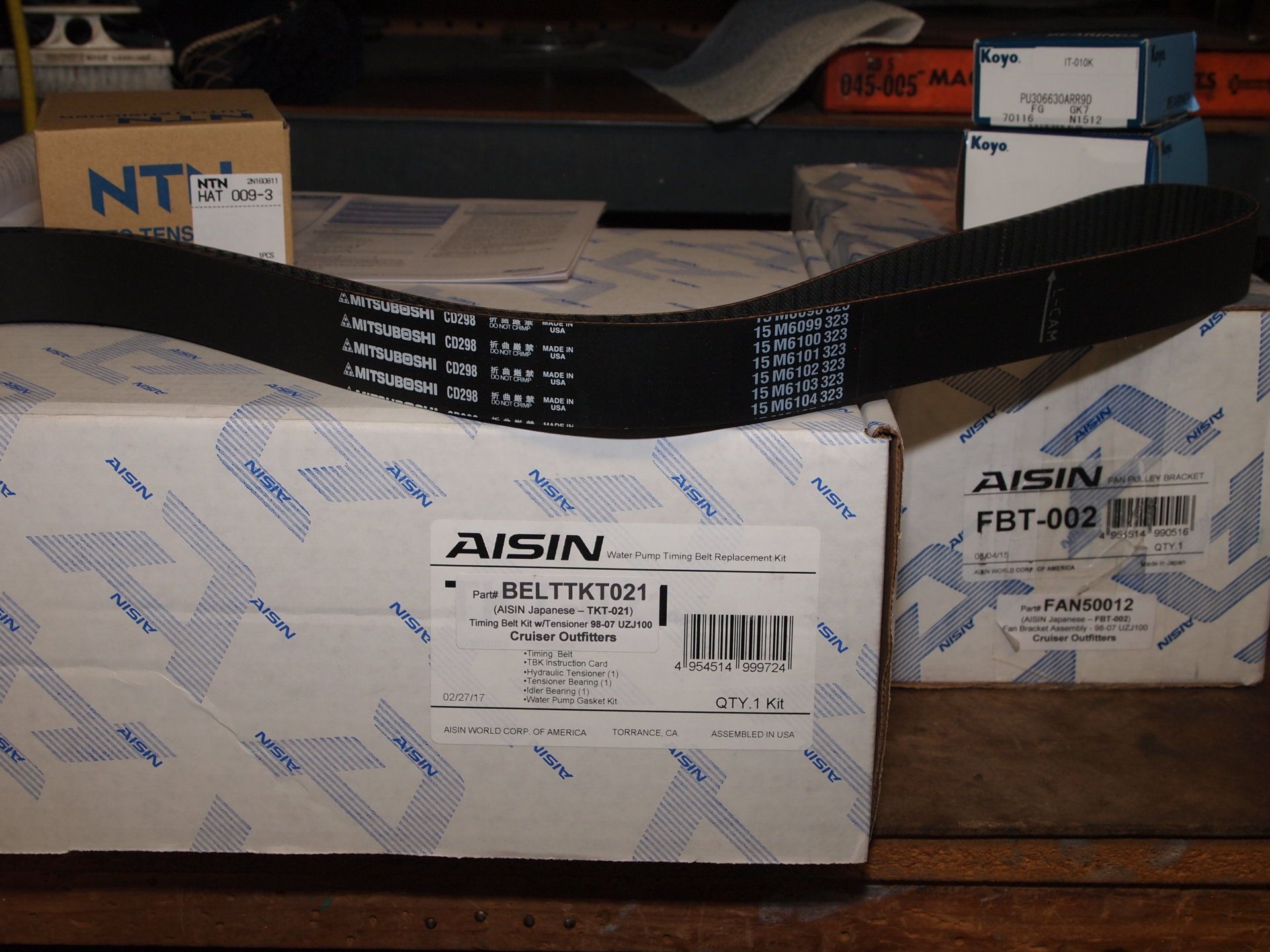

aftermarket belt? Asin tb kit = high pitch noise. I only do tb with oem only.
I've never listen to belt after install on a 2UZ. I have on other engine where belt tension is manually set (no hydraulic tensioner) with feeler gauge. When set to tight, sound similar. But that's the beauty of the hydraulic tensioner, it's self-adjusting. If you used the OEM or the OE Aisin kit from reputable source like @cruiseroutfit . You should have all good parts. Like the NTN tensioner

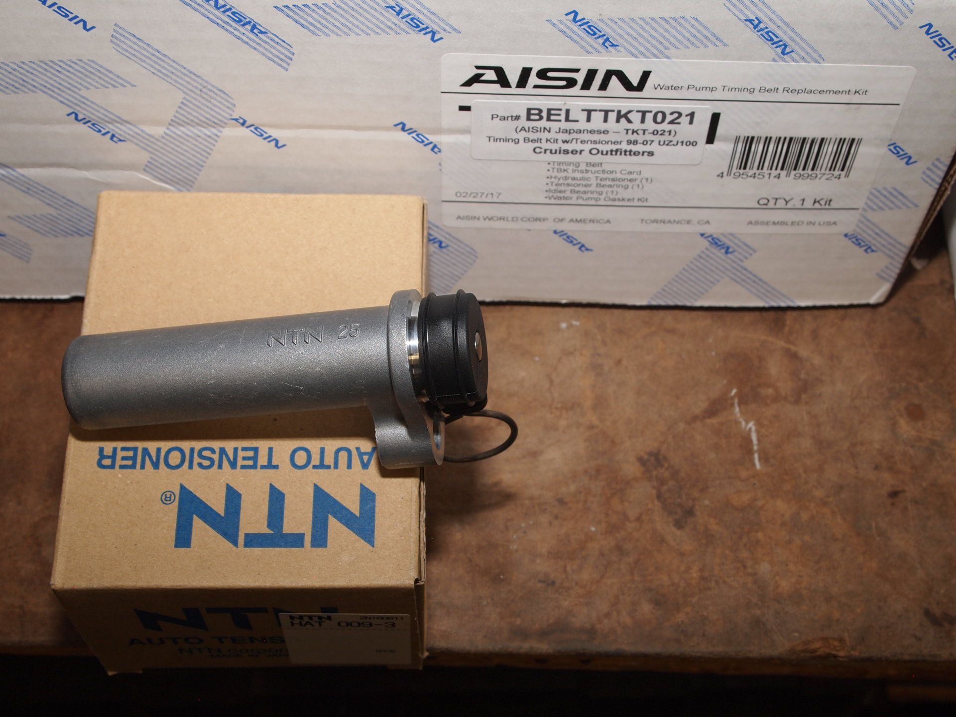

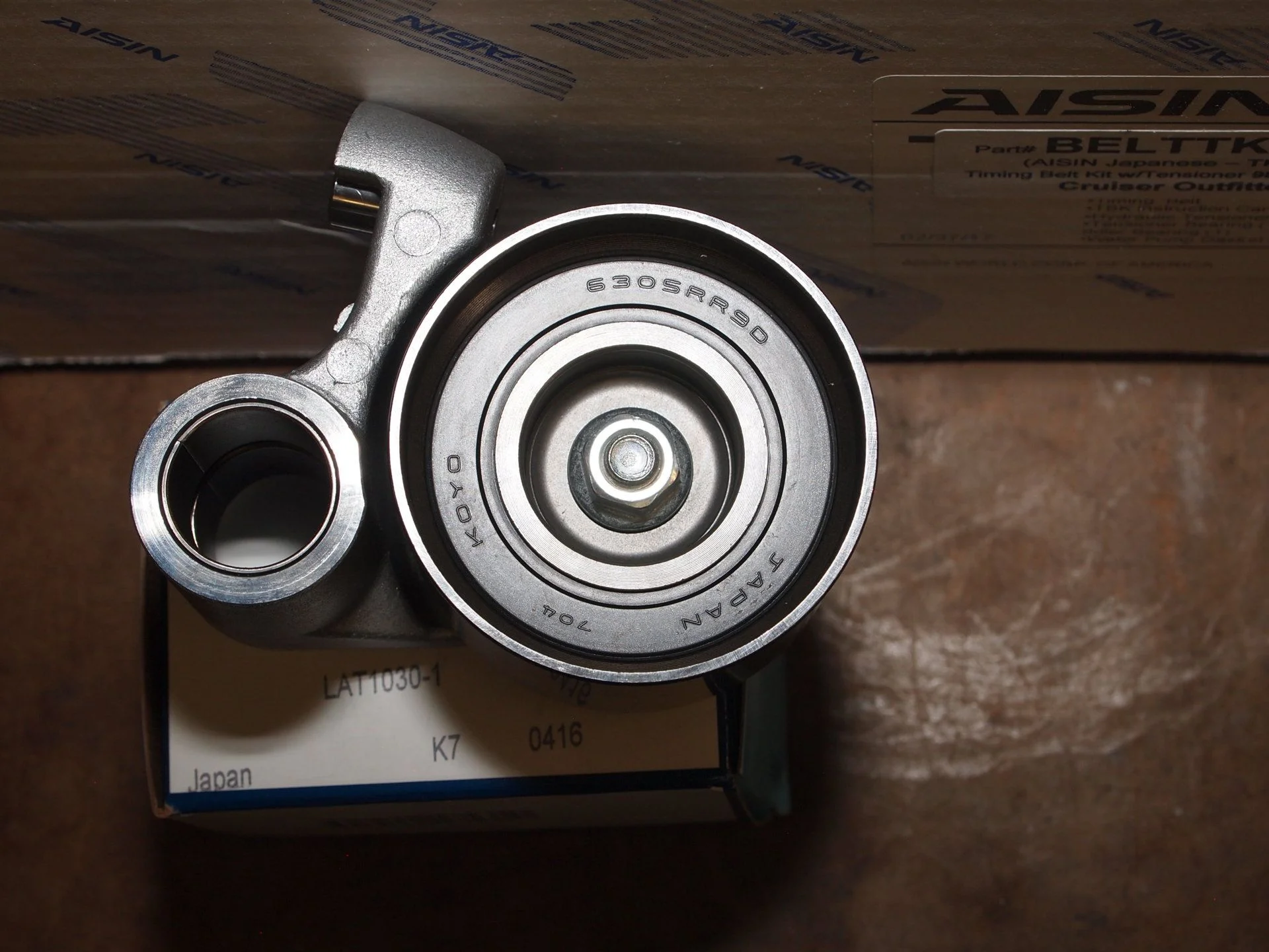

I have noticed, some Amazon seller substituting parts. I'll except KOYO or NSK bearings.

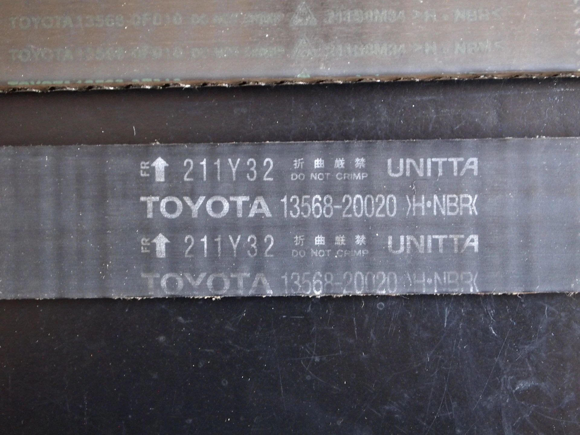

Mitsuboshi is a OE belt. Replacement OEM Toyota belt have NBR made in USA on them.

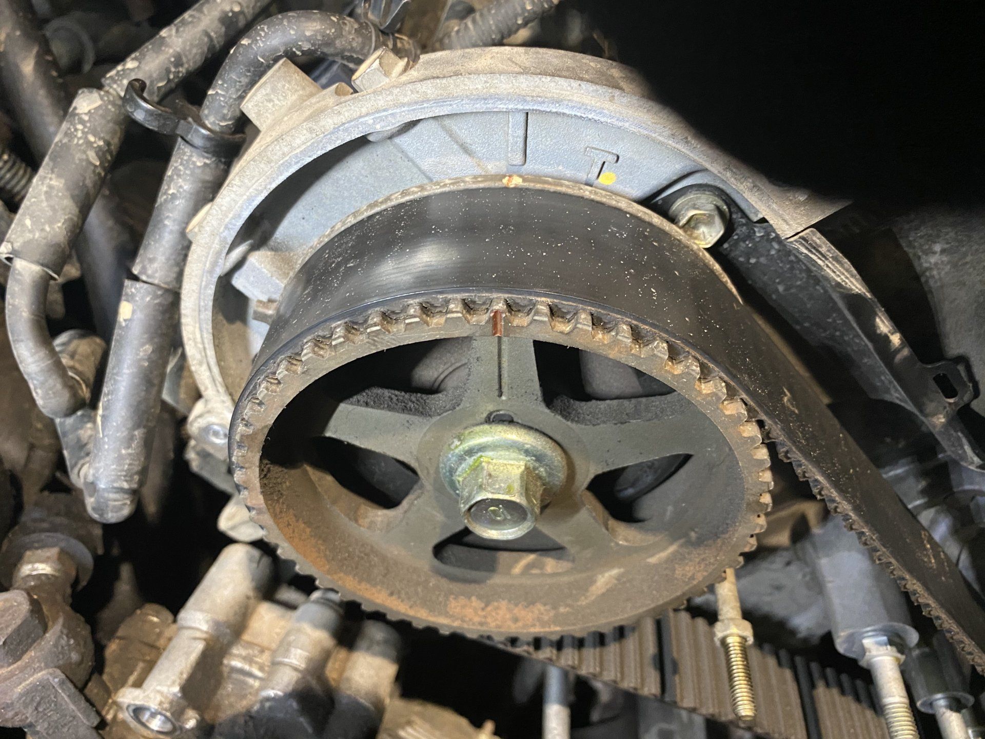

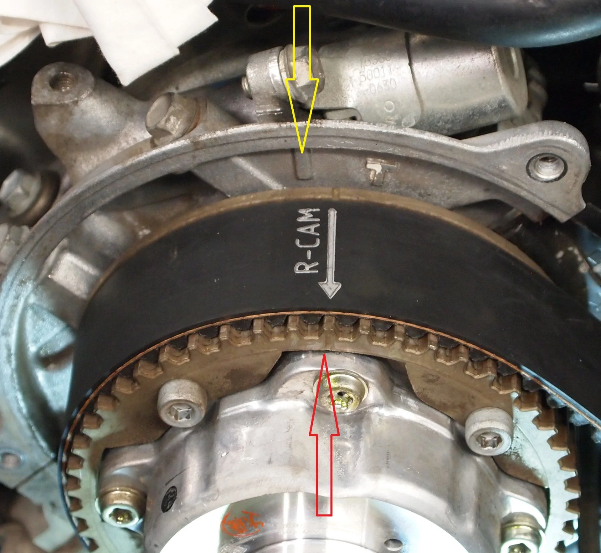

VVT engine here, but marks are the same in non VVT.

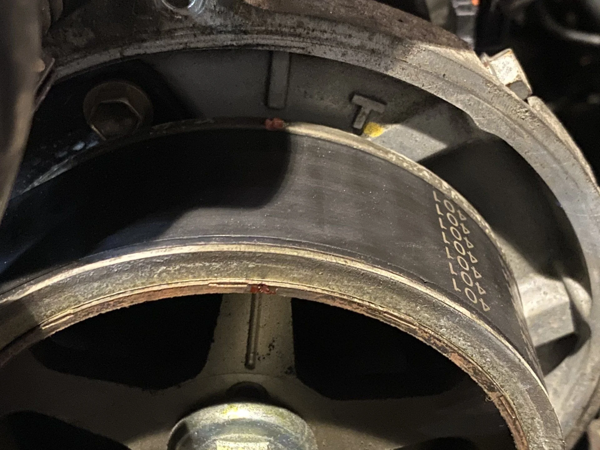

Provided timing marks lined up after two full revolution ("T" is not timing mark). Yellow arrow points to timing mark.

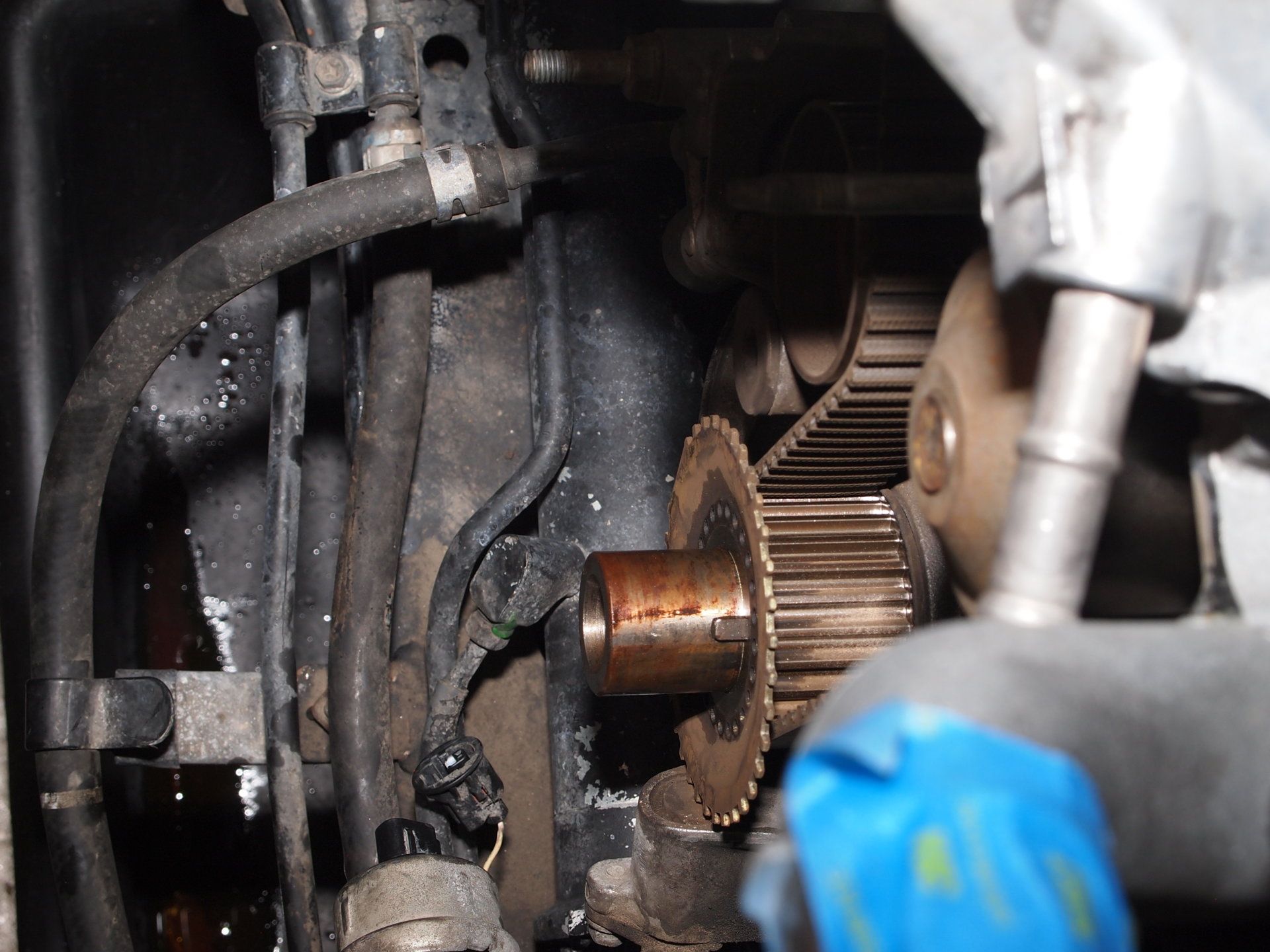

If you replaced the crankshaft oil seal, and seal not seated flush with oil pump case. Crank sprocket may ride on seal and make this sound.
Crankshaft position sensor plate, installed cup side out, so it does not ride on belt. I would think, sensor would not read and you'd have cranking but no start. But if plate bent out, it may start. One way to check if not sure. Pull PS (easiest) belt cover and inspect belt. If plate installed backward, then new belt will be frayed on outside edge from rubbing of plate.

I did order from amazon by following the link in otrams video to give him some credit for making a really good video. The tensioner was NTN, bearings were koyo and NSK, and the timing was belt Mitsuboshi. The only thing I noticed was the finish of the water pump was a little rough. The kit was sold by amazon which I made sure cause I had bad xp with 3rd party sellers on amazon.
I was going to order parts from cruiser outfitter but I rent somebodies garage to do my work and he changed the dates on me so I had to go the amazon route to get the parts before the window of the garage availability closed.

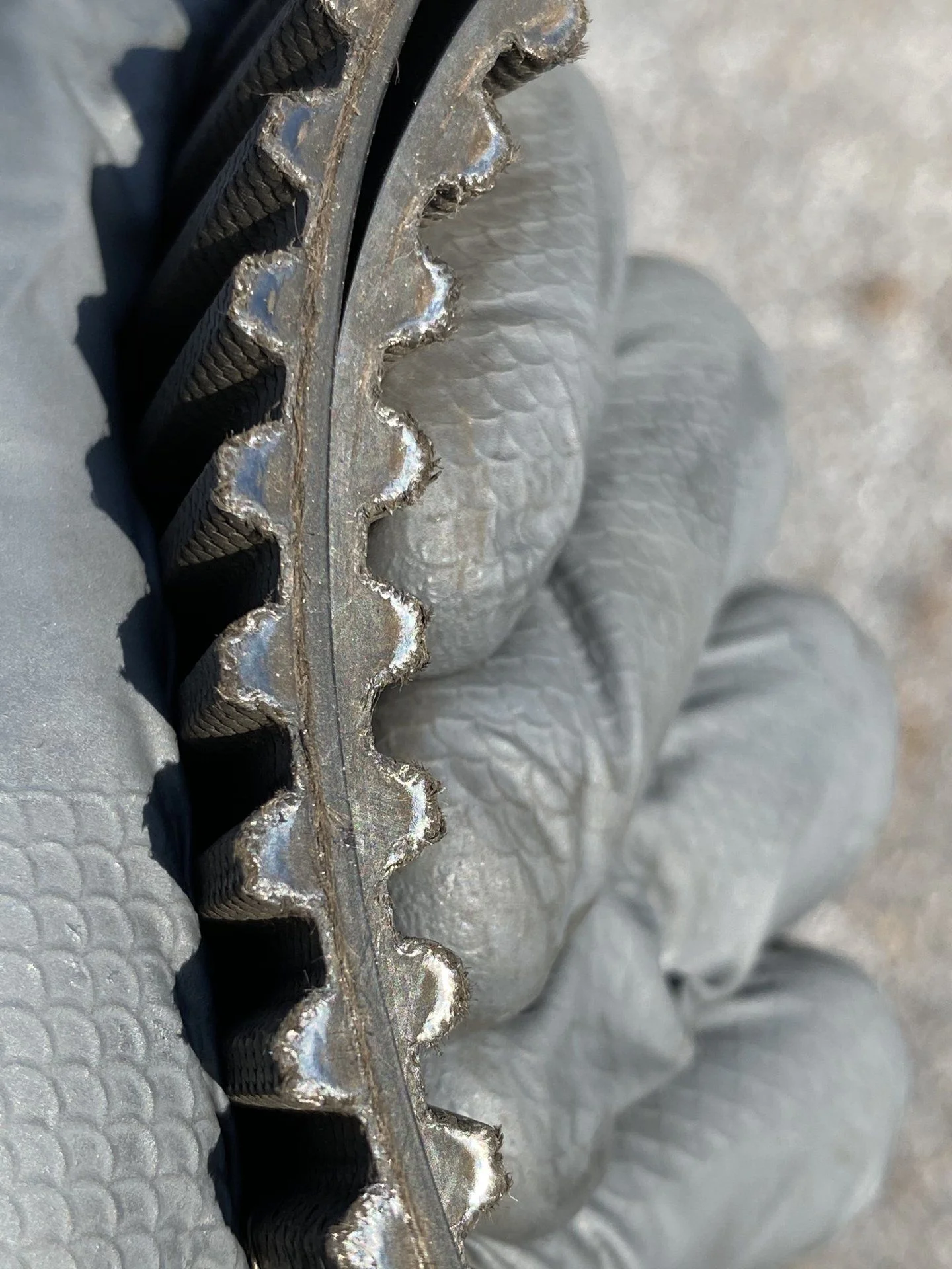

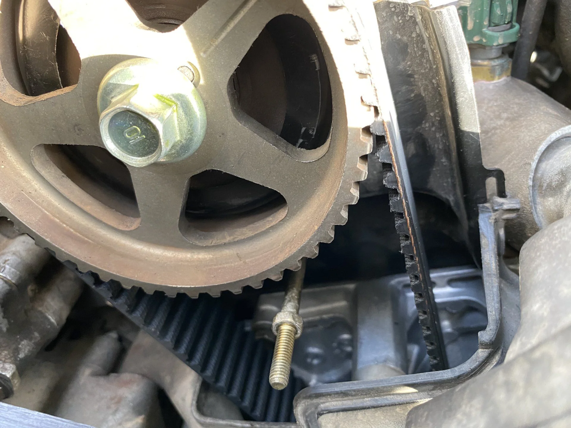

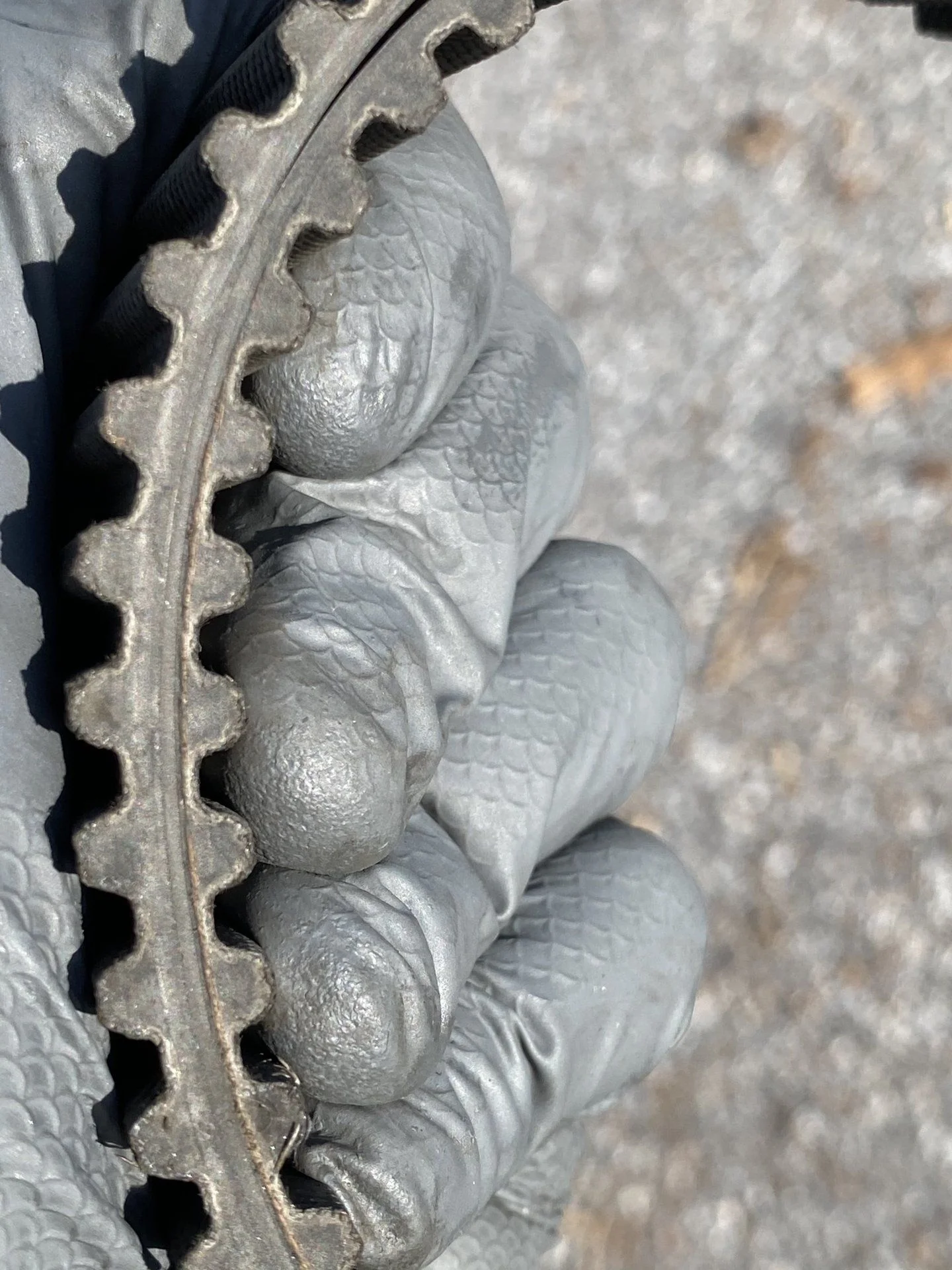

I think the belt is rubbing with something but I am not sure what. I found evidence of rub on the old belt which was Toyota belt changed at 90000 miles by Lexus dealer. I placed the crank sensor like it should, is it possible that it was bent a by some one in past ? Is it easy to change out ?
You've "@210" at top of post #5. I hope that not coolant temp?
Do you know if the worn side of belt was facing out away (front) from engine?
I've a few pictures of used belts, but only fronts & tops. They are not worm like your belt.
Here one that side of belt aren't visible clearly. In it I see rear appears it may be a bit frayed.
You need to pull lower cover to get at sensor plate, which everything is in the way. If your old belt is frayed at front, you may be able to see sensor plate and belt. I've not tired this; But, if crank sensor pulled, a small snake drain camera or mirror, and you may get a peak at senor plate. You can also use a snake camera from above. Just pulling the PS top cover you can see the belt, as I pictured above. Then run the snake camera down inside. I picked up a snake camera off Amazon for $30. Wifi to my iphone for viewing. Not great but usefully.

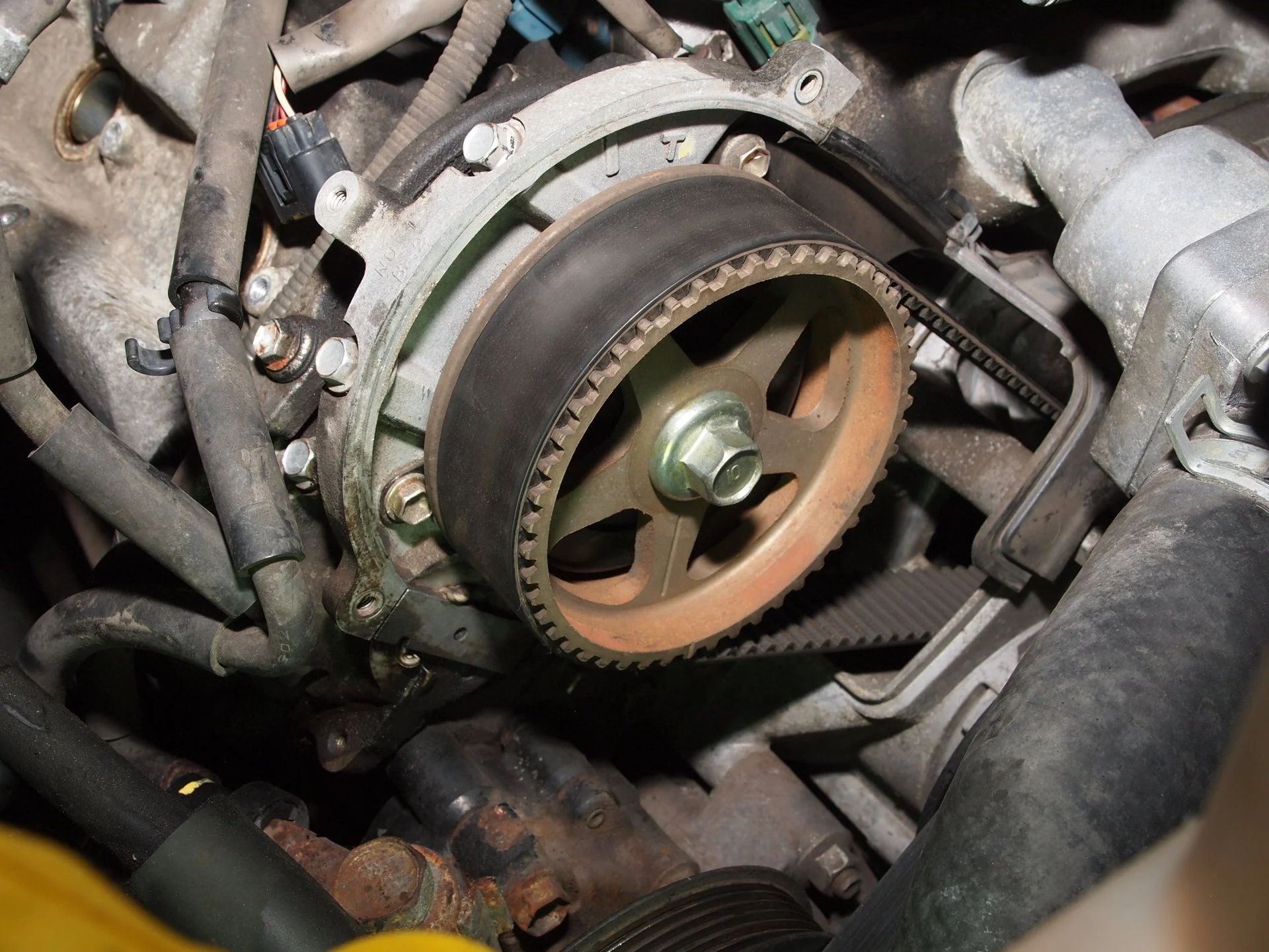

I took some pictures before the install and the worn side is in the front. The marks are visible on the PS cam pulley.
The snake camera is a great idea and I will try that. I do have one but it can be used with laptops only. I used to check CATs and what I found was not good PS side honey comb 70% blocked but I am getting a code for driver side. Strange but a problem for another time :).
I will check the techstream tomorrow to check for fuel trims. The intake gaskets are all new I changed them when the starter failed, hoses are on my list, I have changed the PCV hose so far with the PCV valve.
These are the pictures I have pre belt removal, the marks are visible on the front of the belt. I should mention that I did not remove my belt at the position in the picture I went 50 degrees ahead just like FSM said. I don't have after pictures because I was on Face time with a friend showing him timing marks to confirm when I dropped my phone in the coolant bucket under the engine.
I can think of only 3 points the belt is touched at front; water pump pulley, LH cam sprocket and crank sprocket sensor plate.
The above picture resolution is to low, and I can't zoom in. So I can't see.
But old belt was frayed on front. Then one possibility is crank sensor plate was/is somehow bent.
The crank pulley holding tool commonly sold, has bolts included that are to long. If bolts not shimmed out, the bolt run in to far and can damage the plastic cover. This could also bend the sensor plate. In that case you would have seen marks on lower cover.
Someone may have torqued down the crank bolt, with sensor plate on backward. Then subsequent corrected, reinstalled damaged sensor plate. Bent sensor plate could give a slightly erroneous signal to the ECM by way of crank position sensor, effecting timing just a hair. Timing can affect temp.

If new belt frayed, points to crank sensor plate.

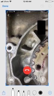

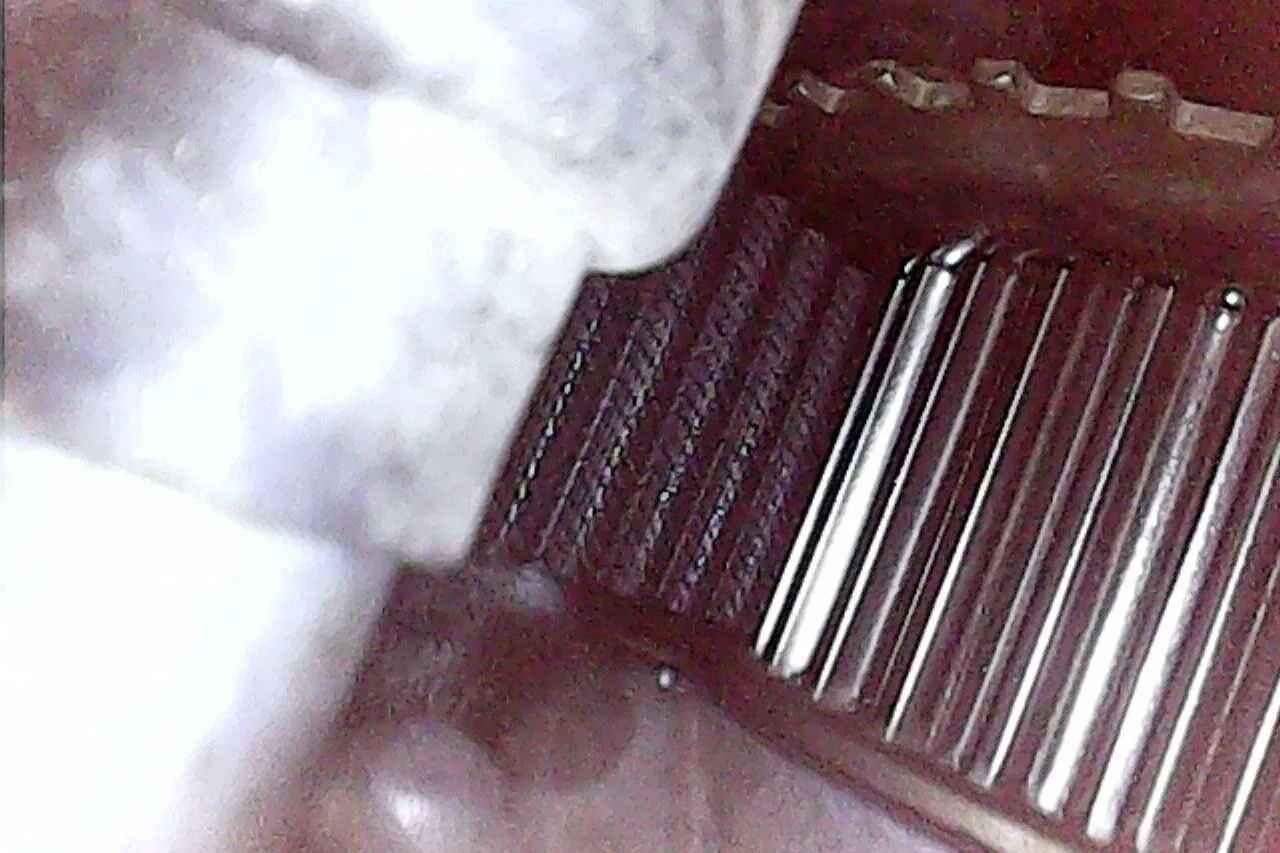

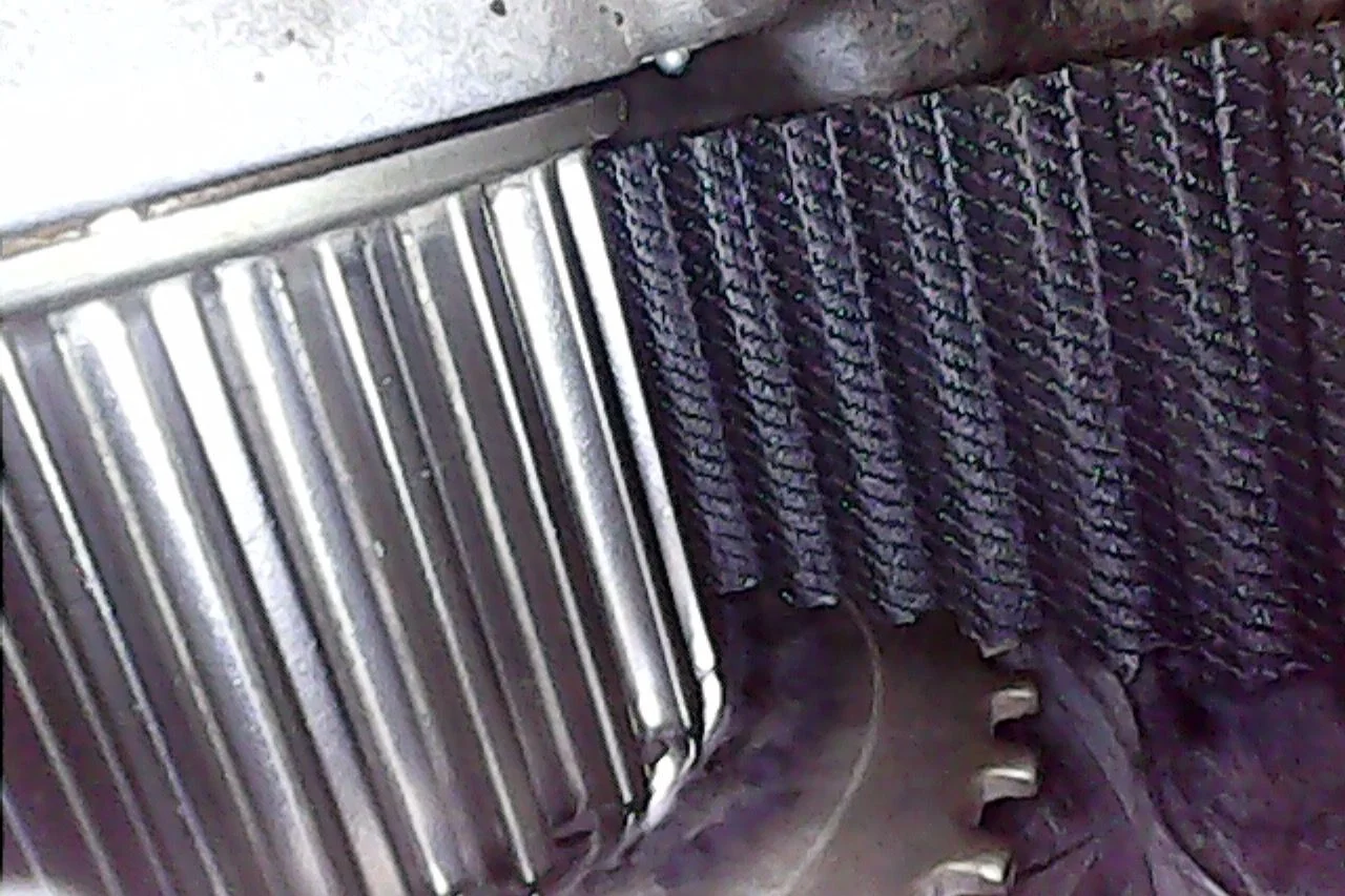

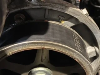

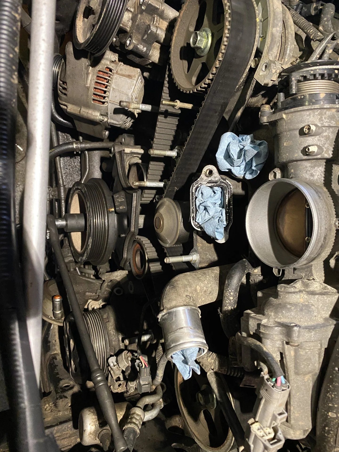

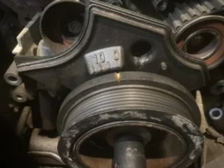

Just snaked a camera through the passenger timing cover and it does not look like the belt is rubbing against the crank pulley. I do see a slight mark on the new belt but I am not to sure where it is rubbing. I am going to drive it from some time and will report back hopefully it will go away with time.
