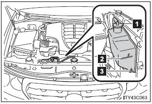

The coolant in the white plastic reservoir is low. It's not on L but near it. I am not sure about the refrigerant.
Somewhere between the two coolant lines is normal. It fluctuates during use

I checked the coolant when the car was warmed up giving me a higher reading on the reservoir. If the coolant is low or absent when cold then there is not enough coolant to move through the heater core.

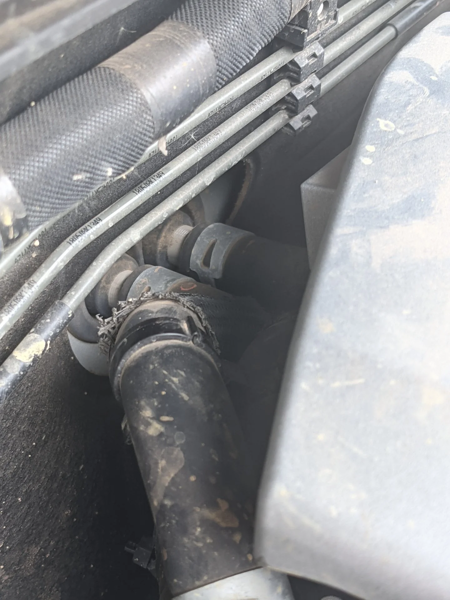

If you want a little confirmation open the hood and check whether the heater lines on the passenger side of the engine bay get hot as the engine warms up from cold. They should get warm water pretty quickly, probably even before you’d feel the radiator warming up, as the system is set up to prioritize the heater cores for passenger comfort in cold weather.
If those lines get hot you have plenty of hot water, the issue is the doors in the dash not actually allowing air through the core. My gut is that’s the issue here, or maybe a vent temp sensor going bad.

Both hoses are warm. The far rear vents in the ceiling are warm, front and second row vents run cold. The issue then is the doors in the dash or heat sensor? Thoughts on next steps?
