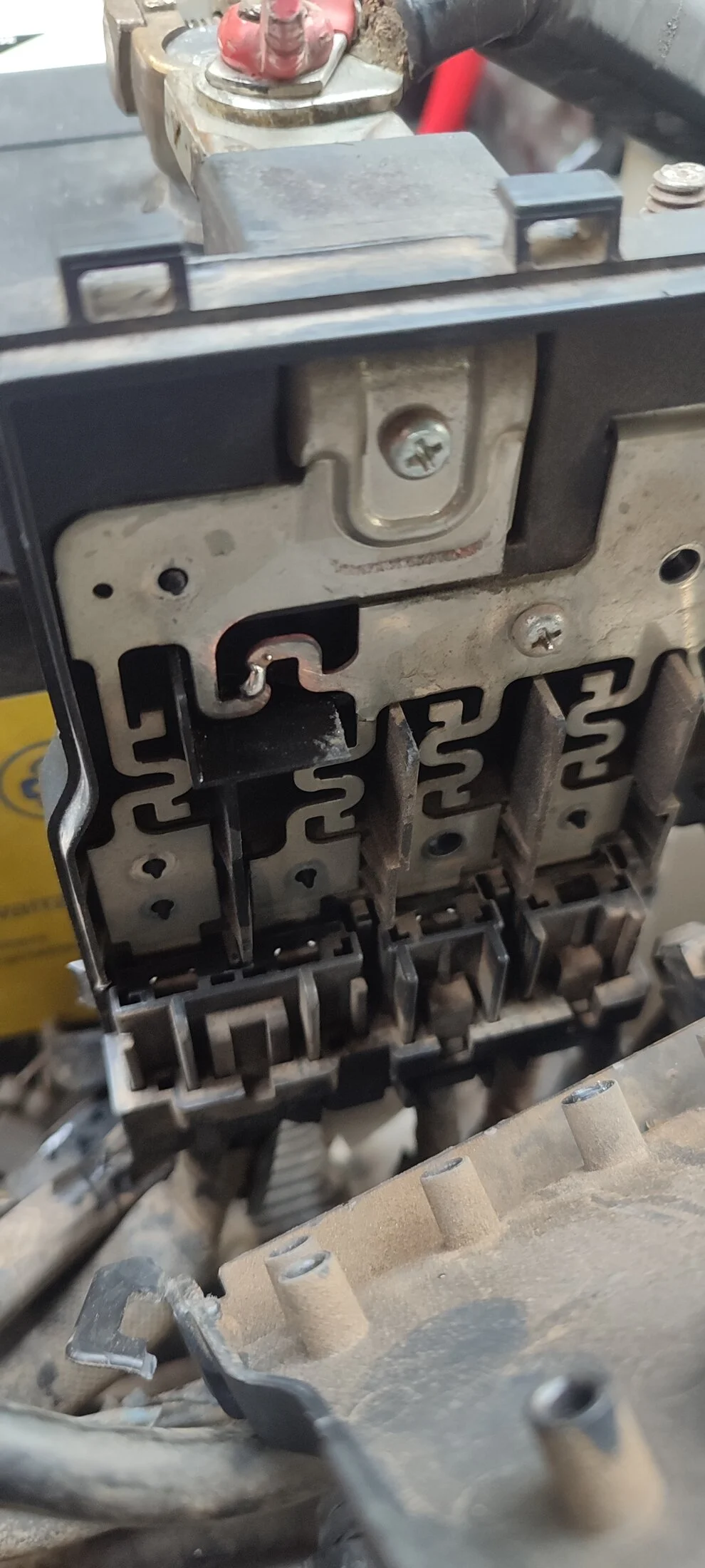

Fusible link?
Fusible link?
Thanks mate, just about to check that this morning once I wake up, as I ran out of time yesterday. I'll report back once I get into it 👍
*Update - Yessss! Looks like it might be an easy fix after all. Is it possible and how naughty is it to solder this break in the fuse until I get a replacement next week? I'm guessing it won't affect the functioning of the fuse as the fuse will break either side of the repair in on over voltage situation ? I've got the most important week of the year for me next week and cannot be without a car 😵‍💫
So... I did the naughty thing and overlapped each side of the break using a flat head screw driver to carefully bend them and then clean with sand paper, flux + soldered them together. Started the car and looks like everything is back working again. What a bloody relief haha. I'll be sure to replace the FL asap! Cheers
Not that anyone probably cares but for the sake of closing this post off, I bought a new fusible link for AUD$80 and job is done, I now have a working emergency spare 👍
great temp fix
Thanks man 🤙
Just thinking about this further, if you do plan to do this temp fix, know that the heat from the solder iron began melting the fuse link. So you need to be a bit skillful with getting the solder on there quick while managing the heat accordingly. If recommend making sure the solder iron is real hot and maybe even pre loaded with some solder. Flux helps immensely but I get not everyone will have flux out on the tracks.
