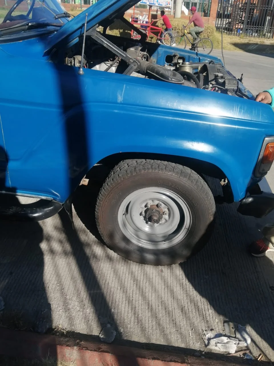

Just picked up an 82' FJ60 in Central America and realized it doesn't have front locking hubs or disc brakes.
Previous owner said he bought it like that from factory.
Front hubs seem to be locked at all times as well.
Anyone know if this was one of the options for some of these older models?
I have a BJ40 and it looks like they share the same front axle. Might do a Toyota Minitruck front disc conversion, unless there are better options out there.
pretty normal for early year South American Market 40's and 60's
