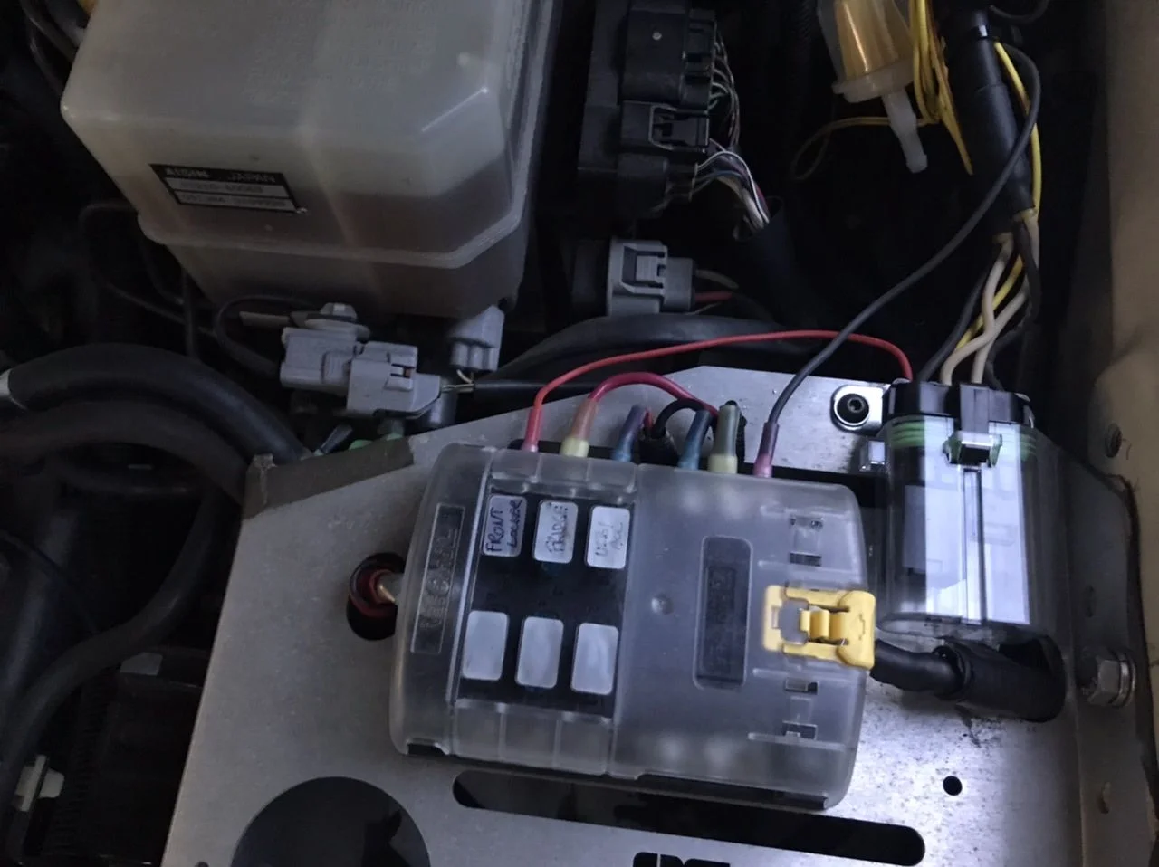

wiring (Impressive kit with relay and a loooong and beefy harness) for theHarrop e-locker arrived on Saturday and I did some wiring.

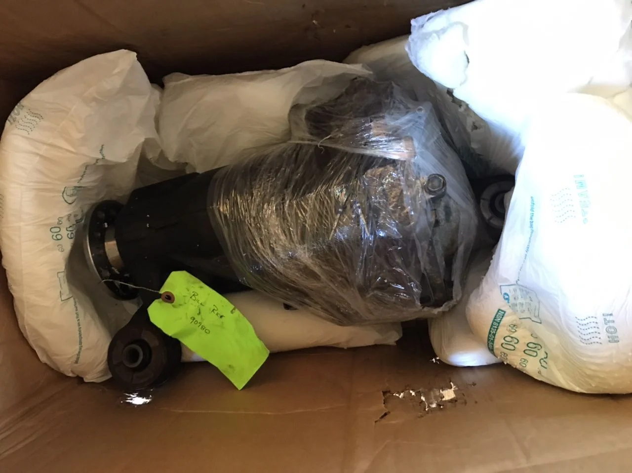

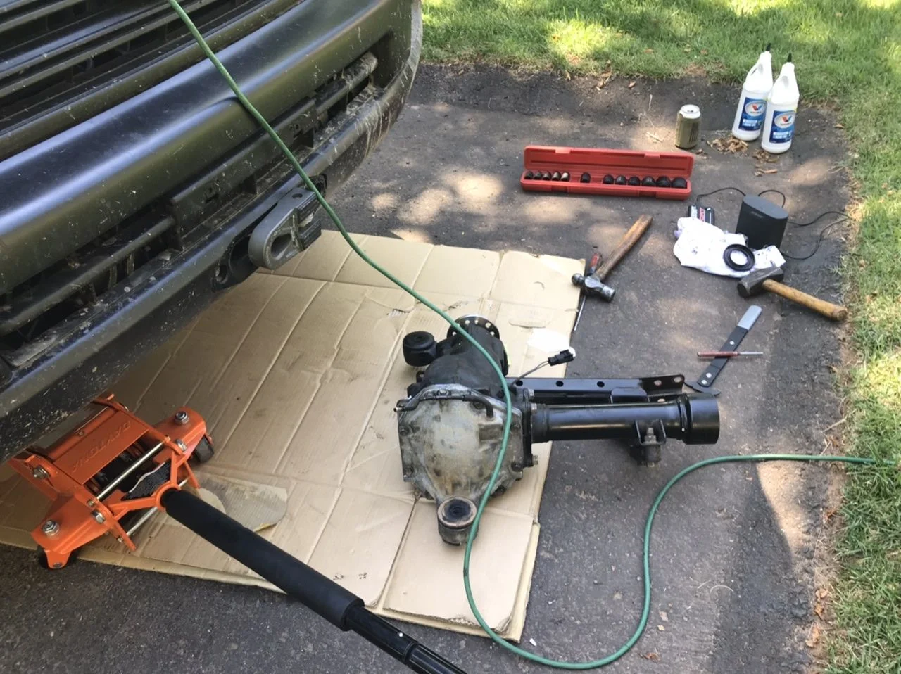

Monday morning the diff, with new R&P and e-locker installed, arrived.

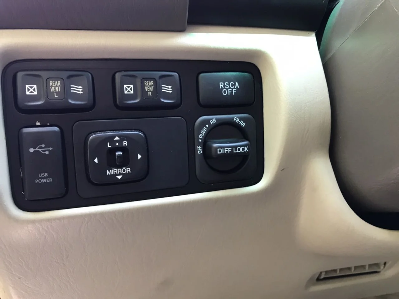

Got everything back together and tested the locker last night—everything works!
