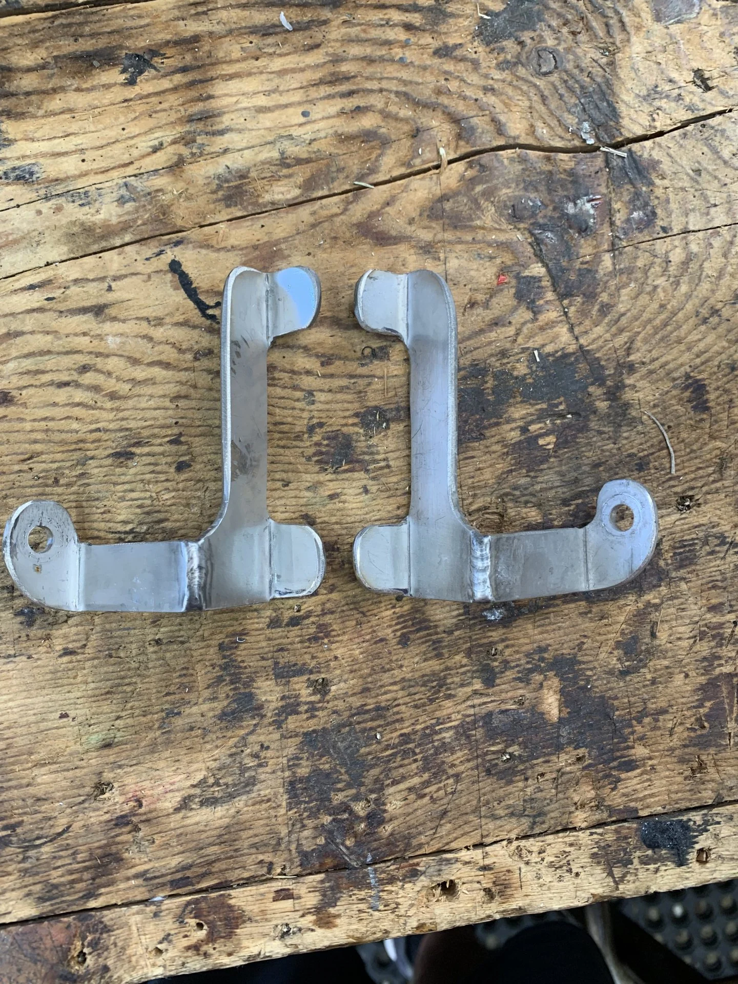

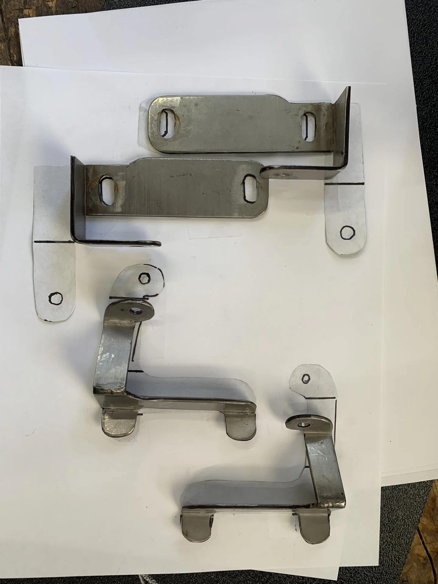

Any shop can make them. I just made a cardboard template and they made them for me. They're costly though since you pay by the hour. This one off set cost $125. I still have the ones I had made, and the BD lights, sitting on a shelf in the garage.

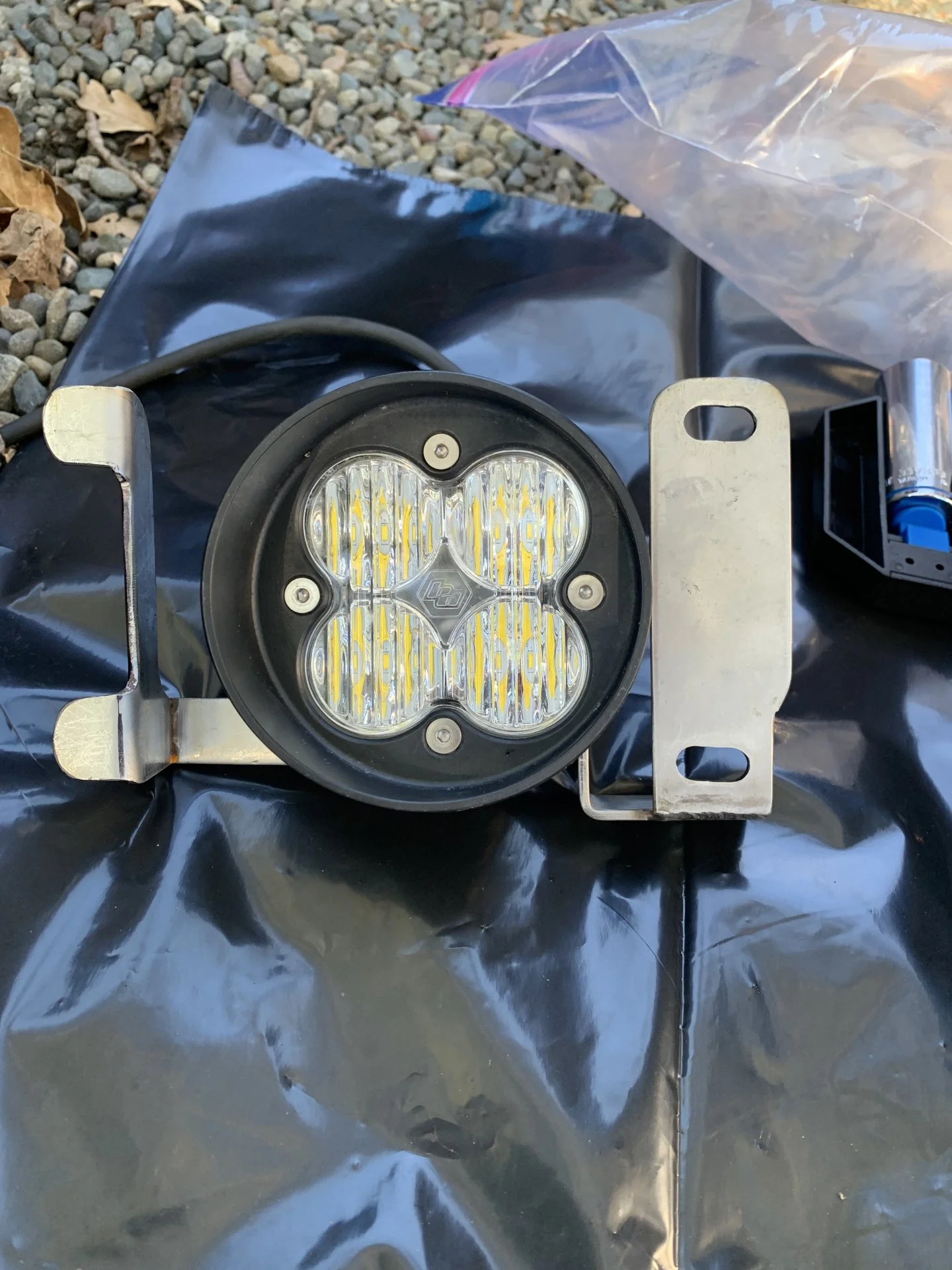

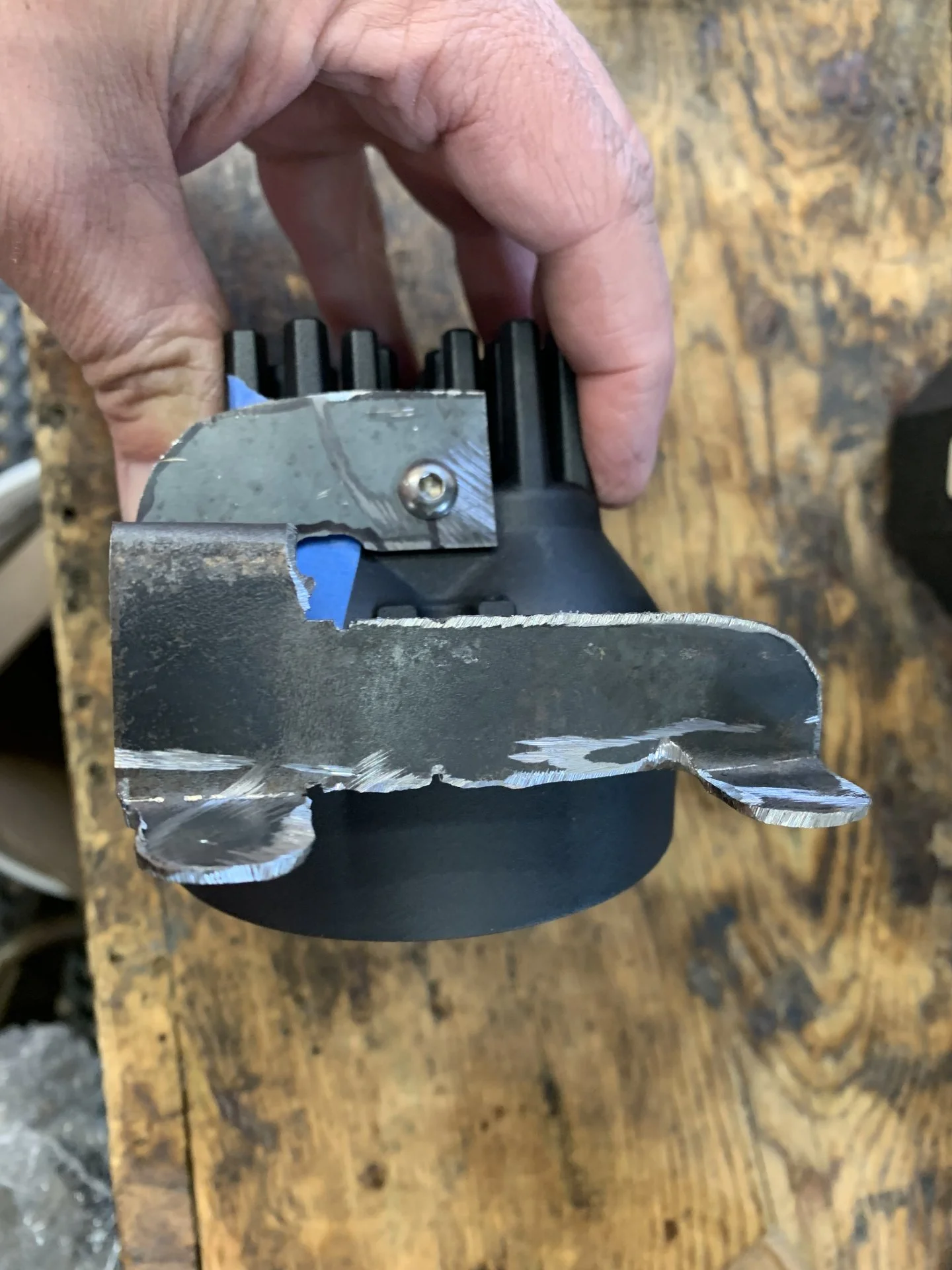

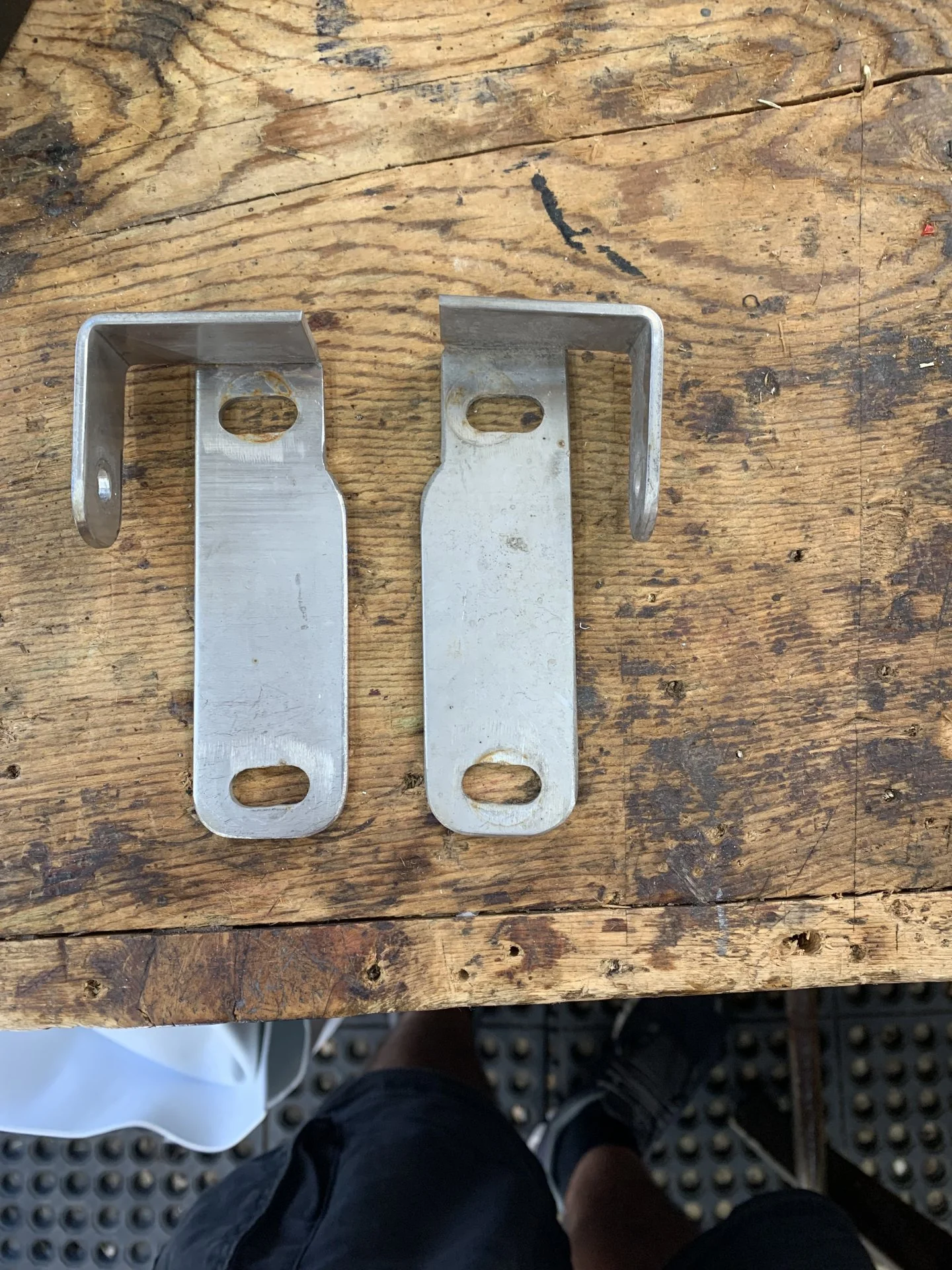

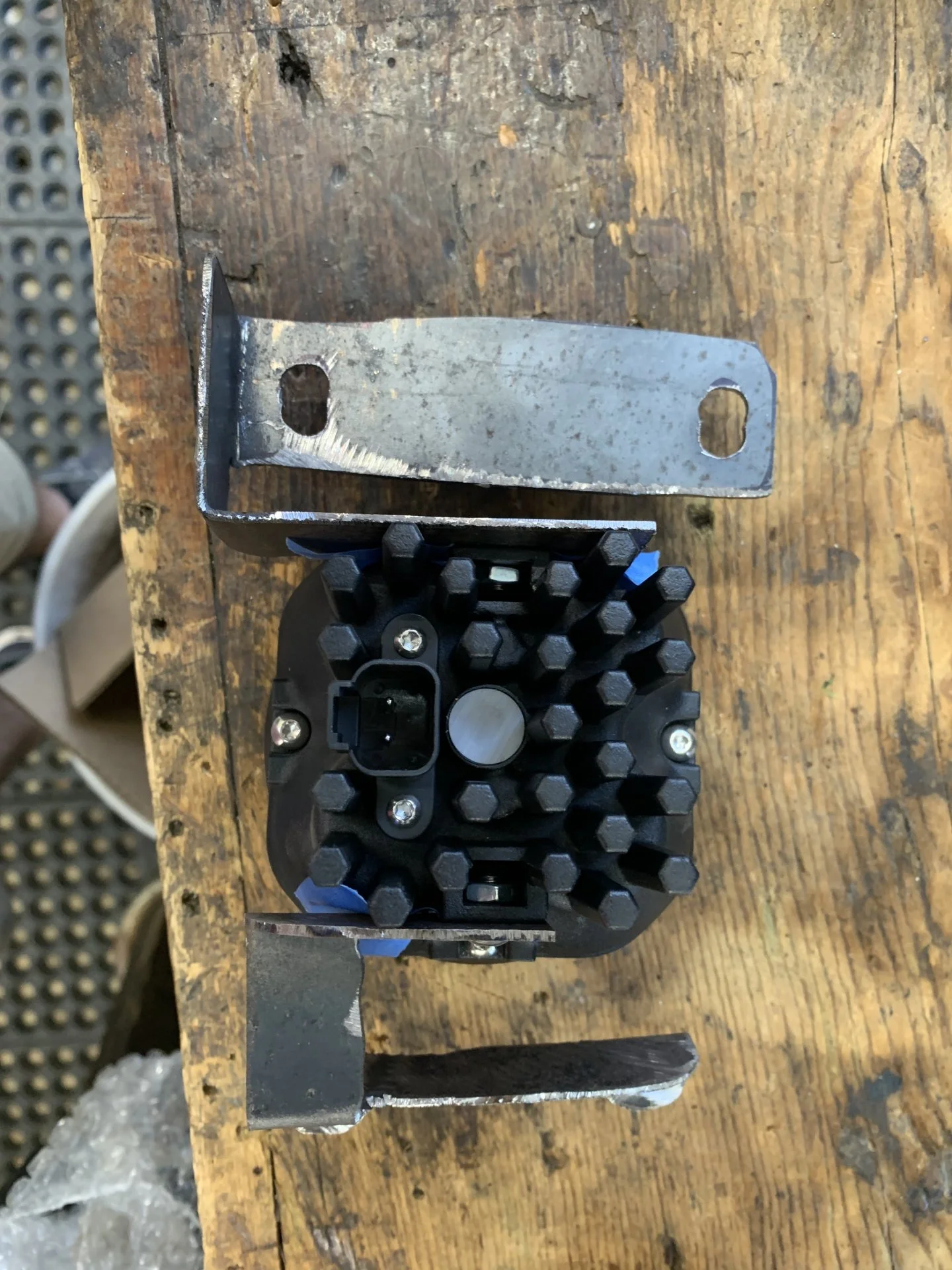

Special Thanks to @CharlieS - I purchased the brackets he had made and the BD fogs and installed them on my '15 this past weekend. With permission, I traced the brackets that he had made and have posted a PDF of the bracket design. These fit BD lights, I made another set of brackets that fit Diode Dynamics and will post them to this thread too. Hopefully this helps others with the brackets to upgrade to LED fogs. In addition to the brackets and lights, you also need a wiring harness from Amazon for the plugs to plug into the factory wiring.

Factory tabs are .22" thick

Brackets for Diode Dynamics lights - the mounting holes are centered on the DD lights vs. at the bottom of the light for the BD lights. The brackets can be cleaned up a bit, since I didn't use the DD lights, I just made a quick set of brackets for the pattern.
