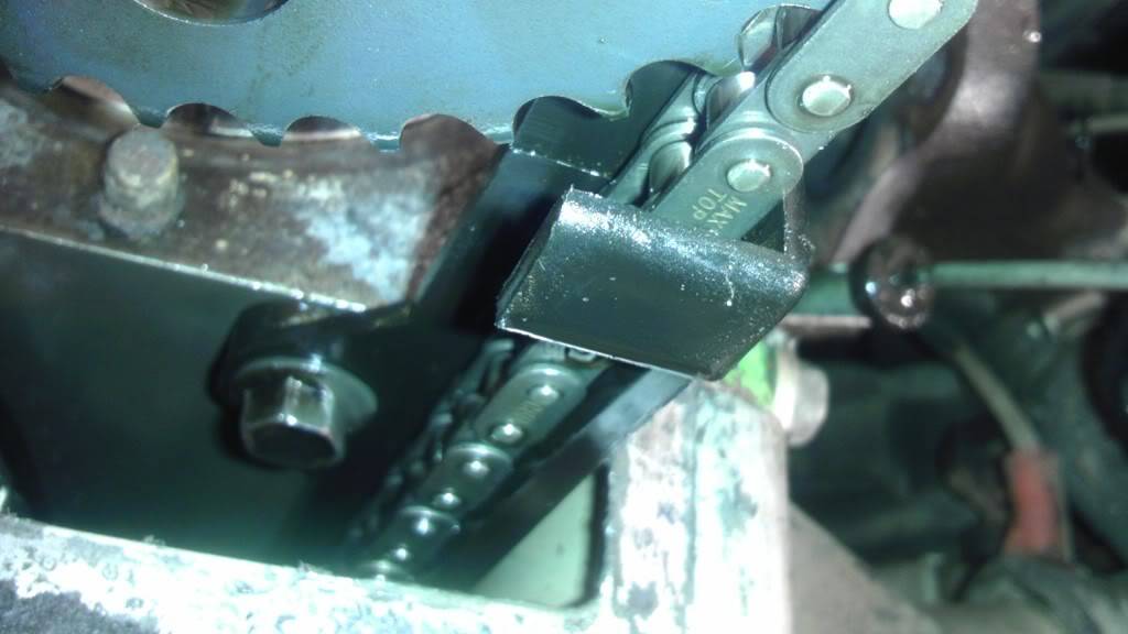

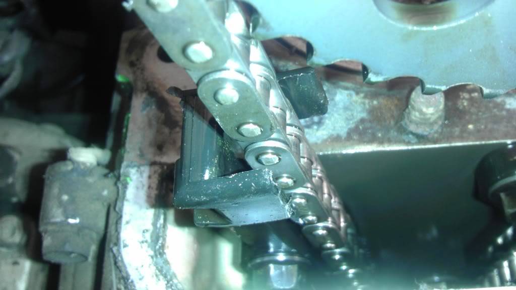

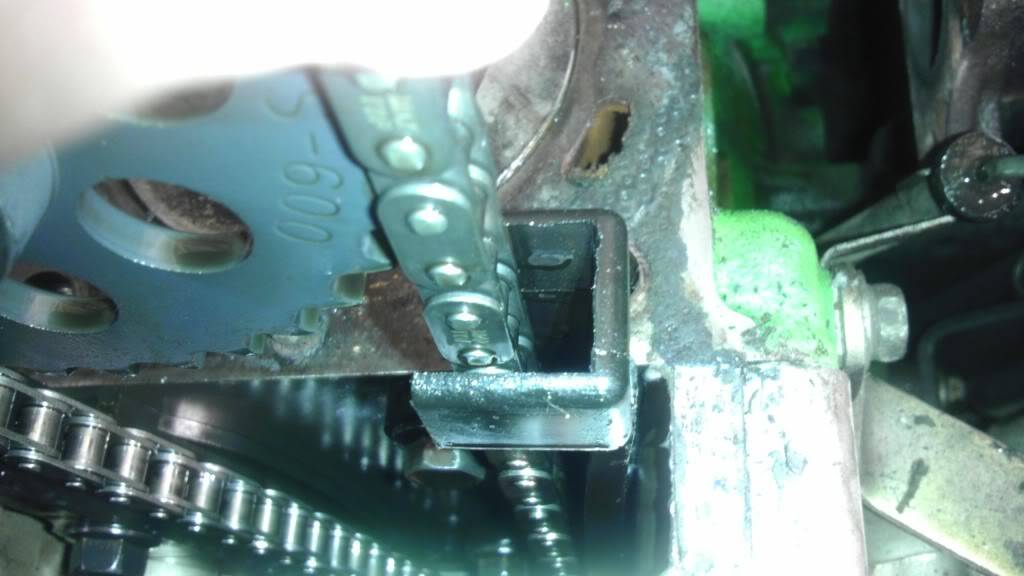

Shoot, you have the front cover off, might as well check the slack guides and t-chain for slack/wear. The guides were plastic in certain/early years and not are always interchangable (different blocks) with a 22r-e. Check that engine code/stamp and head code/stamp to make sure you are buying and dealing with parts for that block/head mounted in the truck. Only saying and not knowing, because the history is somewhat a mystery and wouldn't want to be revisiting an area after fixing it ... my $.02 :meh:
The chain is supprisingly tight he must have done it with the rebuild, I will double check the plastic guides with a flashlight but from a glance they looked better the last set I saw... 10 years ago.
Thanks for the tips JJ!
Sure thing; if they are plastic and look brittle/worn then you know whats up. Otherwise, if he addressed the t-chain, hopefully the guides were good to go at that time and still are.

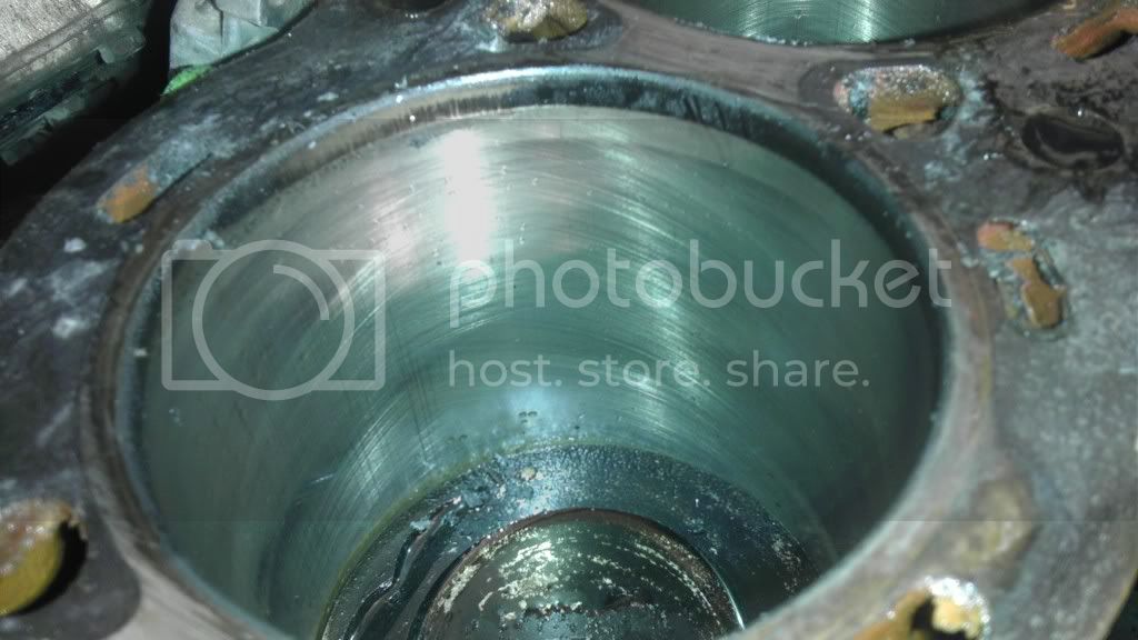

We weren't able to get started till close to 5 tonight, a little later then I had hoped but we finished up around 7:30 and took her for a test drive, everything went well, most of the time seemed spent scraping the dang block. We had to do the timing by ear because I forgot my timing light but easy enough to come back to when we change/flush the oil.
What do you guys think of these cylinder walls? not even broke in yet? some picks of the guide too, didn't even look worn.
(excuse the water dripping down and the s*** at the bottom.

Looks like it was just honed. If the chain is tight and the guides are good to go, run it!
