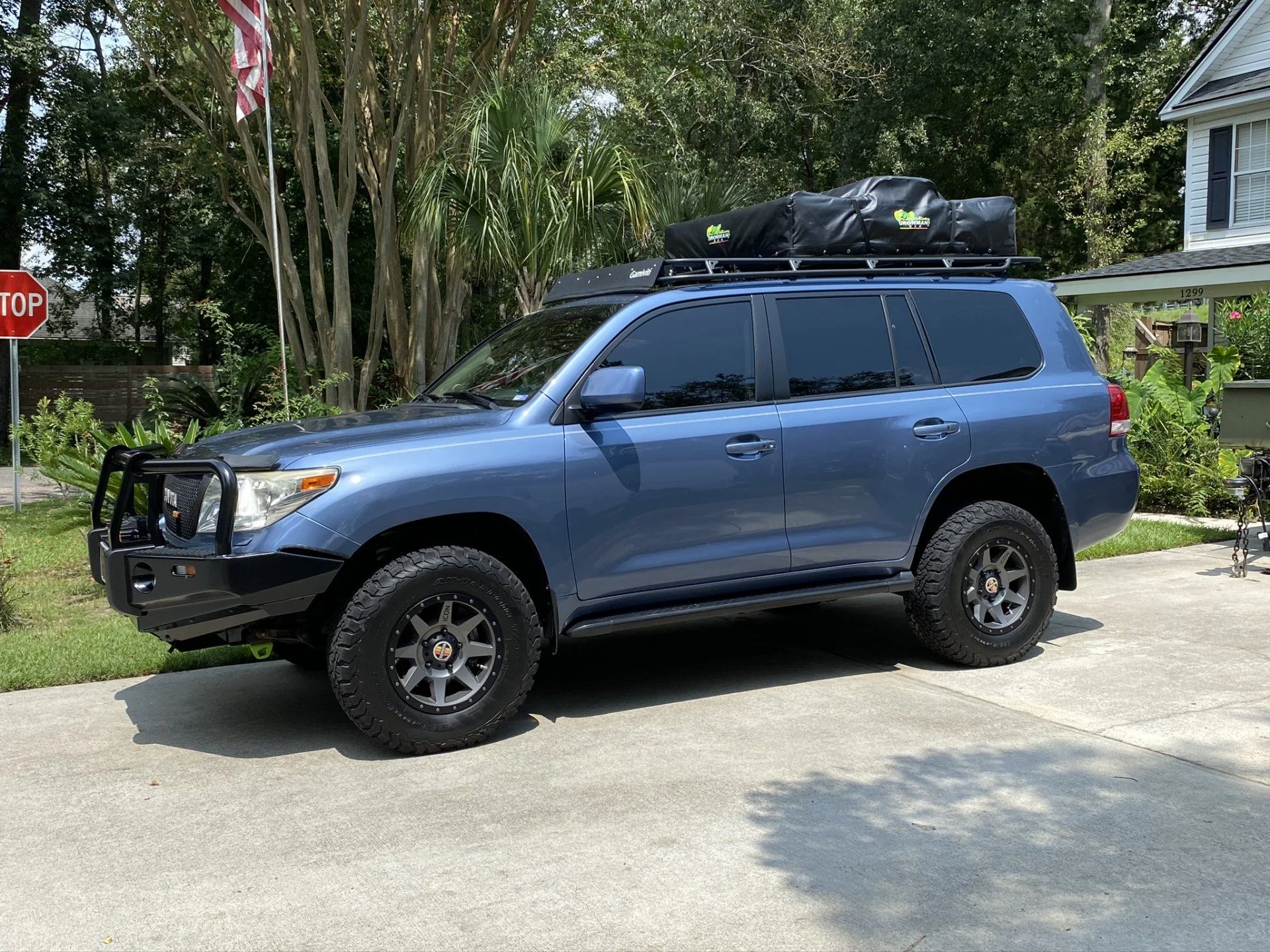

4) View attachment 2465969
Thank you, Charlie! Appreciate the feedback. Are you running 285/60/18's?
Probably about 8k miles since I got the lift on. Got the truck in December with 111k and I’ll break 125K in the next day or two. I didn’t make a note of mileage when we put the lift on think it was around March or so. I like the suspension a lot. I like that it took some of the sway out and if you have to emergency brake it doesn’t nose dive like it did with the stock suspension. Even with the lift and tires it feels just as comfortable to me as it did when I drove it home from Tennessee when I bought it. Put the bumper on in August. I have noticed the front settle a little with the extra weight of the bumper and the 12k winch. It’s not bad though. I don’t mind a little forward rake. If need be I can always get a set of the factory spacers for the front to get it back up a little. When I pull my 40 on a trailer it levels out and pulls really nice. The main reason I got the 200 was to DD and tow the 40 anyway. But... it’s a Land Cruiser and I couldn’t help myself so it got a few Mods and gets wheeled a little.
