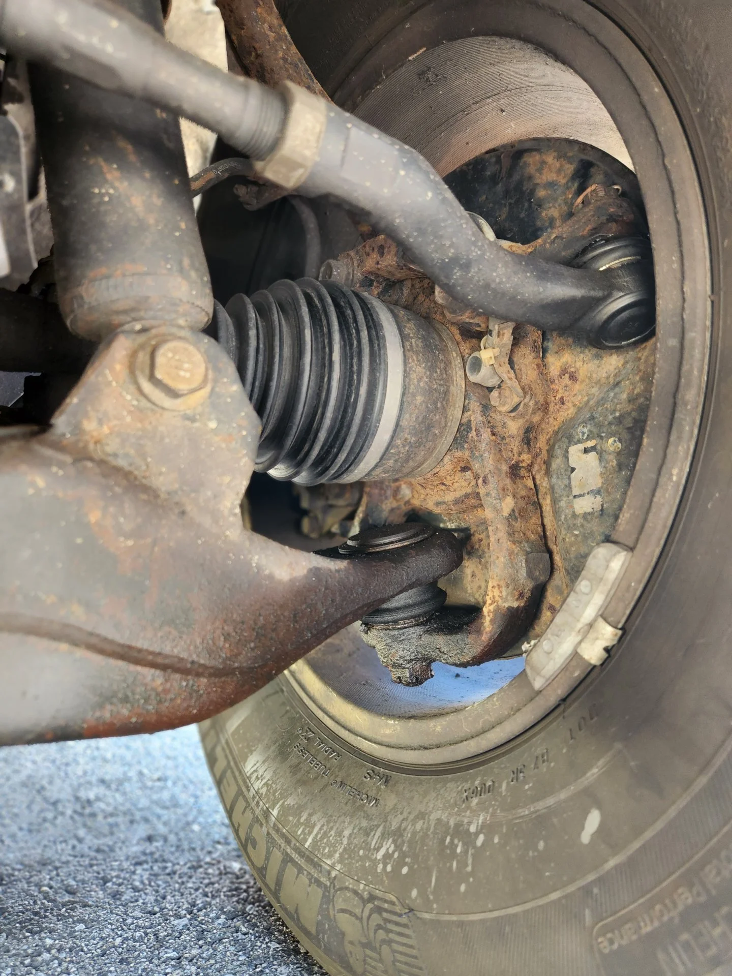

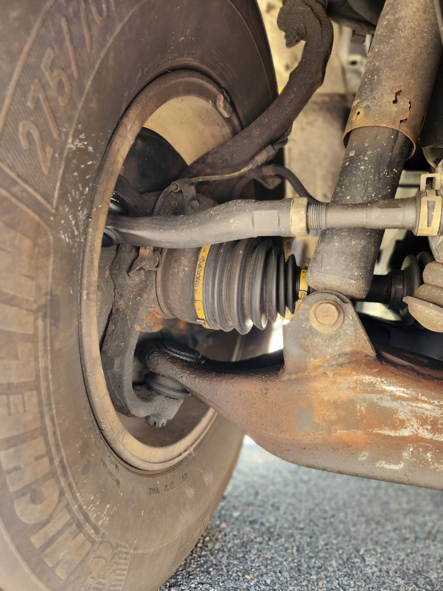

In the meantime, here are pictures of the cv boot on both sides. Looks dry, but driver side definitely looks like something leaked into the ball joint and tires. Maybe previous owner cleaned it up?
Edit: Actually...I got those tires recently and the grease marks are definitely new.

Normally the boots tear and sling grease everywhere. At least that’s what happened to both my 4Rs. I threw aftermarket’s on one and 3 years later I’m pretty sure I can hear it click. The Yodas i rebooted with 180k are smooth on my second 4R

Got it. Upon a closer look... It looks like black oil and not grease. My brake fluid is clear so not that... Maybe the hydraulic shock is leaking. No surprise there but I'll look more to confirm later.
