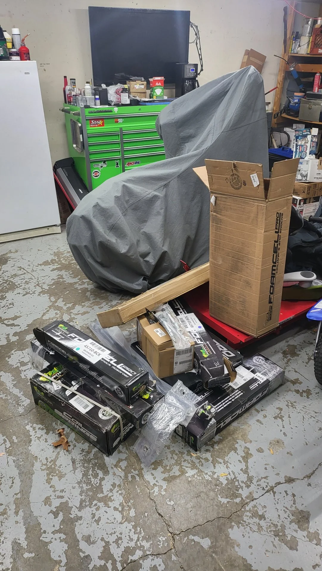

All the IronMan 4X4 Goodies getting ready to raise the bar! There are quite a few parts like panhard bar and swaybar extensions that I'm still trying to understand how to get these dialed in correctly. She's going straight to a alignment shop either way.
For the panhard you need either the EIM Keith (weld in) or Dr KDSS (bolt in) bracket to correct the angle. Adjustables are not the answer as they simply change the geometry and don't fix the issue.
