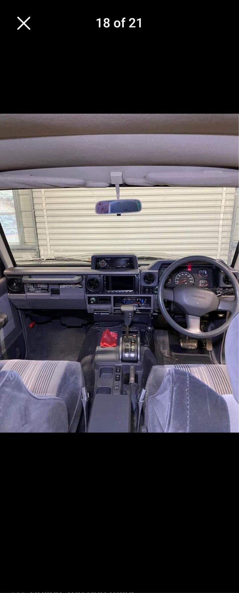

Hello all, I'm looking at a 1990 LJ78 Land Cruiser that I found on Marketplace with 197k miles (318k km). The seller is asking $11,500 USD and from his pictures, it appears to be in decent condition. However, I'm brand new to the world of Land Cruiser's and know nothing about what to look for. The truck was originally purchased in Japan before it was sent to British Columbia where it was Assigned a BC VIN, and it's now in Ohio, U.S.
I will take any advice that you guys can give me or things to watch out for before I go to look at it this weekend. Thanks, and I hope to join the community soon!

browsed the pictures and i highly suggest , "pass it" . look forward to another in a better condition car.
save the money for a mini vacation .
