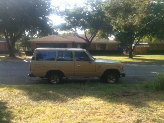

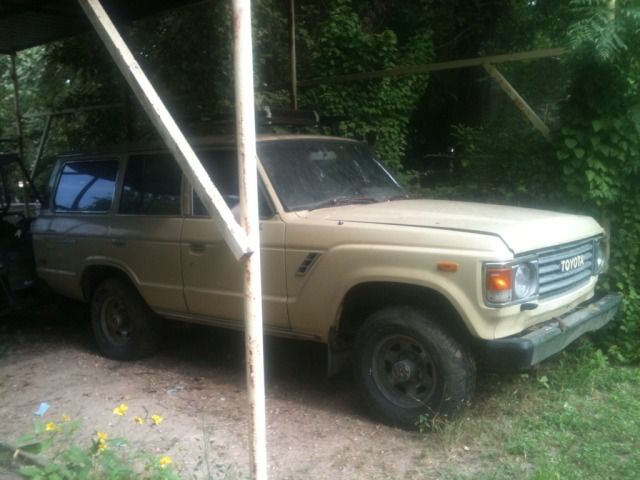

So after years of plans and dreams I finaly have My FJ60. Guys meet the Honey Badger!

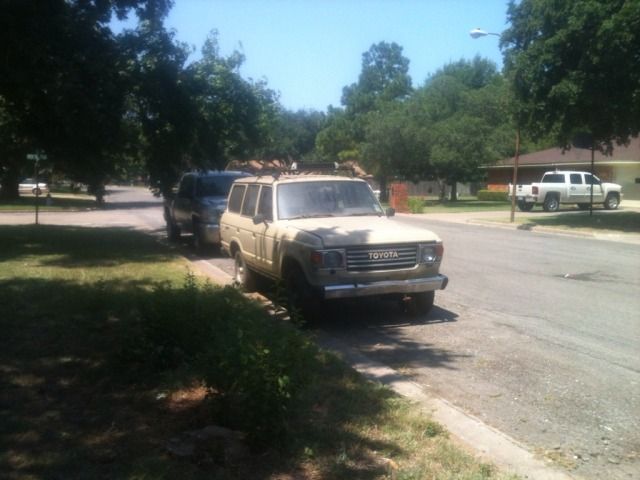

I found this lonely old soul sitting under a shed soon to bound in to servitude as the lowest form of offroad rig.... a "deer lease truck".
I could not let that happen to this beautiful specimen of Toyota BMF.
Where I found HB.

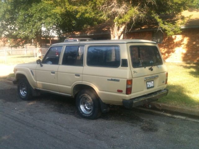

After about 6 hours of intensive labor it looks like he is feeling better.. this one is going to be a slow build and will not officialy start until Dirty Rice (my son's 88 MKIII Supra) is out of the garage and going strong as was agreed upon with the boss (My Wife)...
Little bit about HB

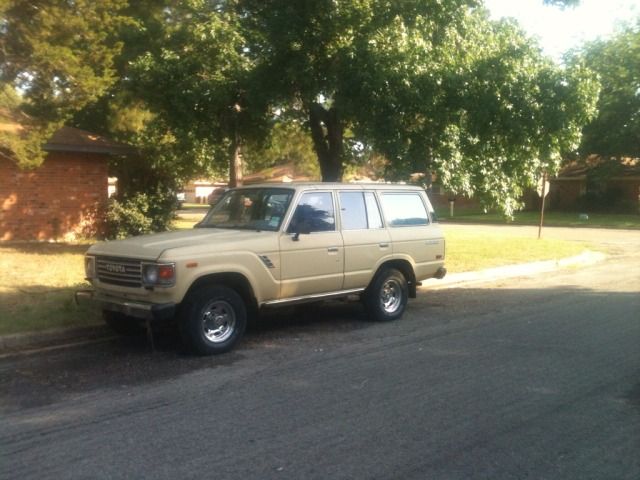

1985 Toyota FJ-60 Land Cruiser.
Engine: 2F inline 6cyl. rebuilt with about 10 miles on it
Transmission: H42 HD 4 speed
Transfercase: Toyota Split case 2.28:1
Differentials: 3.7:1 open front and rear to the best of my knowledge but I havent checked for lockers yet.
Plans are to build a light Expo Rig/DD
First mod was a good cleaning man was ther some funk in this thing.
Second mod was to removing the bike rack from the roof because it was rusted badly.
third was some B-12 adn a new set of plugs and a battery borrowed from Pete (my 85 Toyota Hilux). 10 years under a shed and after about 30 minutes iI had it running like a song.
the carb needs a rebuild but other than that all is well. Oh and the **** AC stilll works. Clutch is out???

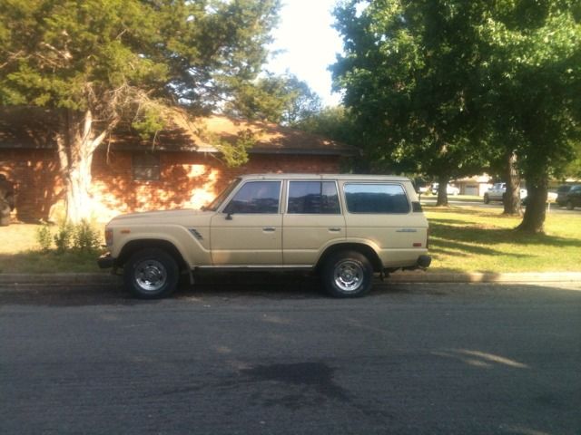

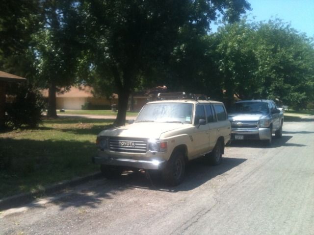

When I brought it home.
After several hours of elbow grease, a pack of smokes and about a gallon of Dr Pepper. (I dont drink beer because it makes me break out in hand cuffs.)

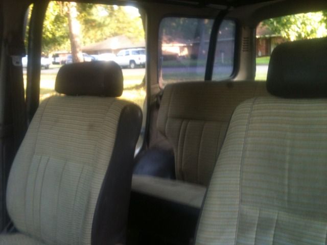

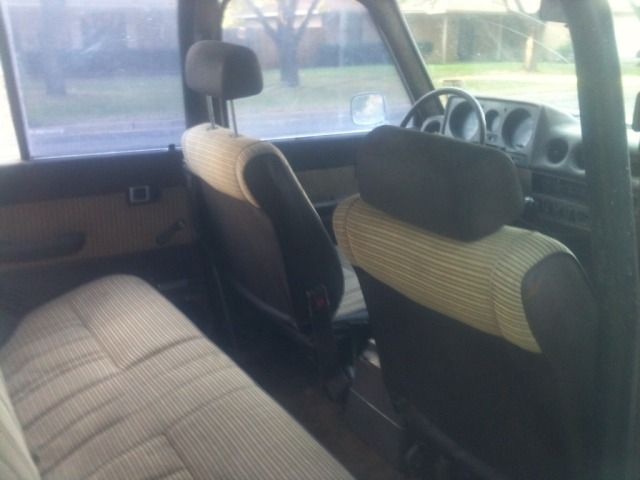

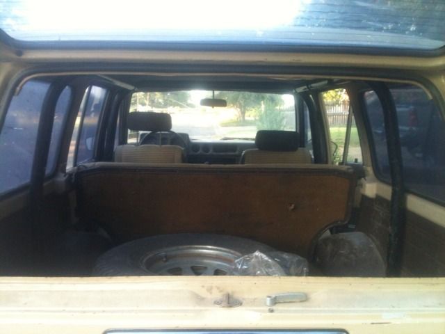

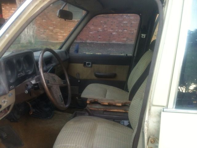

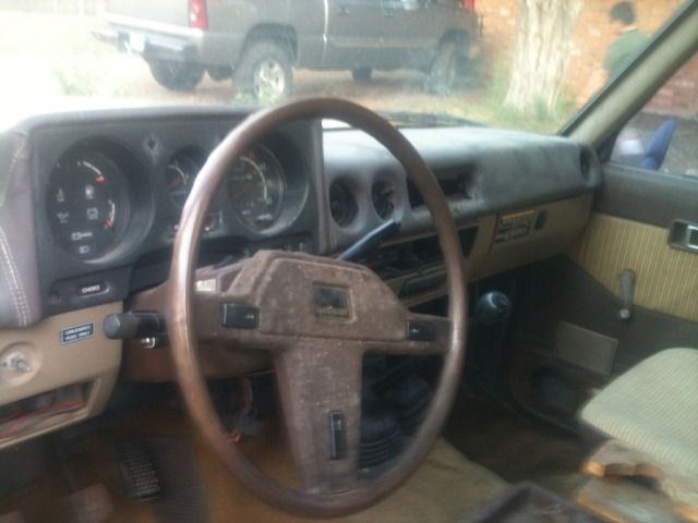

Few shots of the interior and what I belive to be a $OR "Family Cage". This thing was a mess filled my shop vac 3 times with all kinds of funk including a snake skin in the dash. I pulled every thing out of it but the dash and cleaned every where I could find to clean and then a few more. pics were taken after the interior was put back in. looks alot better but I still need to figure out how to get the mildew off the headliner that wont mess it up. The carpet is trashed so I am on the hunt for a good but cheep alternative for that. I may just pull it all back out and LineX the whole floor.

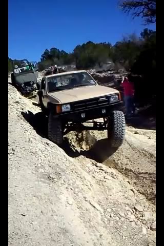

Project Pete '85 Hilux Crawler
