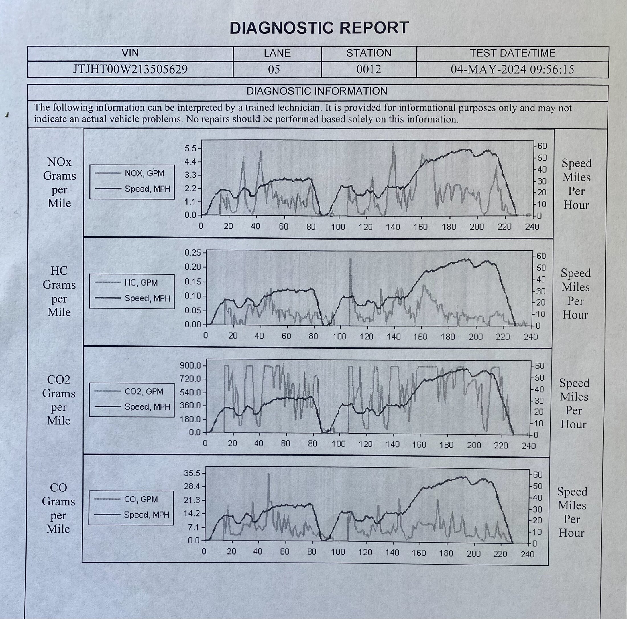

But before anything I want to register this truck, and I can’t do it due to failing emissions:
Google search indicates it’s related to EGR system. I found the schematic of this system:
Has anyone dealt with failed emissions due NOx? I found several threads in 80 series… but only one in 100 series.
Where should I start? I was thinking in replacing VSV, but dad thinks I should start with PCV.
Thank you!
You are not failing by much. Looking at your graph I suspect the NOX peaks are occurring immediately upon upshifts. I would turn off the overdrive and turn on the power button and run it through the test again. You will have one less shift and all your shifts will occur at higher rpm's/speed. I strongly suspect this will reduce NOX emissions, at least to some degree. I don't know if it will reduce them enough to pass, but you don't need to reduce them much. In any case, your second test is free and even if you fail you will at least have two graphs of two different driving patterns to compare NOX readings.

I wasn't aware that the OD turned back on when the engine was restarted. It stayed off on my 80 series. I think it is worth a shot with the power button on. High NOX readings are caused by high temperatures and pressures in the cylinders. On other vehicles the EGR system is designed to reduce these but the 100 series has no EGR system. I believe a lean mixture can cause higher NOX but also the CAT's on a 100 series are designed to reduce NOX I think (unlike the oe cats on 80 series). I believe I read somewhere a suggestion that low fuel pressure may result in a lean mixture which might increase NOX. For comparison purposes, my 2002 LX470 recently tested at .64 NOX. By the way, in my experience, Colorado's emissions testing does not produce repeatable results. I ran my 80 series through the test twice within 20 minutes (the gas cap failed back when they tested the cap after the dyne test) and the results were vastly different. I suspect that the difference is at least partly dependent on how the vehicle is driven on the dyne.
