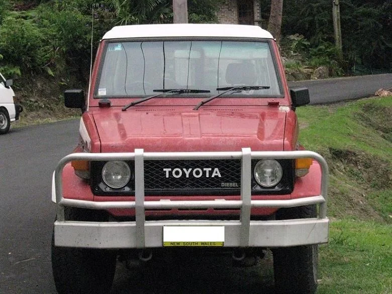

Hey,
I bought a bj73 85' in 2007 with 360k on the clock for 5500. i havent had a chance to go 4wd in the time i've owned the old girl and well i've finally figured that i wish to keep her as long as possible, old man says run it till it dies, i say that will never happen, considering its hit 412k on the clock now. Also i would be quite said to see her go.
So the plan is to get to work on her bit by bit, but being quite new to the 4wd mods, im trying to get a bit of info on what i can do to her, without making my daily drive undrivable legally.
Currently im looking into the panels (try and find good condition panels or fix the odd rust spot and restray her), turbo her (3b engine. good and very fuel efficient but not the best when on the freeway on a hill)
Also thinking of any other tips for jobs i can do to her regarding the mechanics of her, suspension, etc. Also looking at doing theses jobs on weekends with the longest without having a car being a week at the most for some bigger jobs.
any help anyone can chuck me would be wonderful.
Heres a pic of the front and passenger side. just took them now.
enjoy.
running 31x10.50 r15 lt. dont think they came standard with the 73' not sure.
Its a neat looking cruiser atm mate
but some ideas
all the front end panels you can use off 7x series cruisers up to 06 if your chasing better condition second hand or new panels
put a post 1991 cruiser steering wheel on it get rid of the bus one
give it a new face lift and put some 78 or79 series grill and indicators on it, which are the later troopy and ute 99-06 model you can get chrome ones as well like the RV utes come with
Paint it all white,and the latest 7x series white is nice, better for when you scratch it in the bush
Some font flares to match the back
some 33 x 12.5 bfg At's
be like new

But thanks on panel advise, i was wondering what panels would fit there other then the 1973/4 series heard the 70 series wont thou being a shorty. mainly concerned bout replacing the bonnet as unlike the pre-storm weather quality pictures from yesterday, bonnet has got rust spots all around it. So next thing is engine and suspension. i know it rides bout 180Cm Wheel to highest point of frp roof (theres a car park that i couldnt go in because i was just bout to hit the roof.), and as for work i park undercover at night time for work, i wont be able to park there if i get a big lift or too big of tyres. but ill think bout the tyres. Unsure on original height but Might have a lift already not sure there is a qld mod plate next to the vin unsure what for.
Im looking at garrett turbos kits, any other engine modifications that really work well at getting the kw up on the 3b?
also, only need one front flare, some fool hit the car at uni but did no panel damage just knocked the flare off and then parked on it! wasn't in the best condition after that. they had a bit of white scratchs on their silver rolla.

Hi Snowguy. This mob might be able to match up the flare you lost
Fibreglass Replacement Panels
As to the turbo,I would get it compression tested before you fit one. 412000 klms is getting on a bit.
Some turbo companies will not fit a turbo to a 3B over 300000klms ,but of course there is nothing to stop you doing it yourself.
You might even want to think about a larger engine. Toyota made 14B and 15B for the Dyna trucks.
They also take well to turboing and are fairly cheap if you know where to look.
I think these are about 4 litres,but externally they are the same size as the 3B. They have longer strokes and bigger bores with reinforced engine blocks,unbreakable in a 73 series:D
The "1" on the front of the engine code means direct injection as opposed to indirect injection on the 3B;)
