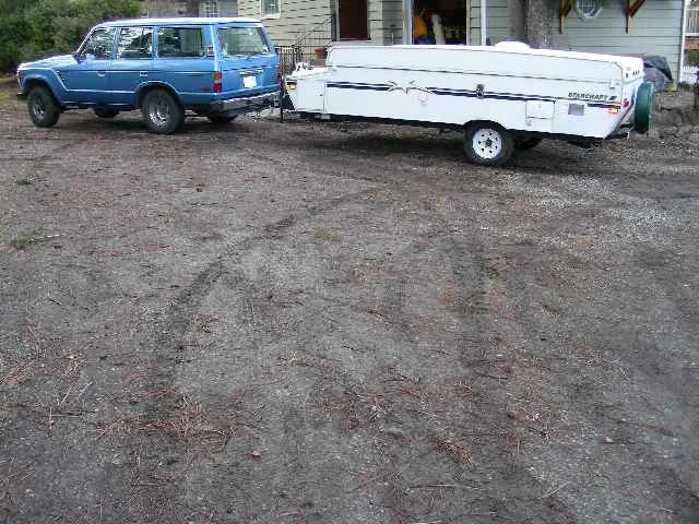

Picked up a Starcraft 2411 this weekend. Good floorplan and storage. Never thought I'd own a trailer, but kids change everything. The little one loves it.

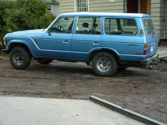

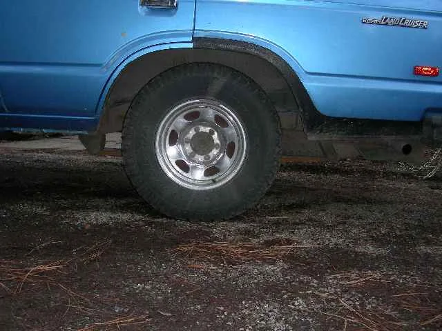

It maxes out the tow limits of the cruiser, but with the electric brakes it actually stops quicker. Notice my springs. Is this dangerous? An OME heavy is a few months away, but we'll be using the trailer before then. Also will be doing a SOA on the trailer within a week or two, will post pics then.

I'm going to look into the airbags also, especailly since I just paid bills this morning, :doh: and the OME heavys may be more than a few months off. Other than being concerned about the springs, the trailer pulls nice. No swaying and the 60 does much better than I thought it would. No problem getting to and maintaining speed. I'm sure the passes will be a different story though.
you're looking a little flat there chief....I'd be careful adding much more weight over those rear springs with that trailer hitched (read adding a lot of gear). Also might want to make sure that you're not exceeding the gross vehicle weight rating, but what do I know......

I'm afraid that loaded up I will be over the GVW of 7000 lbs, I bet I'm close to it empty. I may be a little naive but I'm not to worried about the 60 (except for the springs) and a few hundred pounds over GVW. The one thing that does worry me is insurance if I were to get in an accident. Don't know exactly where it is until I get it on a scale. BTW does anybody know what determines GVW? If upgraded springs and/or airbags are installed would raise the rating some?

Ryan - I certainly wouldn't drive far sagging like that for too long. Have you looked into add-a-leaf for your springs? I'd think that may be a good option to stiffen what you've got w/o replacement.
You may also want to consider a load ditributing hitch. They have torsion bars which allow you to take a significant amount of weight off the bumper and redistribute it forward. They also help alot with the swaying of the trailer. They can be pretty spendy new but I just picked one up used for 30.00 off the craigslist.

The add a leafs are about $60 for the 60 series. I wouldn't bother with them though if you plan on going OME in your future because if you do the add a leafs you should also do new U bolts. They are kind of spendy and then you'd need them again when you did the OMEs.
Be careful doing a SOA on the trailer. I did it to my pop up last year and now my tires are wearing really funny. It changed the toe in on the axle by going SOA.
Be careful doing a SOA on the trailer. I did it to my pop up last year and now my tires are wearing really funny. It changed the toe in on the axle by going SOA.[/QUOTE
The dealership sold me two new saddles to weld on. The axle on this trailer has a built in camber-never seen that before-so I can't just rotate the axle. I'll be extra careful with alignment of the saddles and hope for the best.
