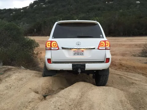

So after some testing/abuse with the Kings I could not be happier, other than even with 700 pound springs (14 inches) I'm still not able to achieve the same height as the Foxes 2.5 they replaced. After confirming that both the Fox and new King's compressed and extended lengths are within ⅜ inch or less of each other extended and compressed, I decided to order new Eibach 16 inch 700 pound springs instead of taking the same spring off the foxes, as perhaps someone is interested in some great condition foxes here on the forum or elsewhere, instead of collecting dust in my garage. In theory the additional 2 inches on the Eibach springs should give me the same lift (3 inches) as the foxes did, and won't require me to max out the preload the current Kings are set at just to achieve a full 2 inches.
You know it's bad when the wife, who normally can't pick up on any of the endless pit of mod fever symptoms, comes in the house and asks me "Did you lower your car or something?"
Here is a video of the foxes in action, mild jumping the 200, you see the fronts eat it up like butter while the rears buck a bit, probably due to the bump I hit right after landing:
The new Kings are blowing my mind, here are a few stretching exercises to wet your noodles. Notice how nicely the 17x8.5 x 4.5inch BS Method Bead lockers stuff the wheel wells

That last shot I could of pulled the spring out if I wanted to...doh!

Nope, and we had the front cranked up pretty high for that. Not what you should run. The diff drop would not have been compatible with the ARB skids.
Damn, I was just about to purchase the BP-51 and ARB skids as some jackass forgot to reinstall mine during an oil change. What aftermarket skid plates can you run with a diff drop?

Curious on why the diff drop is not compatable with the arb skids? I have them installed with my tjm skids and they're fine
