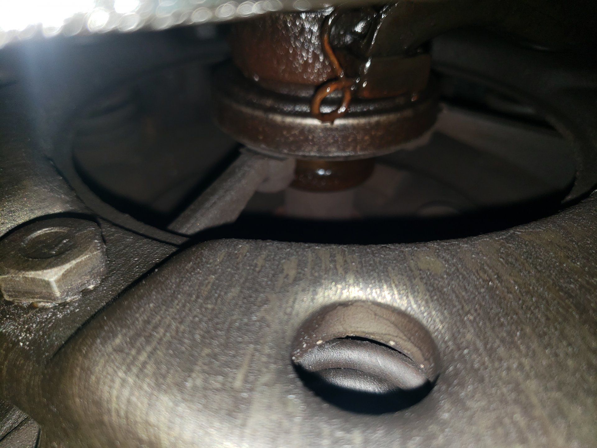

Pulled the clutch inspection cover, but need to pull part of the exhaust to get it all the way off, and it was getting dark. That said, can confirm it's the 3 prong older style clutch, and it does appear to be leaking from the back seal to the trans. The oil is definitely coming from the back forward.

My guess is that the clutch is shuddering from the oil leak(s). If it was slipping from the heads of rivets on a worn-out disc then you'd have more flywheel carnage. But, it is hard to say if the flywheel is good or not. I'd entertain the idea that it might only be a oil leak problem.
However, oil can impart carbon on the surface of cast iron, and the driving can create heat resulting in glazing, or 'case hardening.' That is a problem because you have spots on the flywheel that wear, and ones that don't wear as much, which makes for less area for the clutch disc to grab onto. Basically, if I was to swap a clutch, I'd almost always have the flywheel get some kind of machining, or abrasive, treatment. I've even heard of shops magnifluxing them to check for structural cracks resulting from excessive heat, or whatever.

Definitely get the flywheel resurfaced. I did the clutch in my old Honda Accord and just slapped in new parts without a full removal/disassembly/flywheel resurfacing and only went about 50K miles before the clutch was slipping again on a well polished/glazed flywheel.
OK, Got the fly wheel resurfaced and back to me yesterday. Going into Tranco on Eubank Monday morning. Really friendly people and they had no problem with me bringing in the parts or working on an older rig. Got front trans and rear main engine seal too. Pretty excited to get this done and shifting smooth! I'll post with what's hopefully a successfull install mid next week! Fingers crossed

New clutch is in. Tranco was great. Truck drives amazing now. Cream puff! Crazy how much better it is. Thanks to everyone for the sage advice. I'll be back for more! Dizzy, got a banged up fly wheel for ya! Thx again!
