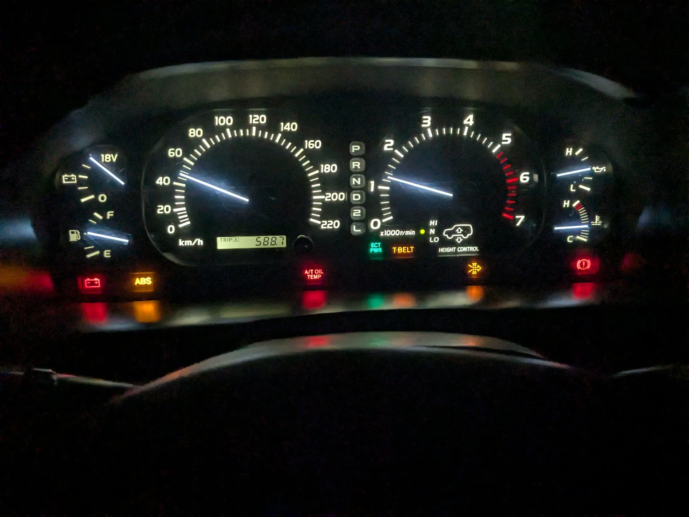

I've been reading through various threads getting myself emerged into 4x4 and IH8Mud specifically. This is my first 4WD which I picked up for a nice price, it has 340,000kms on the clock, however I have noticed some faults that will randomly appear whilst I'm driving along, and then disappear. I was wondering if anyone had similary faults to these and what their fix was for it.

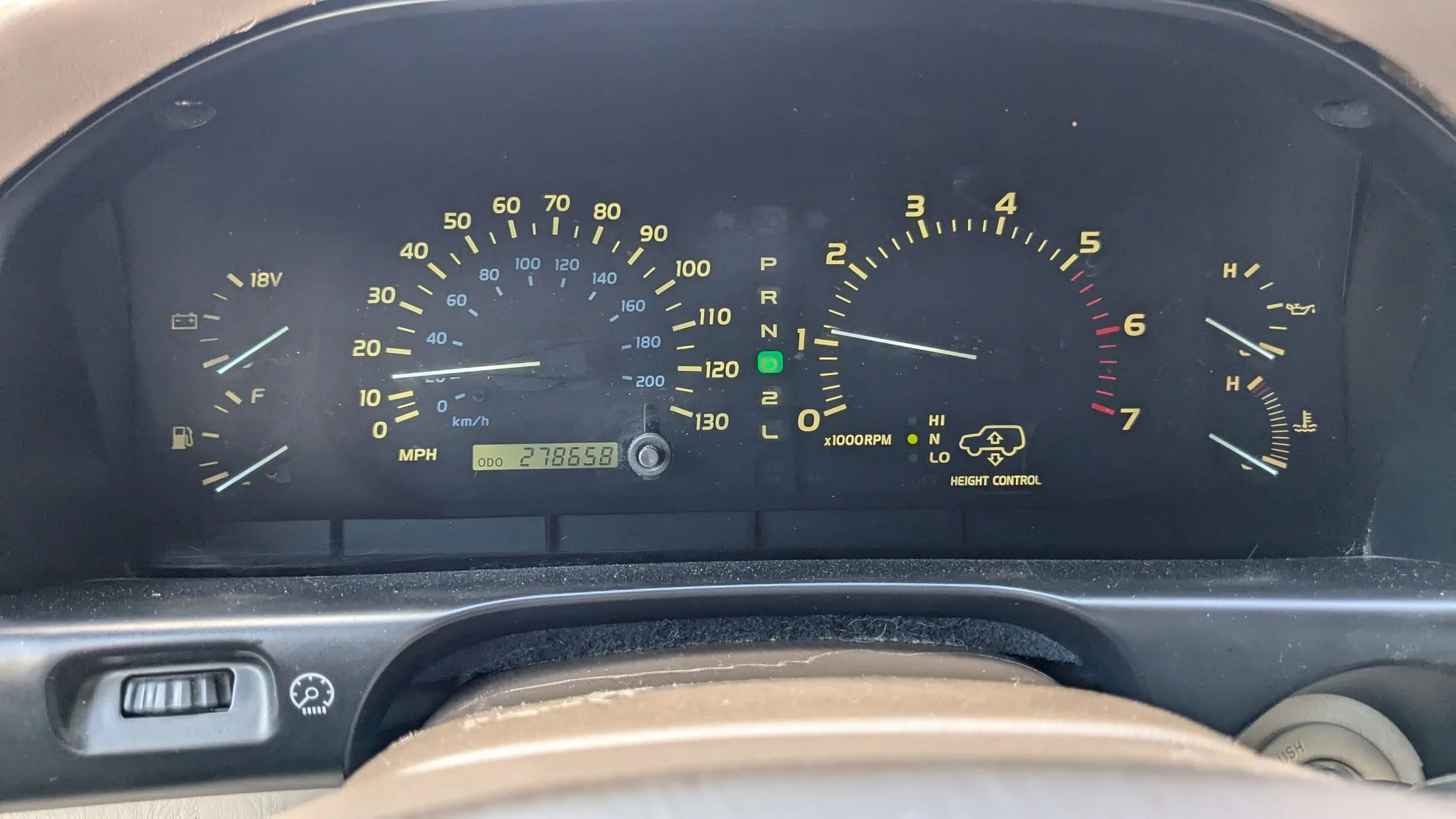

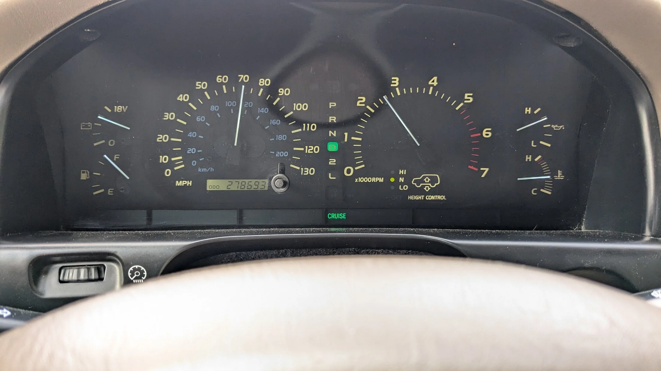

I gonna jump in here and add my status gauges volt, oil, fuel, temp behave erratic when cabin temp is high and tend to behave properly after a restart and A/C has run for a while.
98 LX470 USA.
Kevan66 I'm suspecting an issue with the instrument cluster in my case.
Hopefully someone has some insight for us both.
I'd put a voltmeter on the battery and see what it's at, particularly when the fault is apparent. Showing 18 volts there and that's not good though it might be a symptom of your issue and not the actual problem. Usually strange dash lights is a sign of low volts/ alternator on the way out/ alternator plugs loose.

SOLVED: The issue was in the alternators voltage regulator. Simple voltage testing on the battery when it was spiking was showing 18V+ directly from the battery. I checked the positive fuse box and wiring surrounding my clamps, power etc and could not see anything wrong with them. I had a sneaking suspicion that my altnerator was shot... more specifically the voltage regulator. Since installing the new one, I have not had any more voltage spikes and the car has been driving great.

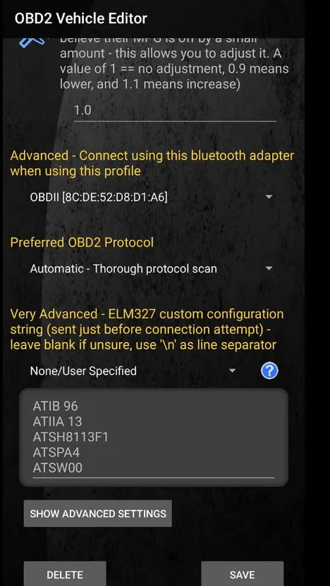

What were you using to connect to the Bluetooth dongle? Torque Pro? I'm not sure if it's the same with the V8's, but with the diesel's you need to put a code in to help connect properly
Might be worth a try
I was using Torque Pro, I'll have a look into Techstream as well this week as now the AHC is playing up. What year model have you got as any help with the MOBD systems are great.

Mine is a 98 HDJ101 but those Torquepro codes work on the Australian HDJ100s as well. I dont know about the V8's, just thought it might be worth you trying. Techstream would be much better if you can get that up and running
