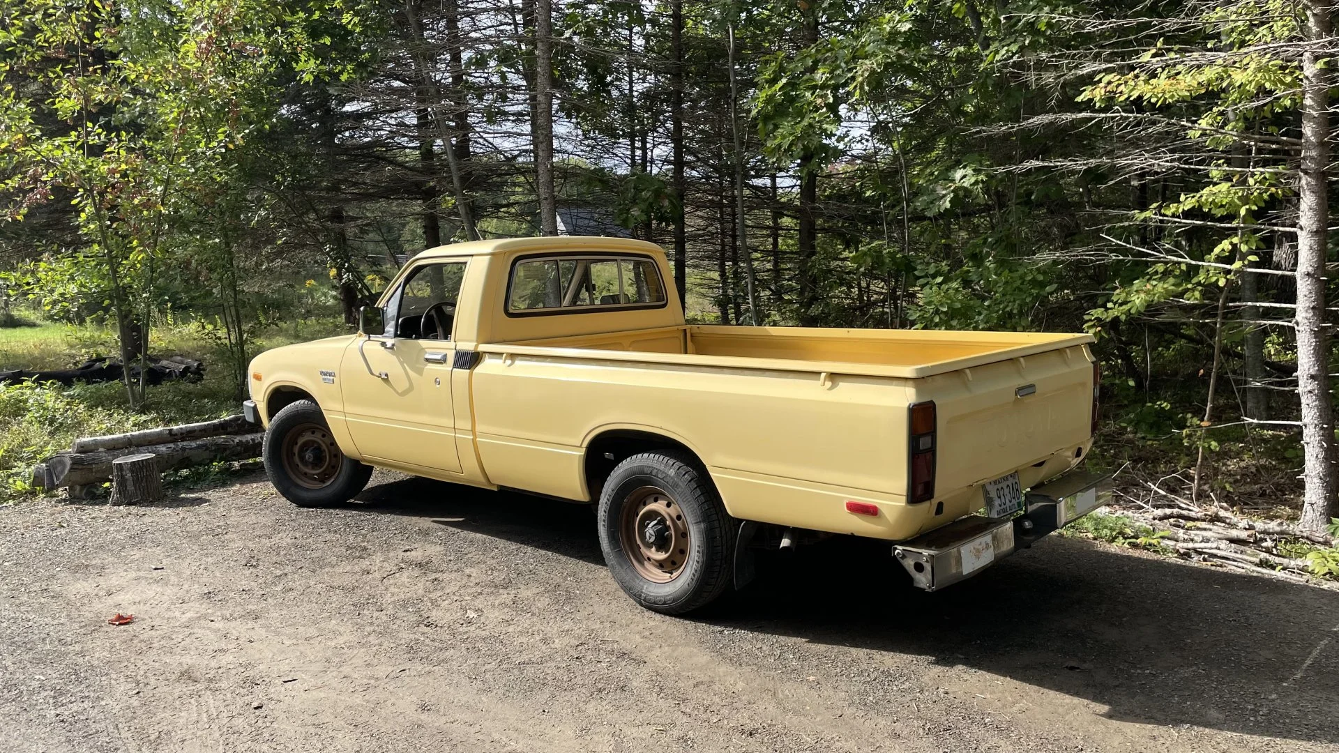

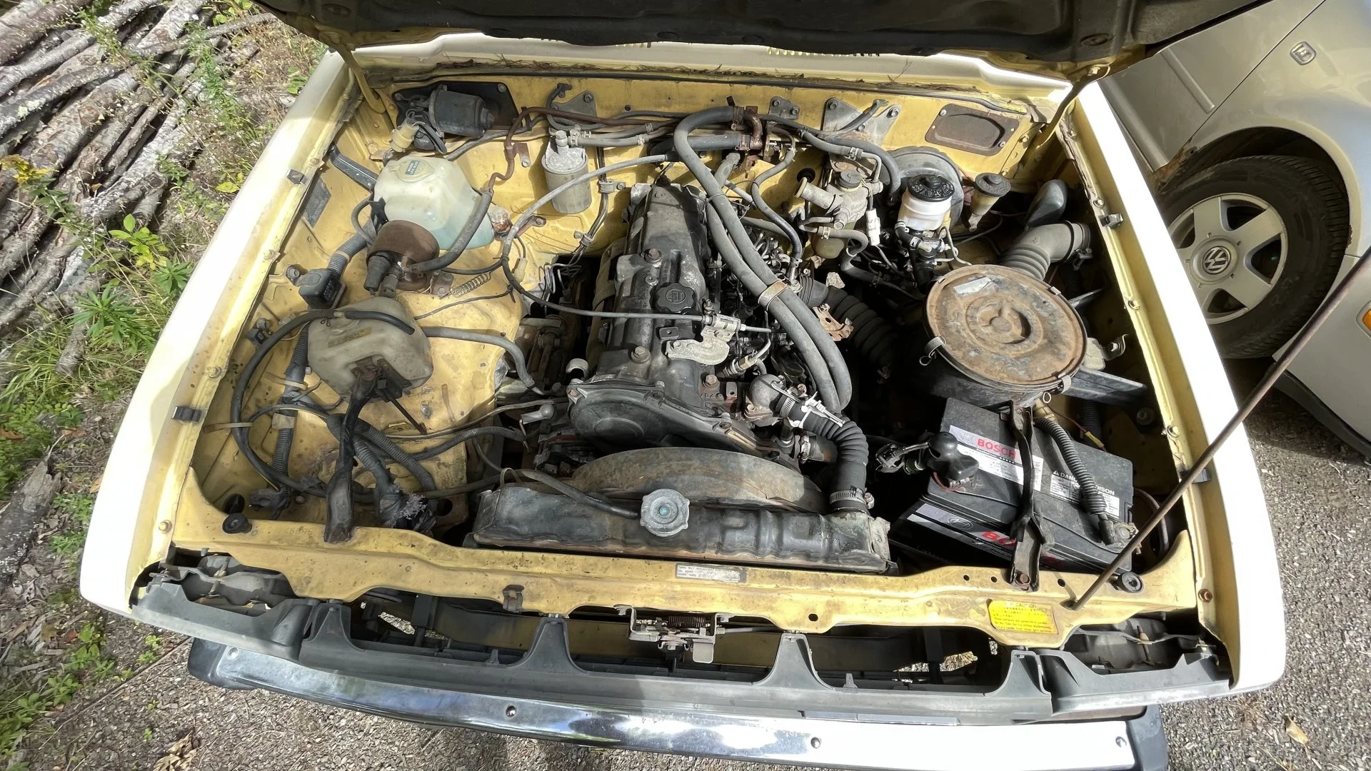

Hi everyone. Just picked up a beautiful little 1983 Toyota Pickup 2WD Diesel with the 2.2 liter L engine. 162,000 miles. An almost completely rust free survivor.
Not new to diesels or Toyotas, but definitely new to Toyota diesels. Currently trying to bring her up to trusty reliable service condition. Planning to adjust valves, replace timing belt, water pump, hoses, tires, etc.
Here she is:

Happy to take suggestions as to what to replace/adjust to get ahead of maintenance and such.
