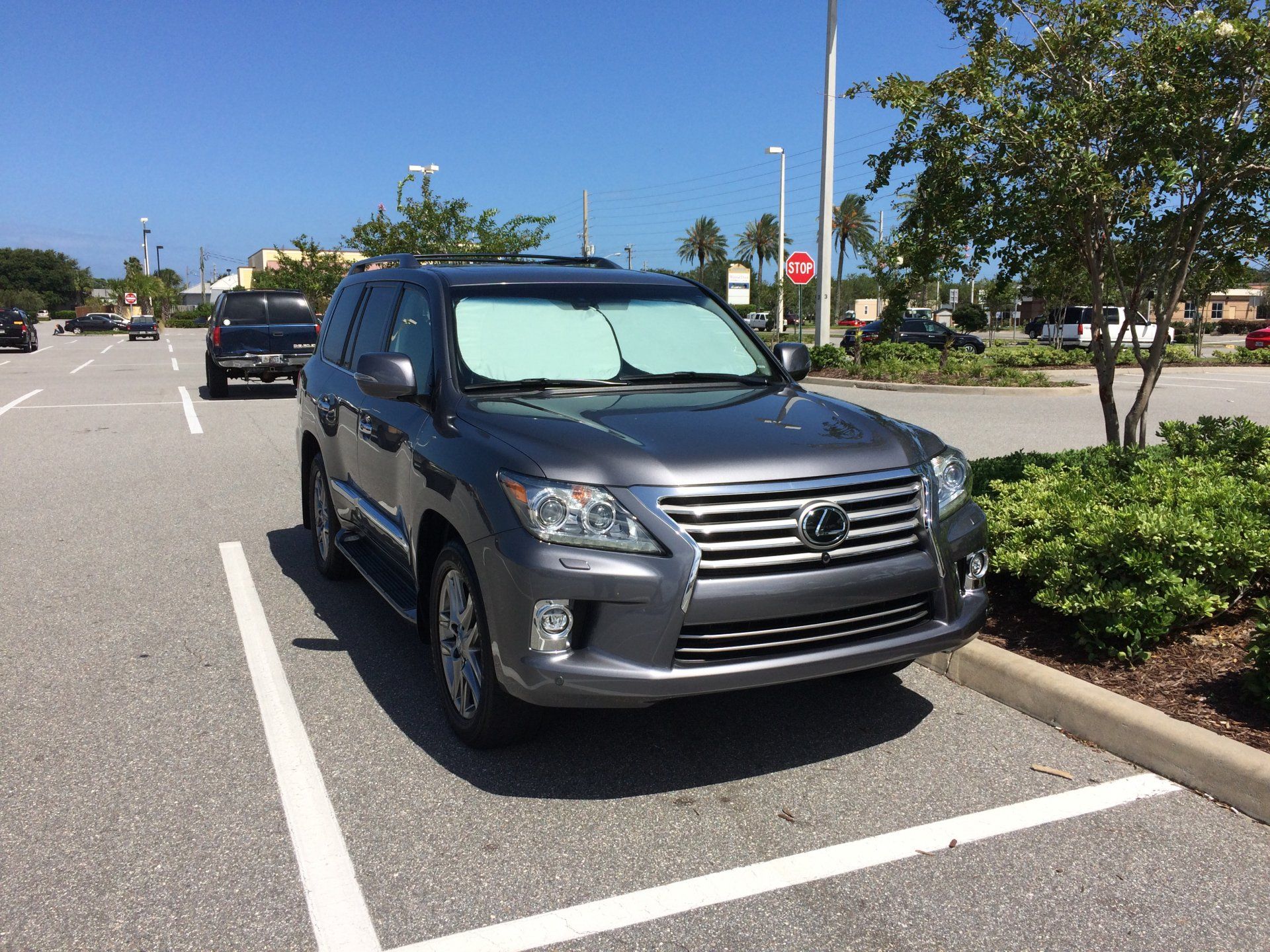

Looking to immediately mount Method Racing 18 x 9 NV 305 (5 x 150 bolt, 25mm offset, 6" spacing) with BFG K02 AT 285/65 R18 (32.5"). Tentatively planning to remove NV outer rim decorative bolts and anodize them anthracite color to tie in better with Nebula Gray for a more refined look. Attached a few pics that show the stock wheel/tire combo.

Went ahead and mounted LTX M/S Defender P275/60 R20 (33"). Wanted the extra bit of sidewall for more psi options and compliance on rougher trail heads. Zero rubbing, excellent comfortable & quiet drive. Fills out the wheel well, with a more balanced look like a stock 13-15 LC on it's 18" w/60s. Still can't believe Lexus put a 50 on this truck, sigh.
Snapped a few quick pics today before heading home, @ N height. 36 psi.

Yes, no rub with regards to daily driving and articulating truck back and forth over parking lot rock gardens at full lock & N setting. Only prelim tests, but so far so good. If there's going to be even a light rub in Hi setting on rough terrain, I'd be quite surprised given current gaps. I suspect it's due to width and offset of OEM wheel. Assuming its position was designed for that wheel well for optimal articulation and clearance?

It's more than you need, you will love this spec. Super smooth and quiet on our rough Denver streets. The pics I took don't do it justice...in person, car looks so balanced. After getting info from gaijn and Michelin direct, I'm now running them @ 33psi. They only require 29 psi cold (Michelin) to get load rating met. I may go 30 with a TPMS light removal mod (if its been done).
