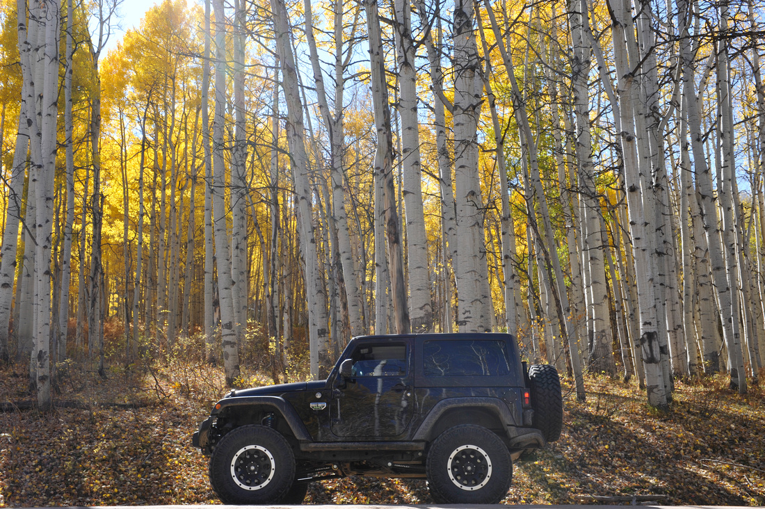

Well, the only vehicle that I really modified was that JK :) - I miss that Jeep. It was a mistake to trade it.
I never really did anything to the Land Rovers and I did not keep the 4Runner TRD Pro long enough to do anything to it. Although it was pretty decent from the factory.
