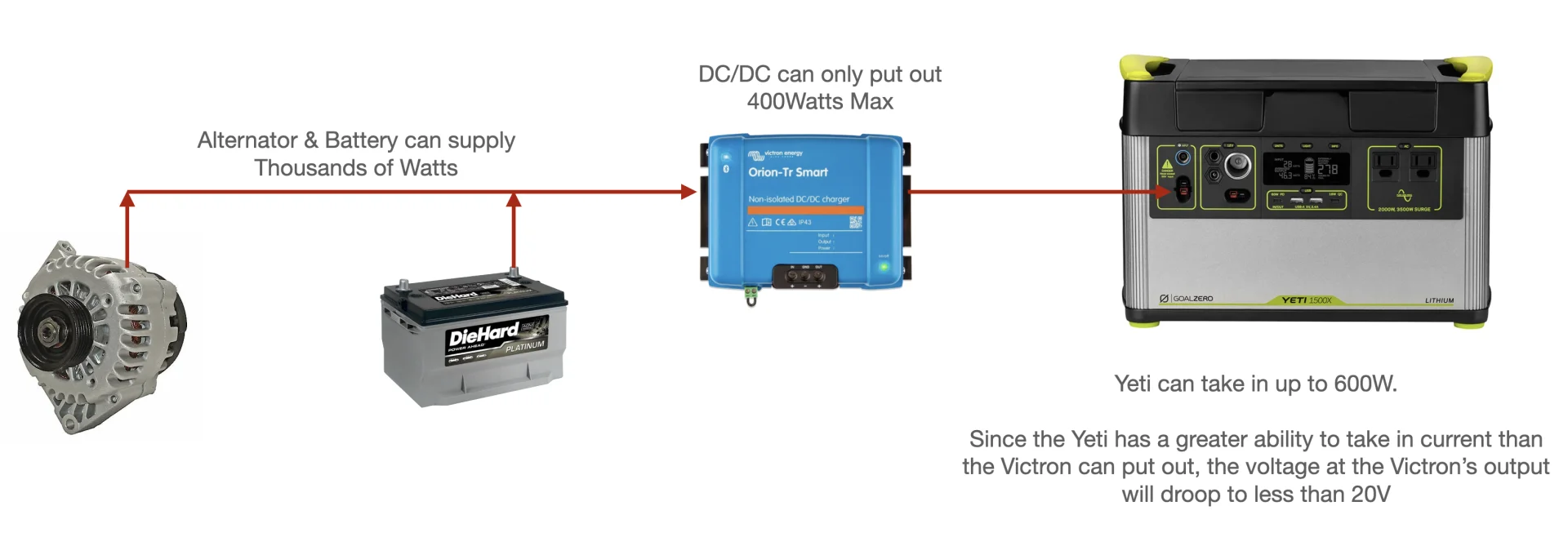

So, another bit of clarity on this situation. After taking more measurements, I think I figured out a little more precisely what's happening.
The Victron puts out my choice of any voltage in the 20V to 30V range. Meanwhile, the Anderson-like input on the Goal Zero Yeti is rated for 14V-50V. This input is connected to Yeti's internal MPPT. I just discovered that, for some reason, the Yeti's MPPT is converting the incoming voltage to 16V, even though it can easily handle the 20V to 30V and the full current delivered at those voltage's by the Victron. The 16V is below the Victron's minimum output; so that explains why I'm seeing a dashed line on the output measurement in the Victron app. Meanwhile, since the Yeti is changing the voltage being returned through the negative wire to the Victron, maybe this voltage drop is what's causing the appearance of a 1V drop coming in from the starter battery. (I can't fully explain the latter phenomenon, so I'm speculating on that.)
For your latest post, I think your Victron is underspecified for the job. I'd suggest replacing the Victron with Yeti's Vehicle Integration Kit. Hope this explanation makes sense. Happy to go into more detail.
But about the 1V drop at the input of the DC/DC, I agree with TeCKis300 that there's likely a bit of resistance somewhere in the connections to cause that droop. Since the voltage drops when the charger is passing current, it points pretty squarely at resistive losses.
Great diagram, @daneo . Thank you!
