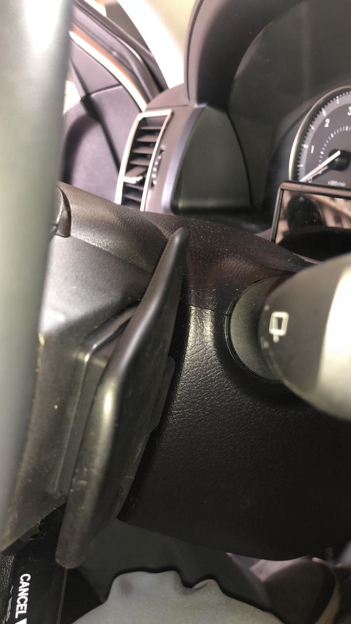

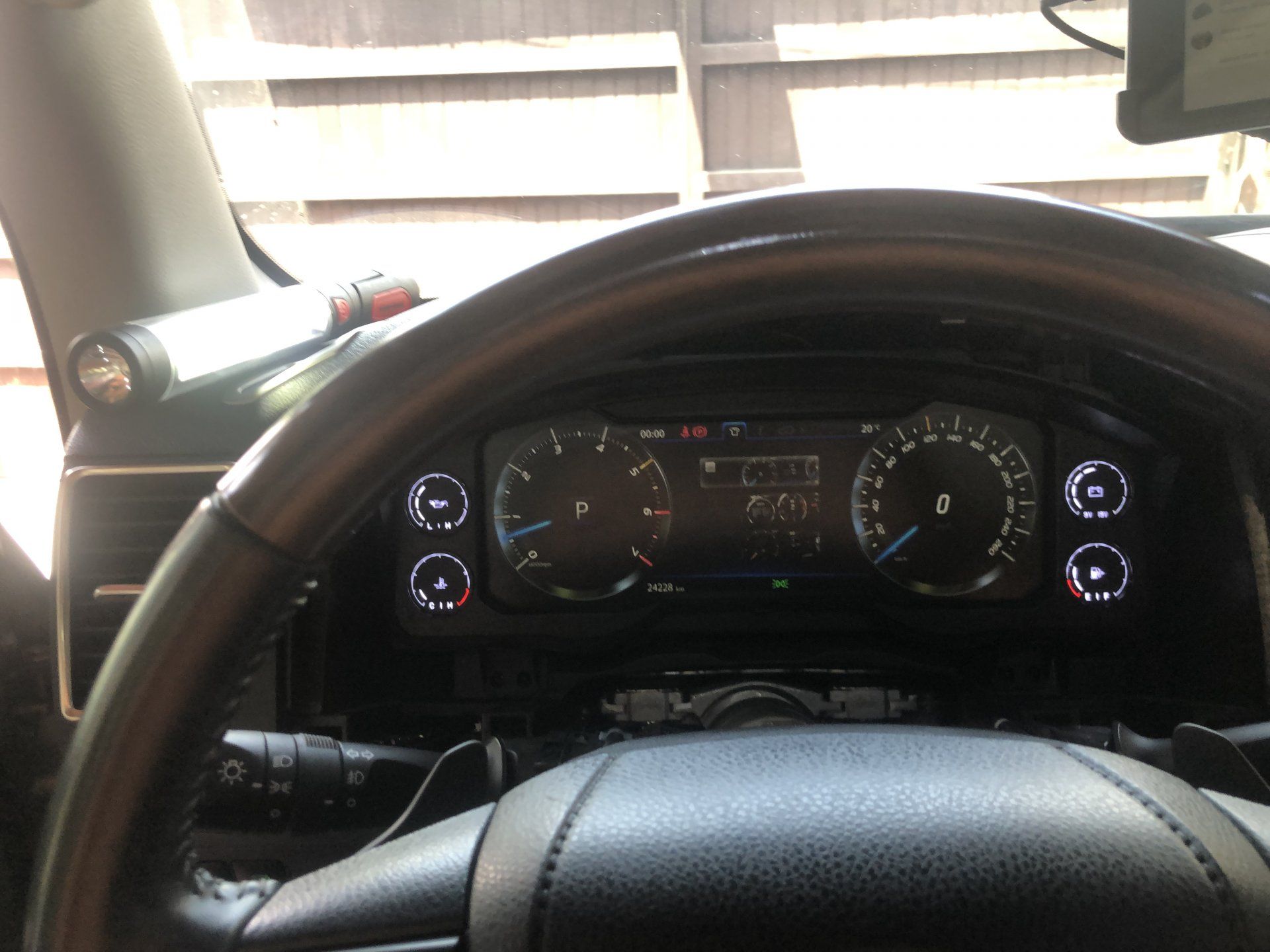

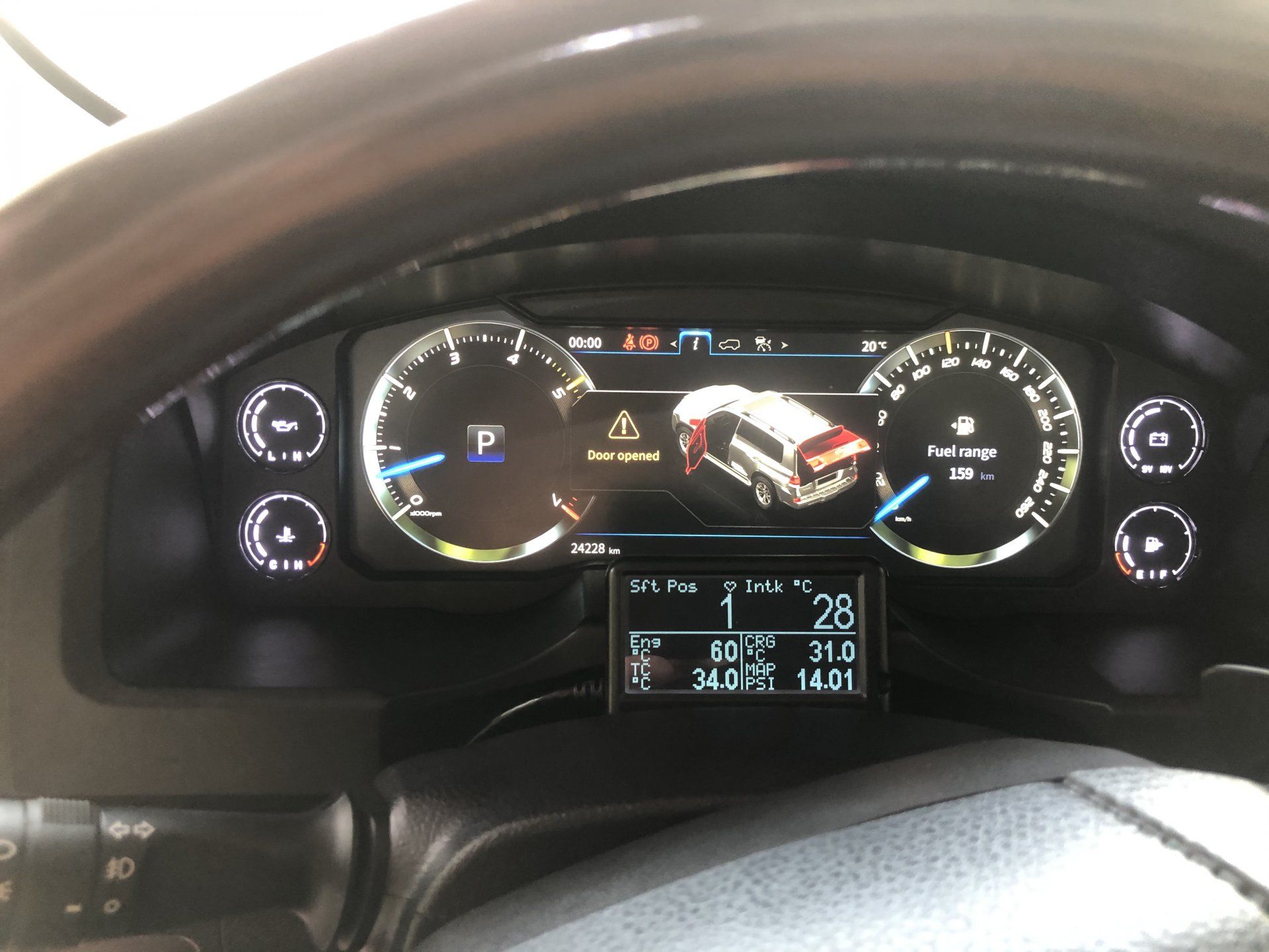

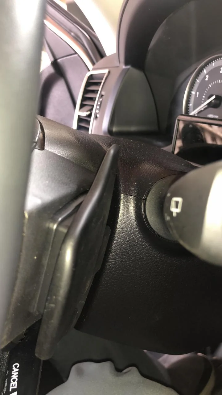

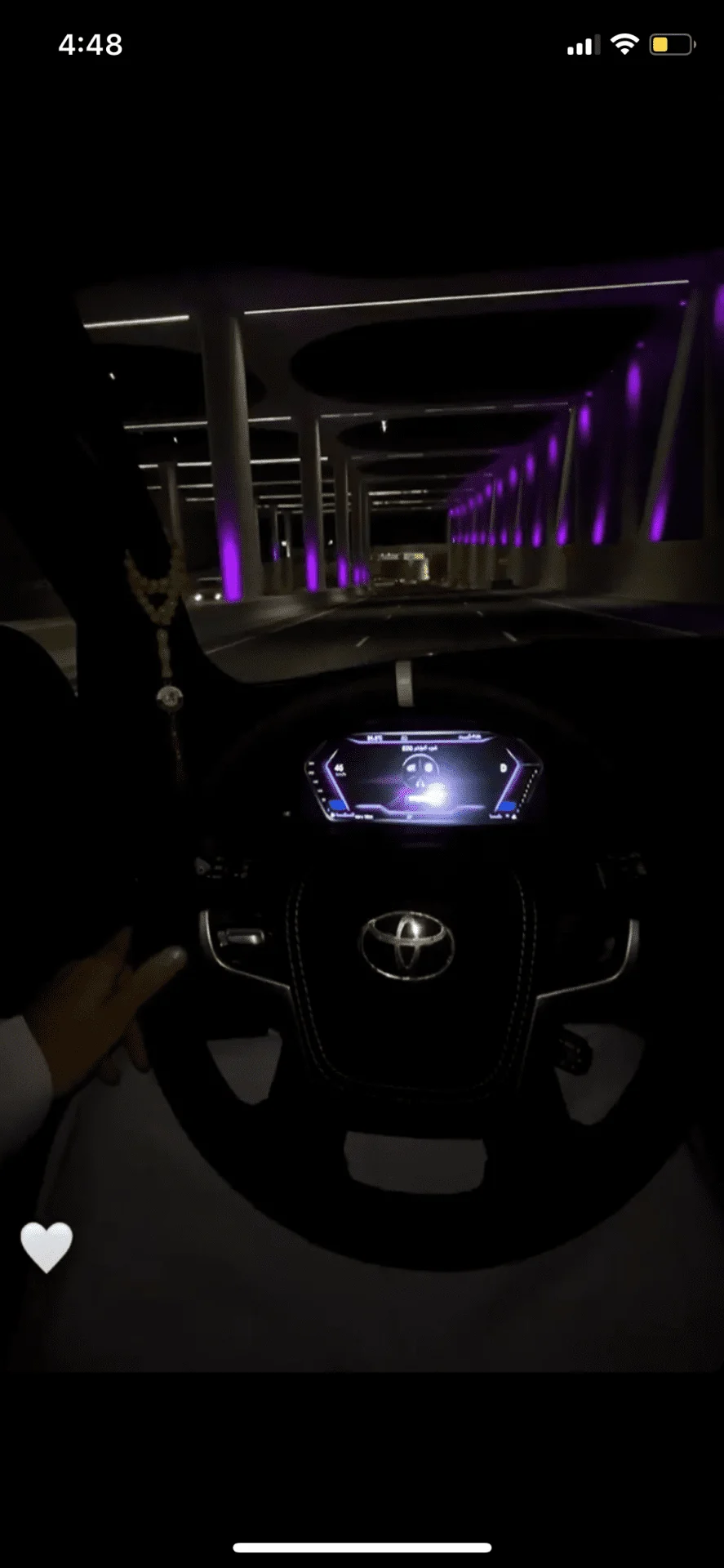

New Dashboard fron carobotor and shift paddle from pvs

DOA Loser means Dead On Arrival Loser. In other words, based on appearance alone, it does not appeal to me due to reduced contrast compared to stock center dash particularly during daylight heading into the sun - stock Optiline gauges have much more contrast - also, concerns about compatibility with ALL stock control systems.

Does the paddle shifter setup allow holding a gear? Or does it just adjust the “S” mode, aka the tallest gear allowed?
Based on the very limited info at the link posted, looks like it mirrors the action of the stock shifter in "S" mode - so, yes, all it does is limit the top gear.
HTH
There are a few shops selling the paddle shift setups including @EC OFFROAD. I believe the EC is wireless. @Abraxas9083 the setup you installed looks wired and super simple.
As others have mentioned the paddle shift gives you a gear limit just like the standard S mode but that's still very useful. The LX570 has a paddle shift so Toyota parts are available.
There are a few shops selling the paddle shift setups including @EC OFFROAD. I believe the EC is wireless. @Abraxas9083 is the setup you installed wired or wireless?
As others have mentioned the paddle shift give you a gear limit just like the standard S mode but that's still very useful. The LX570 has a paddle shift so Toyota parts are available.
hi RobRed, yes it is wireless

You are correct - its operating as designed.
IF the trans selector is in D and you use the paddles it is temporary gear limiting.
Place the selector in S and use the paddles it will maintain your selection for top gear indefinitely or until something dumb happens like an over rev.
