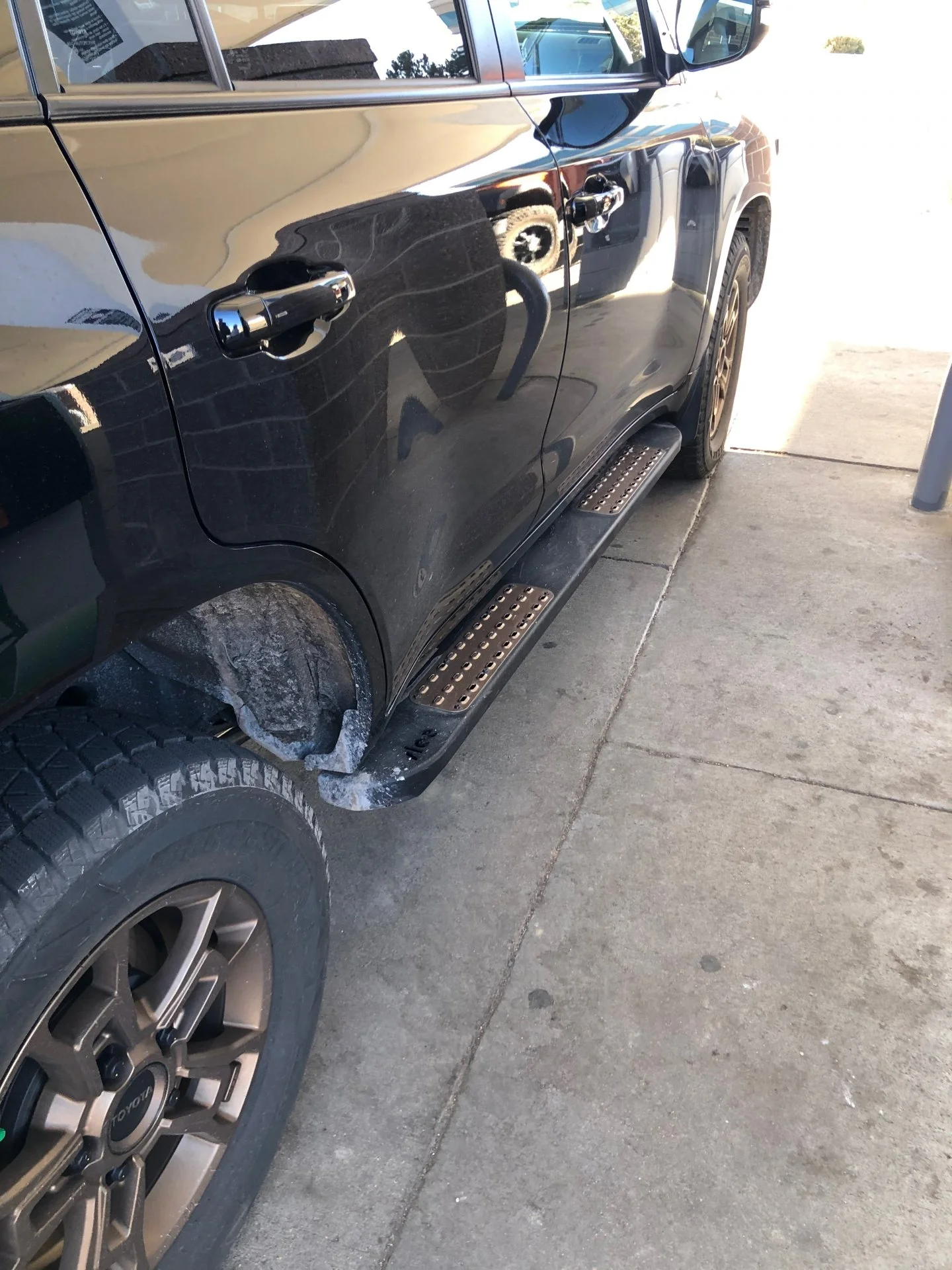

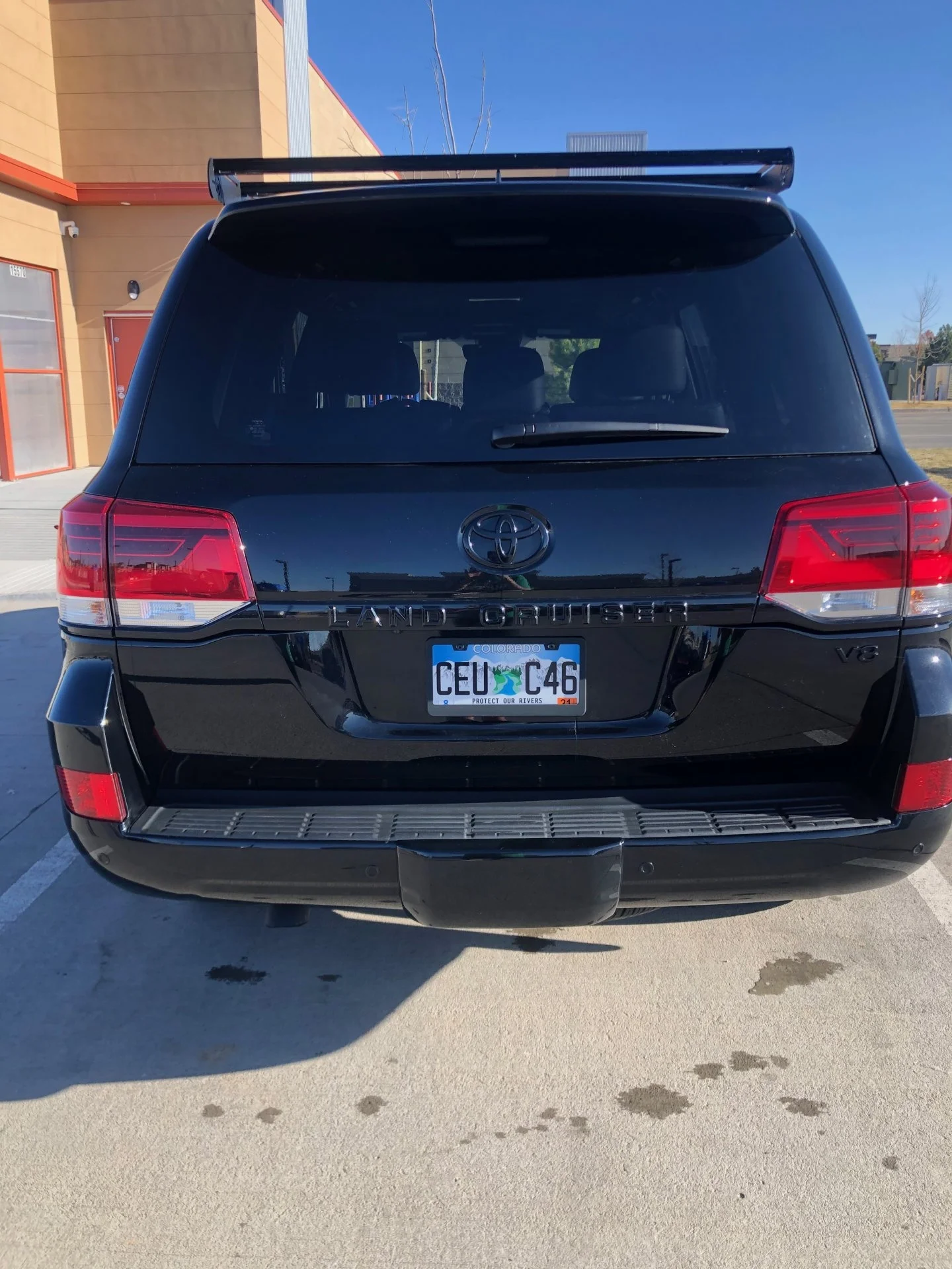

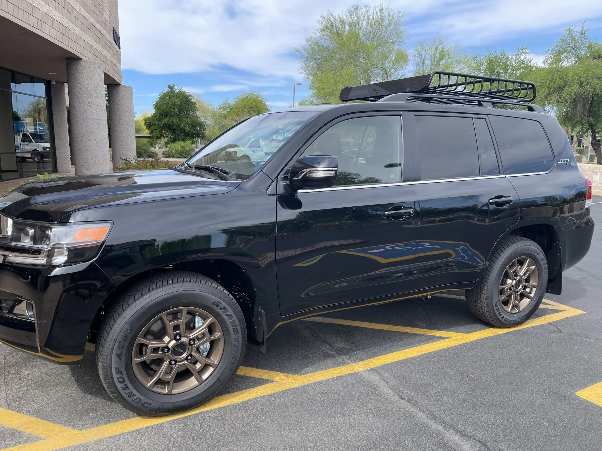

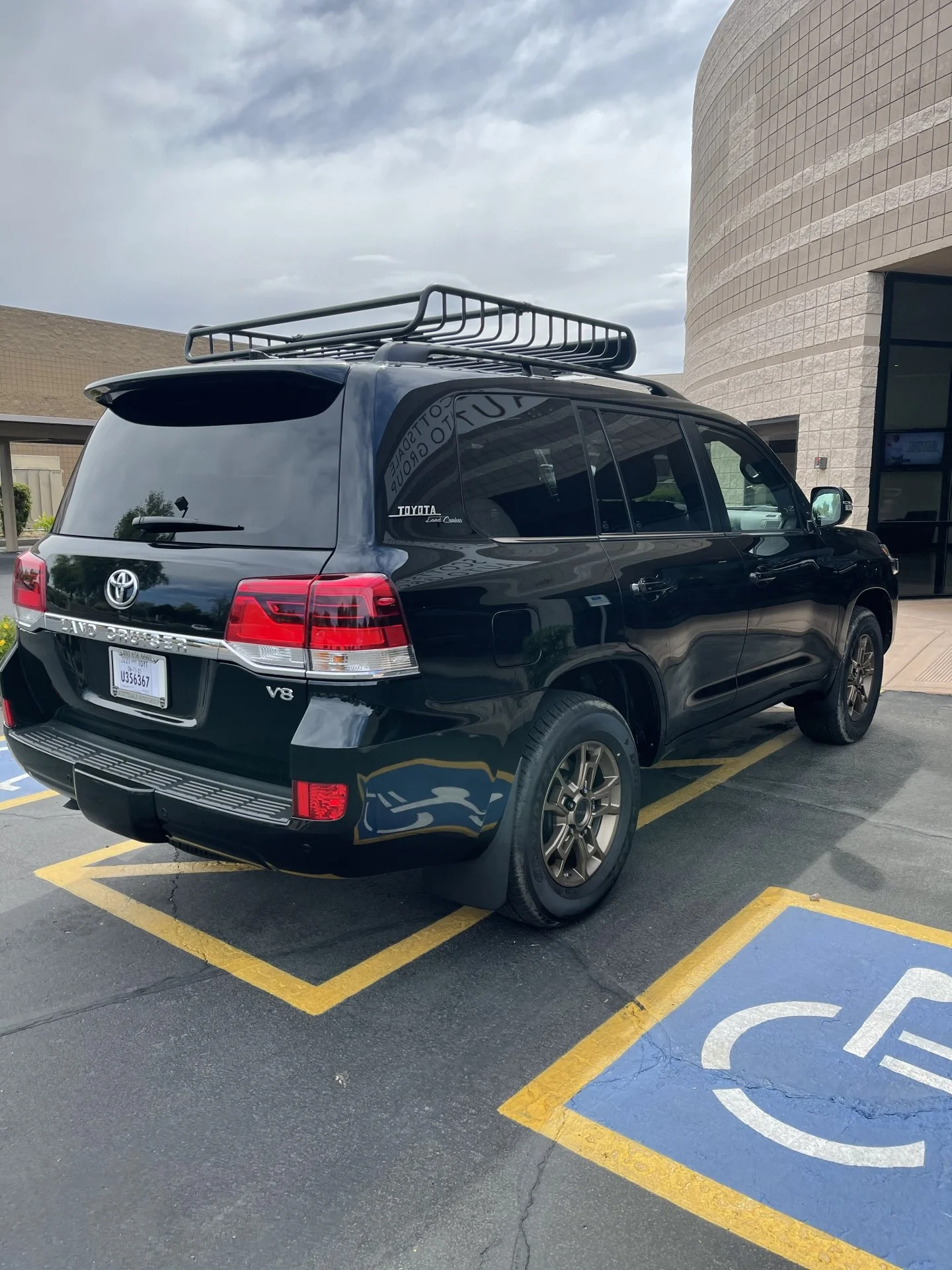

ok here’s the 1st photos. Not exciting just stock. Getting tint next week. Order the adjustment King Coil over setup.

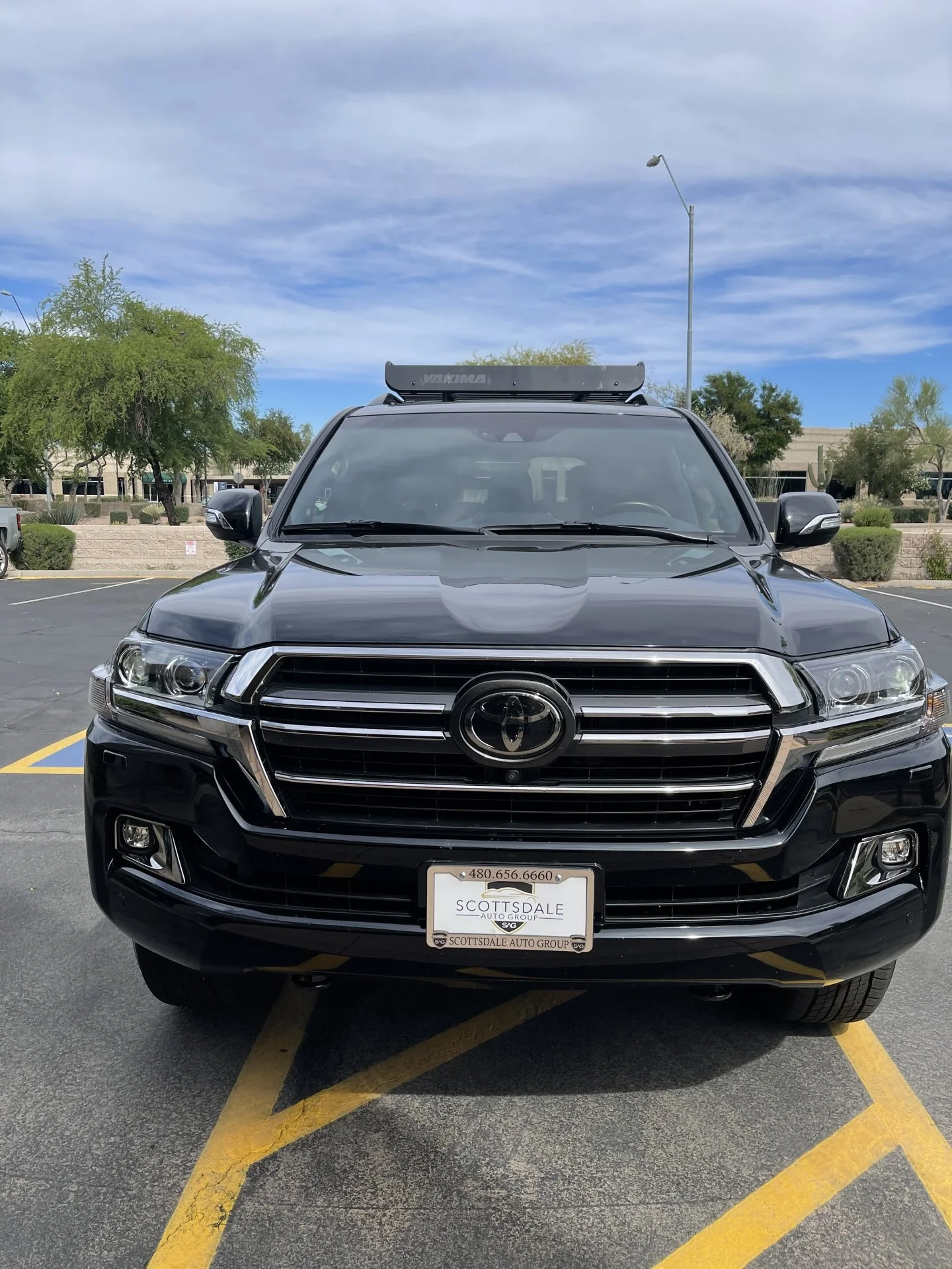

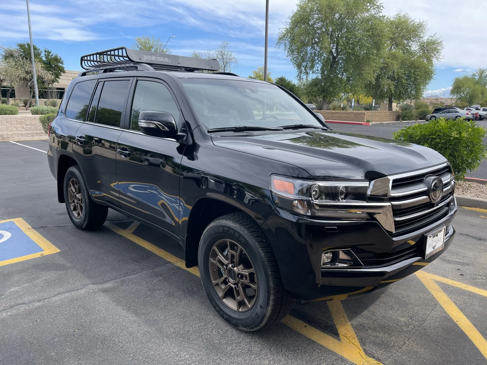

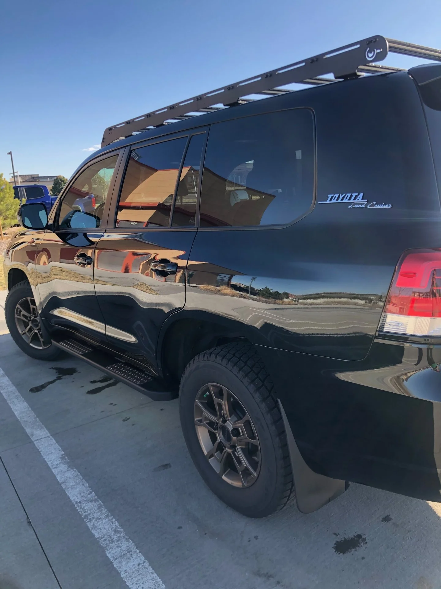

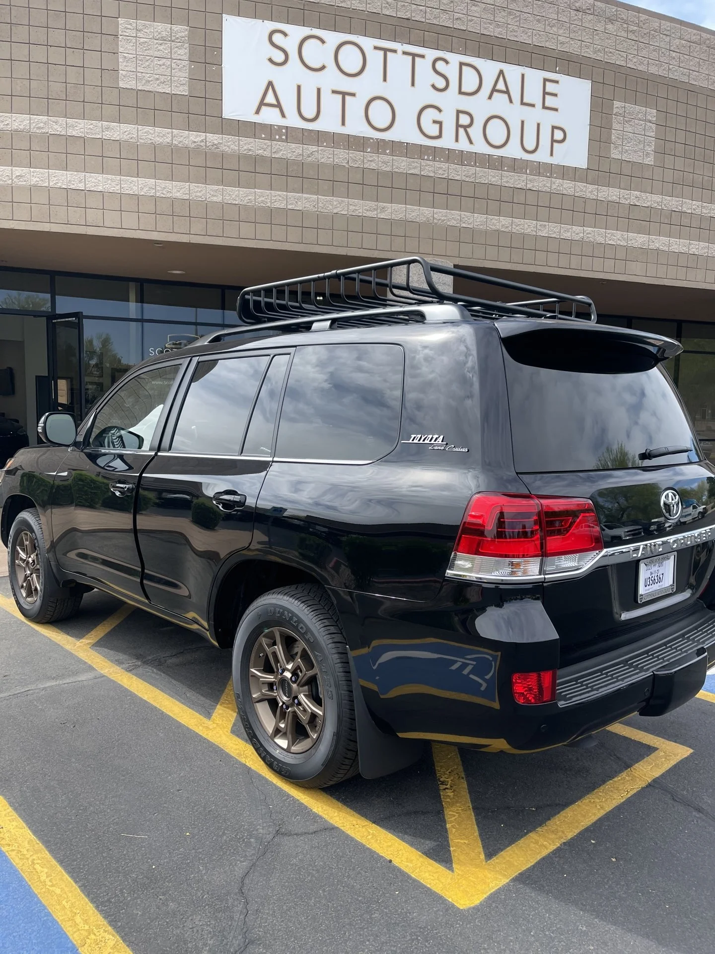

Here's my Black/Black 2020 HE which Eric Sarjeant did. Prinsu Rack, Slee Sliders with powder coated inserts to match the HE Wheels, and chrome delete painted black. Happy all around. Wish I would've done LRA Fuel Tank and on board ARB air compressor. Will probably add those. Definitely check out Eric Sarjeant's stuff on FB.
