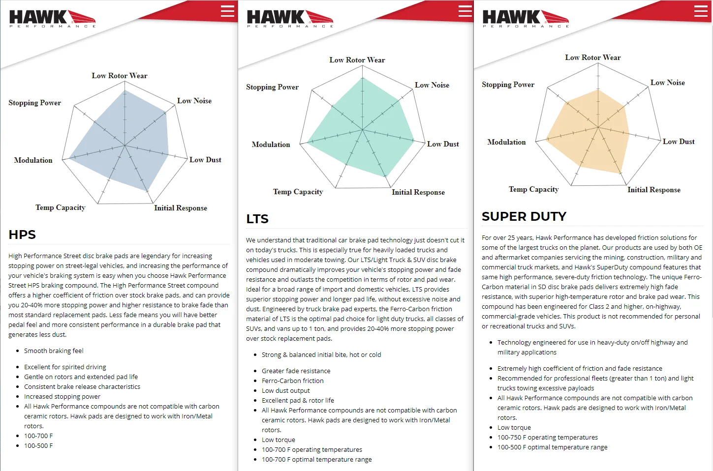

Not positive afgman, here's a comparison of the different Hawk brake types, including LTS and SD:

I've used Hawk pads extensively in my sports cars and enjoy their products. Good pricing and easy to source (Amazon). For the LX, I personally use the HPS pad as it strikes a great balance of street qualities including cold braking friction, reasonable wear on rotors, and excellent hot friction and headroom. The increased friction coefficient brings back the brake torque lost with larger 33" tires. I've used it towing my 7700lb trailer in the mountains, solid stable braking performance all around with more confidence once things heated up. It is a bit more grabby than the stock brakes as expected with low speed off-roading stuff. Does occasionally make some noise at low parking lot speeds which doesn't bother me in the least. Does dust probably 50% more than stock pads.
I use the exact same compound on my Porsche 911 Turbo, but as a downgraded better street pad, as I found the stock pads to want more heat before they got into their element.
The LTS and Super Duty pads are both more aggressive than the HPS pads, with increased rotor wear, noise, and dust. Rotors are cheap though so if one is maybe on 35s, may want something like the Super Duty pads to bring back brake torque. If I were to do 35s, I'd still probably keep the HPS, or step into the LTS pads rather than the SuperDuty, as it seems to have more significant compromises, including modulation.
